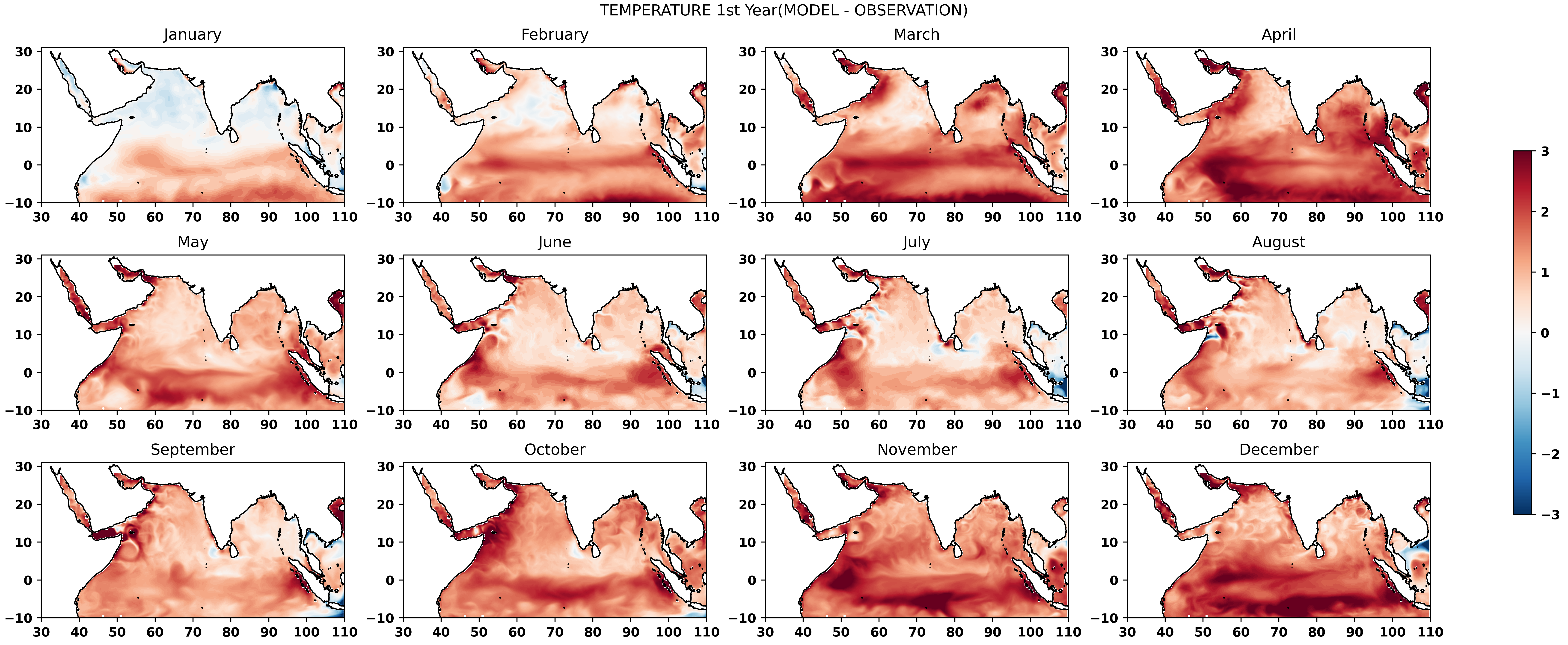

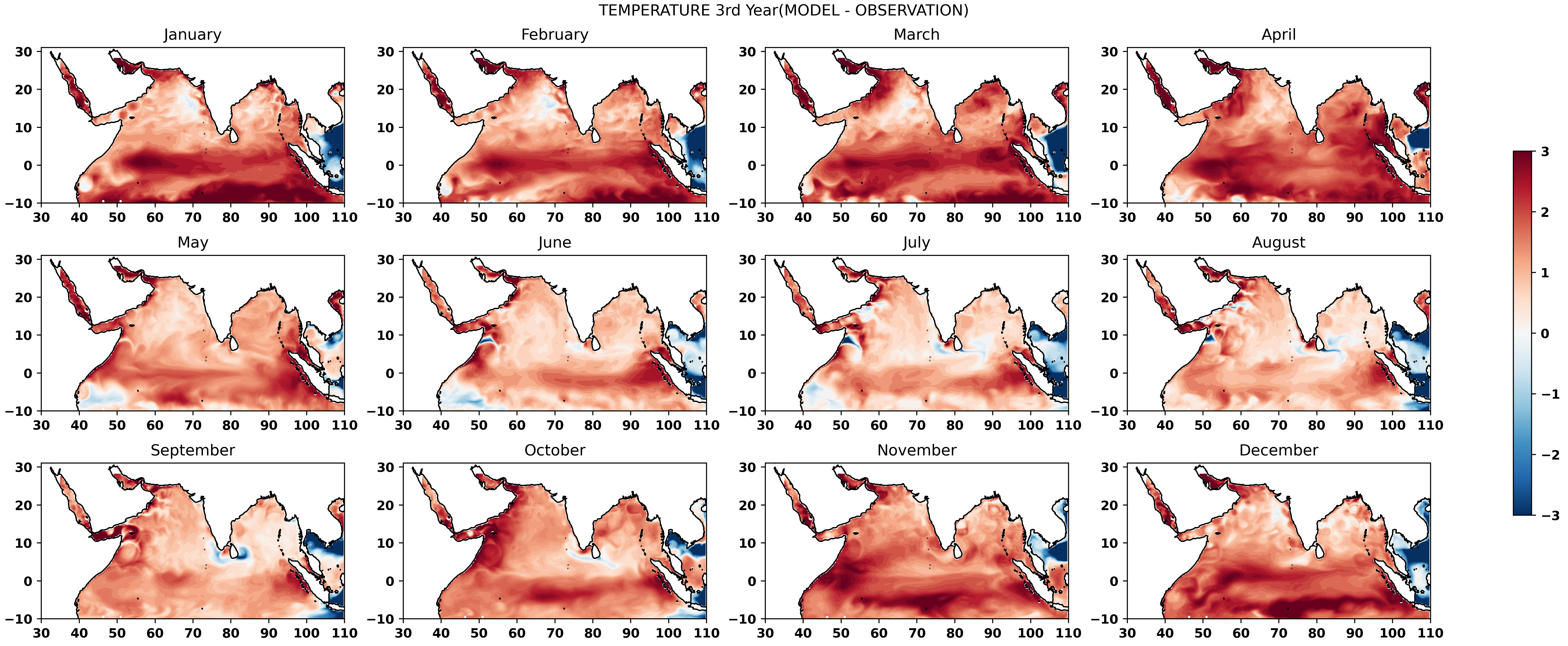

Hello everyone. I am setting up the roms model for the Indian Ocean region using climatology files. I have given initial and boundary files from World Ocean Atlas 18. The atmospheric forcing file is from IMDAA and Scatscat (for wind). When I am spinning up the model, the biases grow with time. For example, the SST bias is 2deg C at the end of the first year, but it becomes 4deg C at the end of the 10th year. I am changing the mixing scheme and viscosity value, but nothing works. Part of the .h file is added here. I am looking forward if someone can help me out here. Please let me know of any further details. The resolution of my model is 0.16deg with 40 vertical levels.

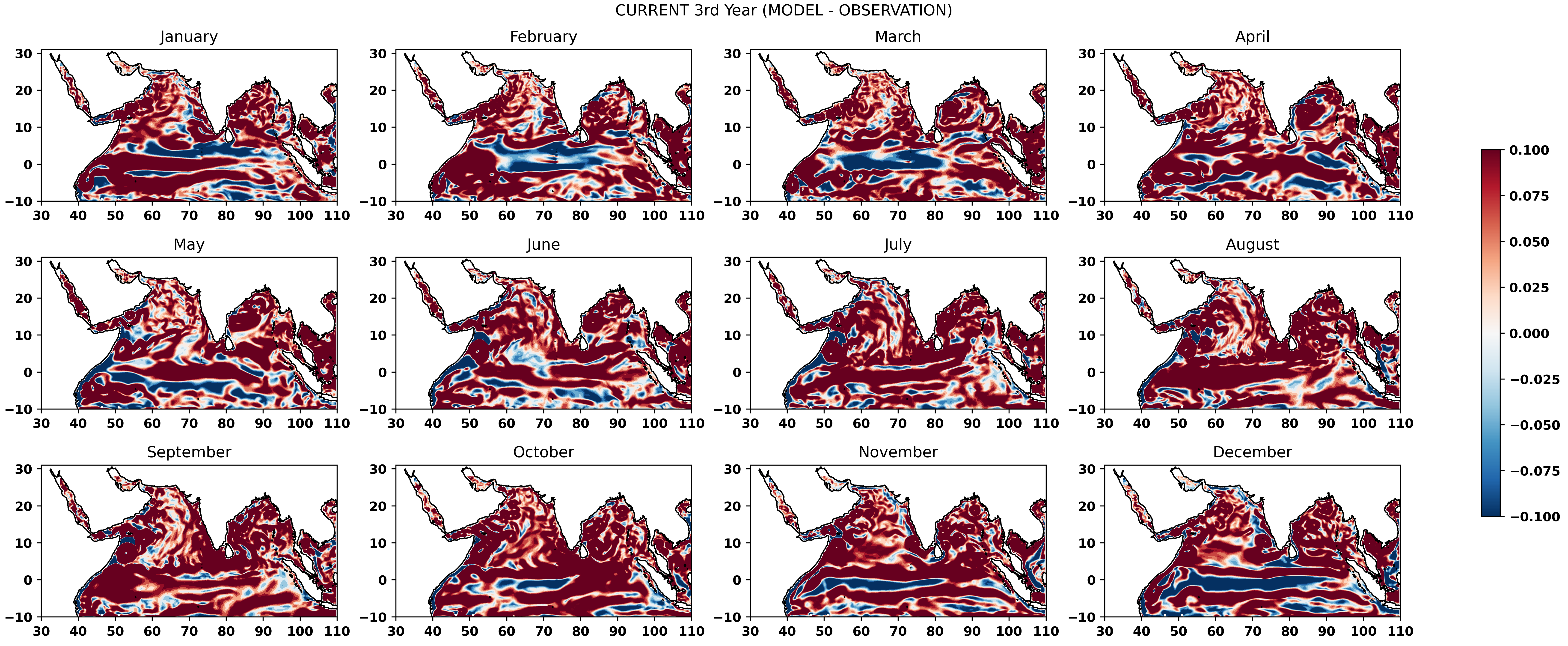

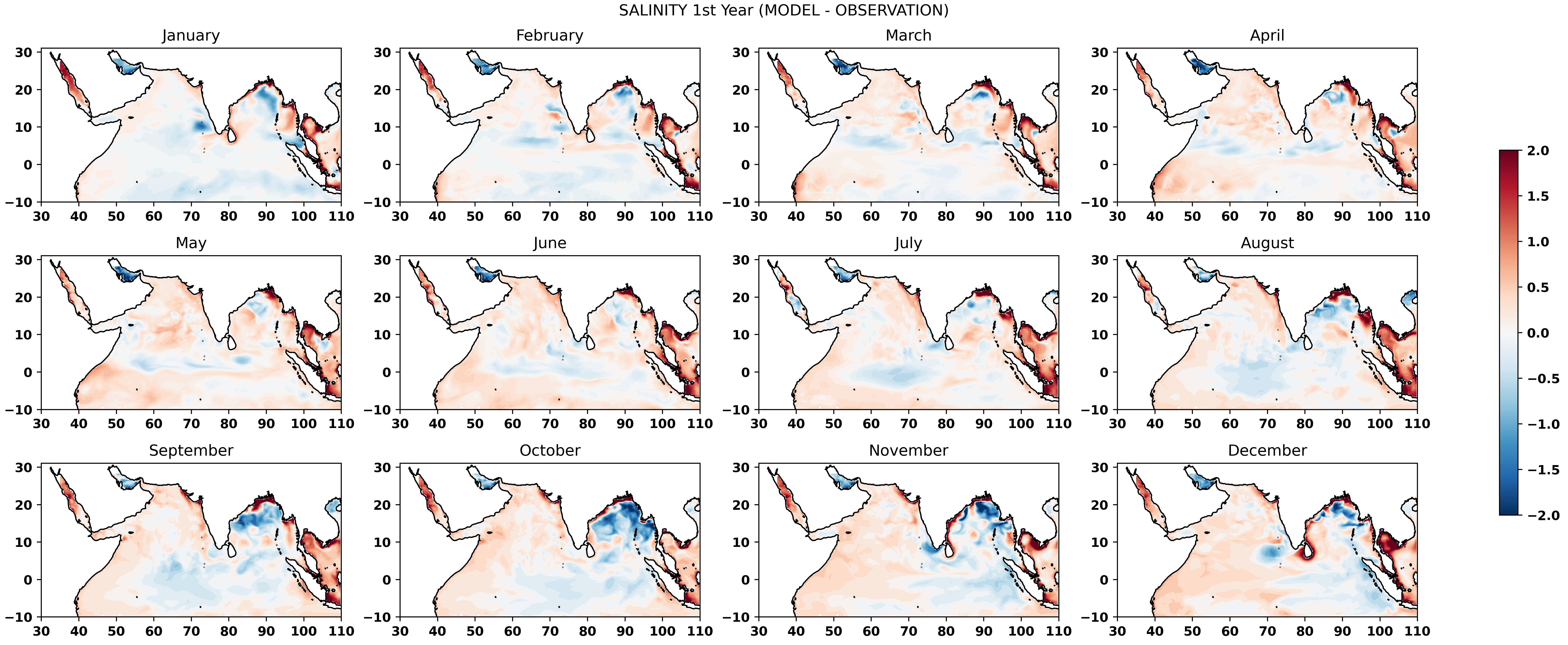

Besides temperature, biases are also growing in the salinity and at the current speed. For salinity, I used SCORRECTION and changed the mixing schemes as well as the viscosity value, but nothing worked.
For reference here, I am attaching the 1st year and 3rd year run biases (although the model is not stable but for reference, I am attaching the 3rd year run images).
