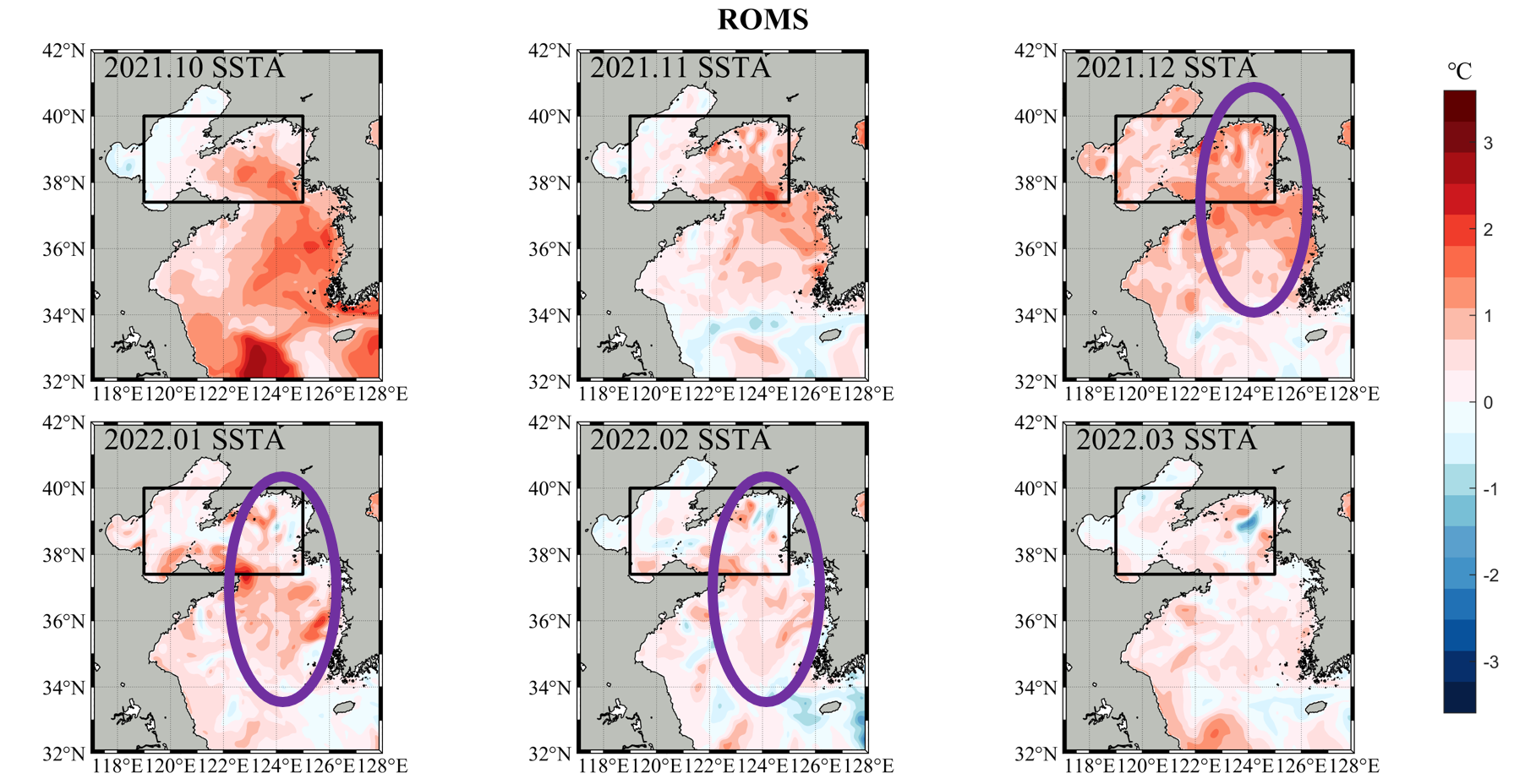

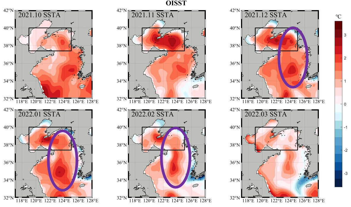

I am new to numerical modeling, and I want to research the temperature anomaly in the Bohai Sea and Yellow Sea. First of all, I compare the model results with OISST. The anomaly was computed by subtracting monthly climatological temperature from real-time monthly temperature, and the climatological baseline is 1994.01-2021.12.
Attachments are the ssta of OISST and ROMS, respectively. (I don't know how to add the pictures on this board directly, sorry... :( )
We can find that the ssta of OISST from 2021.11 to 2022.02 is relatively high, which extend to the whole Bohai Sea and Yellow Sea. The purple oval is the domain of Yellow Sea Warm Current, which show significant warming.
And the ssta of ROMS is also high, but the spatial distribution characteristics are very poor and chaotic. The domain of purple oval doesn't represent the clear warming, and means that it couldn't show the YSWC's characteristic. And the ssta around Jeju Island is also poor.

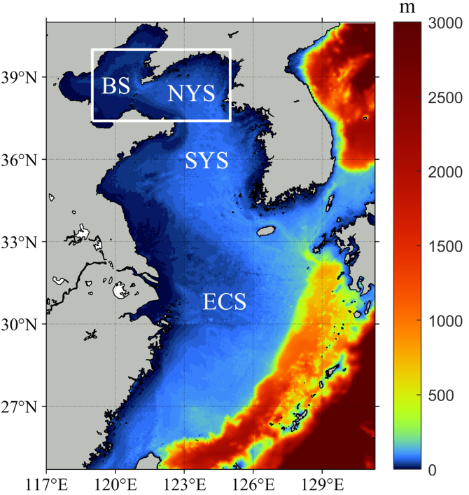

The third attachment is my grid, which includes the whole East China Sea. The bathymetry is from GEBCO2020.

grid
grid
ssta of roms
ssta of roms
ssta of oisst
ssta of oisst
