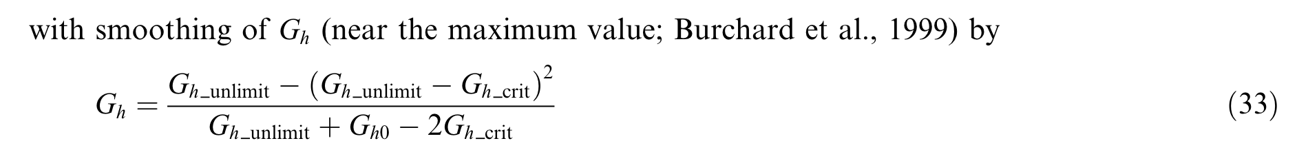

Hello, it appears there may be a small coding error in the gls_corstep.F file. I recently read the paper by Warner published in Ocean Modelling in 2005, the code provides more details. However, I noticed a discrepancy in line 1011 where the computation of Gh differs slightly from the formulation presented in Equation (33) of the paper.
The formulation for Equation (33) is provided as a figure attached below.
the origin code:
            Gh=MIN(Gh,Gh-(Gh-gls_Ghcri)**2/                             &
     &                    (Gh+gls_Gh0-2.0_r8*gls_Ghcri))
In the code, it is necessary to add a parenthesis in the numerator, the code may be change to:
            Gh=MIN(Gh,(Gh-(Gh-gls_Ghcri)**2)/                             &
Warner, J. C., et al. (2005). "Performance of four turbulence closure models implemented using a generic length scale method." Ocean Modelling 8(1): 81-113.
Posts: 1222
Re: Possible Coding Error in gls_corstep.F: application of gls_Kmin and gls_Pmin to control advection
#6 Unread post by jcwarner »
sorry for the long wait before a reply.
The code is correct, but i had a misprint in the paper.
please see
viewtopic.php?p=19637#p19637
