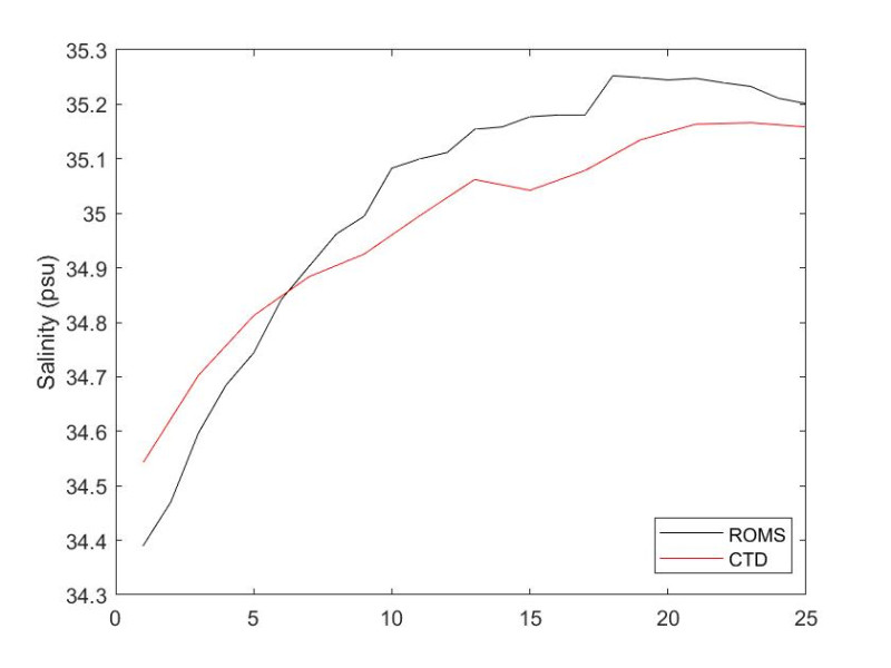

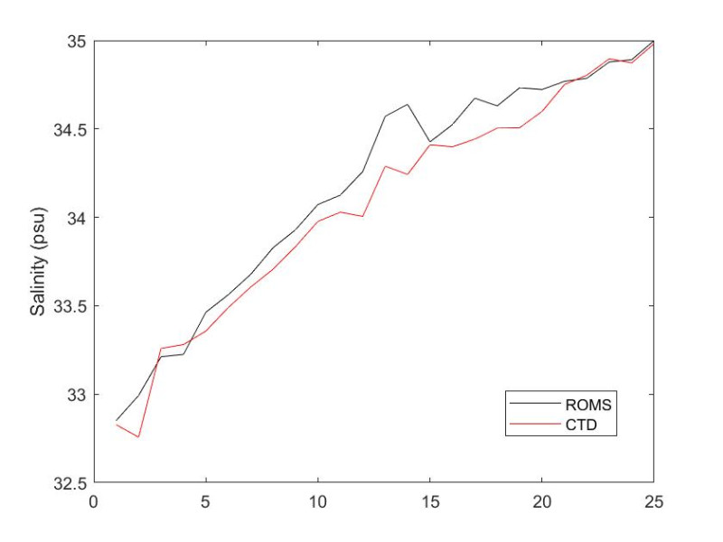

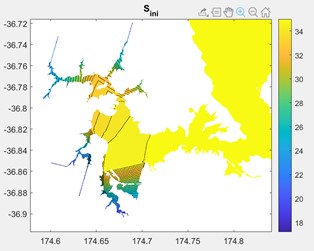

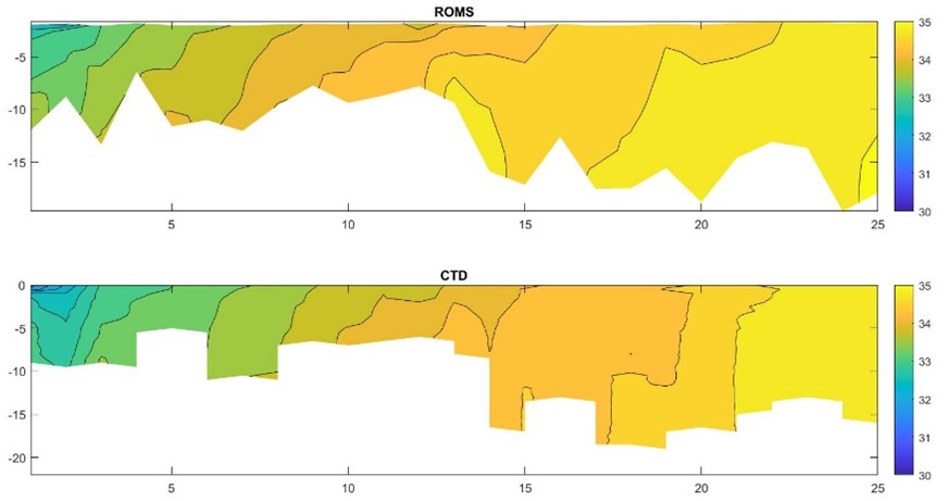

ii. Initial Salinity These creeks are small and not very accessible to surveys, so we don’t really know where the salinity actually drops to zero; based on publications and our experiences, we see salinity around 25ish even at the upstream limit our boat could get to (which is also the landward limit of nautical charts). The river_salt variable in the river forcing file starts with these non-zero values and then it is gradually ramped down to zero over 24 hours.
The model boundary is far away form this region of interest, where a gradient boundary condition is used for tracers. Temperature is held almost constant (no atmospheric fluxes, river water temperature set to be the same as the initial temperature, etc.).

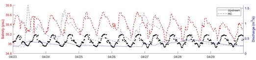

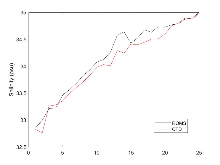

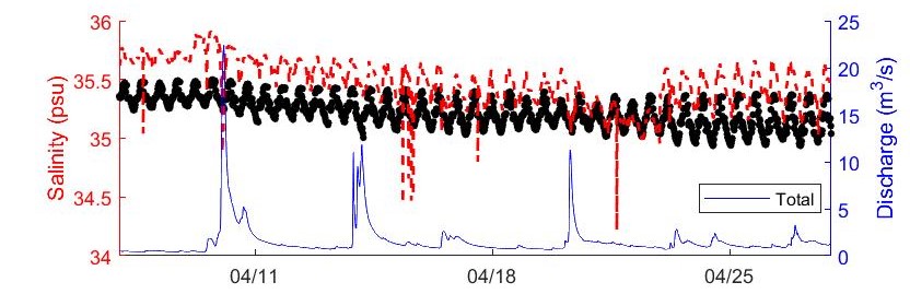

iii. Model validation at an upstream location, Hobsonville (black dots are the modelled; red curve is the measurement). Systematic overestimate.

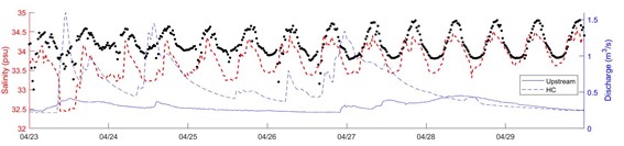

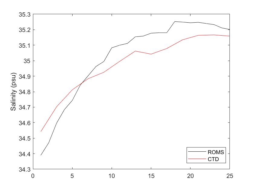

iv. Model validation at a downstream location, Stanley Bay Underestimate of downstream salinity. However, the model may have captured the timing and the amplitude of the fluctuations, since the de-meaned versions compare well (see below; where some very low measured values and the linear downward trend of the red curve might be due to biofouling of our CTD; after 30th/Apr, the measured numbers at SB become very low and appear funny so they are not used for model validation): v. Modelled along-stream transect (Spring Tide) The modelled salt intrusion length appears to be longer, and the modelled stratification is higher. The along-stream depth-averaged salinity is also shown below, where an underestimate of salinity gradient can be noticed.

some quick looks:

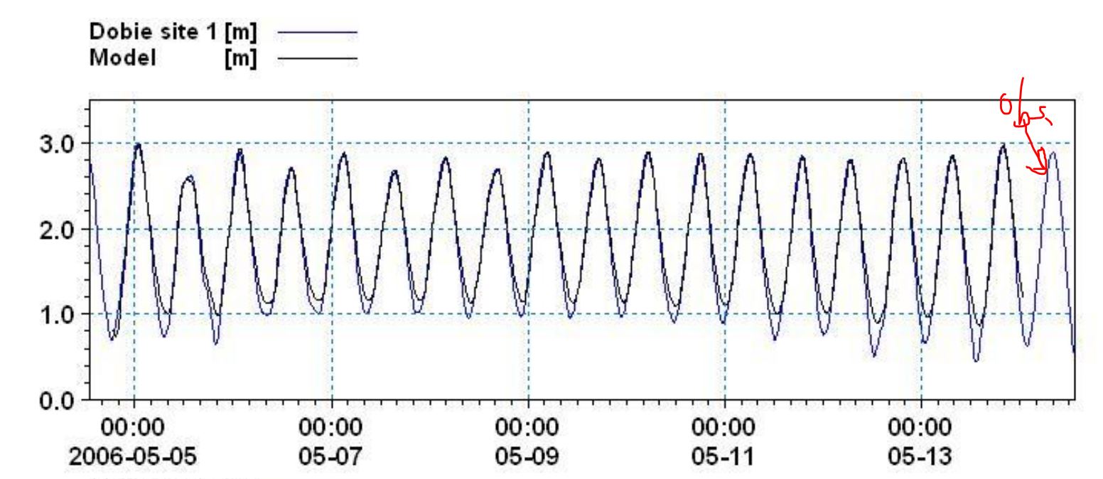

-how long did you run this for? looks like the salt is getting better as time goes on.

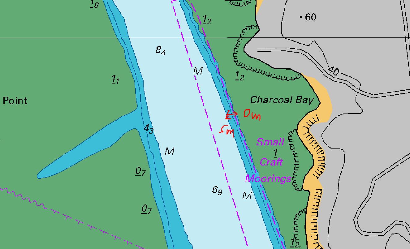

-in the attached ppt, the vel in Charcoal bay does not get as strong (peaky) as the observations. So the salt will not get advected as far at those peaks, and that is exactly what you see in the salt time series.
- how well are the tides (water levels) simulated?
The model was run for 50 days in total. The validation shown here covers the period of Day 34 to 39, 6 days in total. The CTD was cleaned on Day 34, so the measurement over this period of time is of very high quality. Usually we do bi-weekly cleaning, yet somehow the biofouling during that month was happening at a very high rate, so from Day 40 onwards, the downstream measurements were hardly usable, and the upstream measurements also appeared a bit fishy, so we decided to not use them and this makes it harder to know if the results really do get better as the simulation runs for longer. Based on the along-stream transect comparison for the Neap tide (Day 46 of the model), which overestimates along-stream gradient with a relative error similar to that shown in this post, I think this improvement might not be very likely.
We have been battling this problem for a long time. For the spring tide condition (the last two days of the validation period), the maximum ebbing flow at CB is as high as 0.9 m/s while the maximum flood there only reaches 0.6 m/s. The underestimate is more severe for the ebb. In the model, the maximum ebb can only reach around 0.65 m/s, and the flood is underestimated at 0.45 m/s for the spring tide condition. We have tried various ways to fix this: using different Zob, using Zob that is lower on shoals, improving bathymetry interpolation there, nothing worked. The bathymetry there is very steep, having a gradient of about 3 in 100, with a scarp that drops 4 to 5 meters in about 100 meters (a nautical chart is attached). - how well are the tides (water levels) simulated?

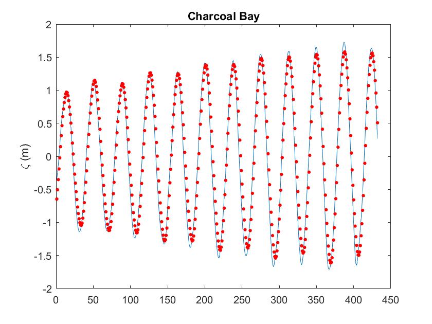

Much better than the velocity, so I did not attach figures. At SB and CB, when comparing the modelled zeta at Charcoal Bay against the measured pressure, the NSE can be as high as around 0.94, and the maximum relative error is less than 10% Kind regards,

i think you need more Volume to be filled on the flood, and then this will allow increased flows on the ebb.
I was hoping to see more overtides in that water level time series (ie quicker rise to peak water level and longer tail to lower water level). do you see that further into the estuary?
i see you said something about wet/dry giving you problems. should more of the gridded area be allowed to get inundated?

Thanks for the advice. My reasoning is that the zeta at CB and SB suggests here could be a 5 to 10% underestimate of the tidal volume (assuming the bathymetry is correct) ; however, the bathymetry has always been a headache; for example, the nautical chart is not up-to-date for the upstream regions (some measurements were taken back in 60s; afterwards there have been some dredging and natural deposition about which we do not know much about). The bathymetry itself can a source of volume uncertainty. So we replaced the chart with recent LiDAR data wherever possible (many upstream creeks were not measured) and this slightly improved results; yet we are still not sure how well tidal flats are represented in the model, if the inundation is well captured or not.
What we have done now is that we set zeta=0 at the High High Water mark, so grids below it are marked as water and everything in between it and the lowest-astronomical-tide level can undergo wetting and drying.
The overtides are not obvious (we do not see large tidal asymmetry in zeta); many examples covering the whole area can be found in this council report (pages 22 to 24) http://www.aucklandcity.govt.nz/council ... 008037.pdf; the most relevant example there is attached below, at a location a bit upstream of our CB site. Many thanks for the prompt reply,

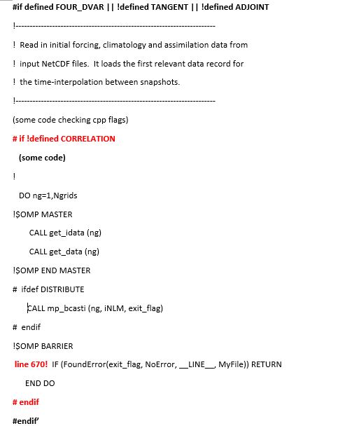

I was taking a brief break and now I'm back at the model. I was running into a weird problem with adding passive tracers to the model; although I have found a work-around, yet I have no idea why things were going that way. The log file (unfortunately, the version storing the error message has been overwritten, though I have located the code causing trouble and can replicate the error message as shown below) said that:
--- InqVar of the netcdf library cannot locate a variable in my nc file storing swflux (surface water flux, E-P) ; however, the name of this variable was shown as a blank
in other words, the model was trying to access a "nameless" stuff in a forcing file...
--- the call stack can be traced back to line 670 of initial.h. I looked at it, and the code structure (see figure below; my header file is also attached) there can be summarised as
1. the model checks if 4d-var has been defined, or otherwise, whether either TLM or ADJOINT is not defined. If any of the above is satisfied, the following code will be executed. In my case, I don't
have 4d-var and neither TLM nor ADJ is defined;
2. so, the model executes the code up to line 670 (because #if !defined CORRELATION is satisfied in my case), where it throws an error (as described above, the model tries to find a "nameless" stuff in my file!). I have switched on ana_spflux and ana_bpflux, so I reckon the model is trying to find a 4d-var related variable in my input, yet definitely I do not have it there! I can't quite figure out why here is an error involving a "nameless" variable. Should we change #if !defined CORRELATION to #if (!defined CORRELATION && something) ?
3. So I have tweaked the code a bit to let it bypass this part (since the code comment says that the code causing my trouble "is essential in iterative algorithms"; although it does not say it is not essential in other applications, I have assumed so...). Then the code runs without throwing any error.
Furthermore, is here a way to analytically give swflux in the model? I have not found an ana flag to do this, though. I know that rainfall and evaporation can be analytically computed using bulk_flux, yet which seems to be an overkill if I just want to use zero swflux at this stage (and creating a swflux variable that is uniformly zero is also a bit inconvenient).
Any help will be appreciated. Thanks in advance.

Re: How to improve modelled salinity and salinity initial condition
The question here is why ROMS is looking for 'swflux' at all when you have ANA_STFLUX, which should set the surface salinity/freshwater flux in ana_flux.h.
You might have some conflicting or contradicting CPP defs.
Rather than look at the .F code as you were, go into the build directory and look at the .f90. Then all the CPP defs have been applied and you may find code active that you did not expect. Then trace back to see which CPP options led to that that you did not intend.
I notice you have CPP directives for advection scheme options (MPDATA etc.) which means you have a rather old version of the code. This might be a good time to update since we have made some changes to the I/O processing of netcdf files (introducing varinfo.yaml instead of varinfo.dat) so going forward it becomes difficult to offer help when you are working with a version we aren't using anymore.

--- InqVar of the netcdf library cannot locate a variable in my nc file storing swflux (surface water flux, E-P) ; however, the name of this variable was shown as a blankin other words, the model was trying to access a "nameless" stuff in a forcing file...

An update:
1. Now we are happy with our model results. The reason it didn't work was due to some (silly) mistake on my part. We were using a synthesised initial field based on some VERY OLD references (1986ish) and three or four transects measured over the past few years. They provided a good starting point, and we used them to test if the grid quality was good enough to tolerate some high discharge rate. Then, when we ended these tests and switched to using the actual data from year 2021, I simply forgot that it was an exceptionally dry year
and the salinity near the eastern boundary of Waitemata could be as high as 35.7 in late March. We do have a long term CTD installed there measuring surface salinity, yet in late March biofouling had made the data not so usable. HYCOM data don't really cover theses smaller bays. In the end, we re-designed the initial field based on HYCOM data in the outside ocean and some reliable measurements inside the harbour.
2. Here was a dry-wet transition during late March and early May; rainfall and evaporation balance throughout the model domain played a very big role in it. Combining ERA5 data with some local meteorological gauges further improved our results.
Figure 1. Upstream Surface Salinity (Hobsonville) (black dots: model, red curve: CTD)
Figure 2. Downstream Surface Salinity (Stanley Bay)
Here is still some underestimation in both value and magnitude of variation, yet we are OK with this --- could be due to the relatively short ramp-up period and inherent errors in our very simplified initial and boundary data.
Figure 3. Depth-averaged Along-stream Salinity Transect (spring tide) Figure 4. Depth-averaged Along-stream Salinity Transect (neap tide) Not so good... but given the data we have and the model complexity we would like to accept at this stage, I reckon it is still fine.

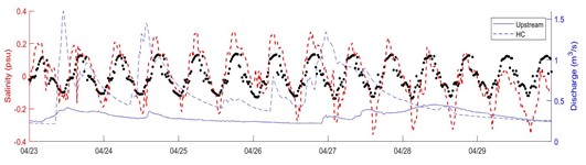

3. Remaining issues: the model consistently predict higher level of stratification throughout the system. Neglected wave mixing/boat wakes, errors in field measurements themselves, etc., all these could be contributing factors.
