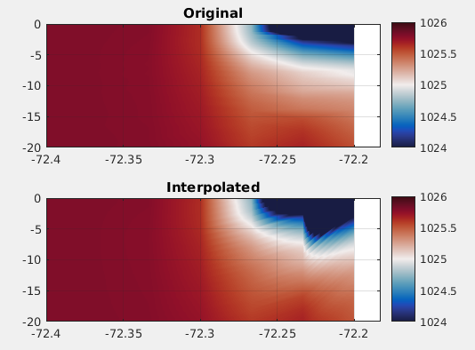

I'm working with an output from a ROMS model. I have the sigma levels (32) and some physical magnitudes as temperature and salinity. I have already converted sigma levels to depth.
I'm trying to interpolate the data in the vertical to a finer grid. I have the data order as (vertical_data,longitude_location) and I'm using a linear interpolation over one column at the time. However, the result is not good since the gradient of the field it's modified by my method. I have attached a image to show what I mean. So my question is, is there any "recommended" technique to interpolate in the vertical?
Thanks in advance.

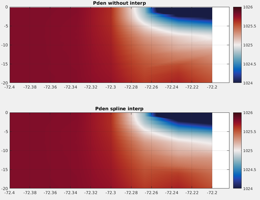

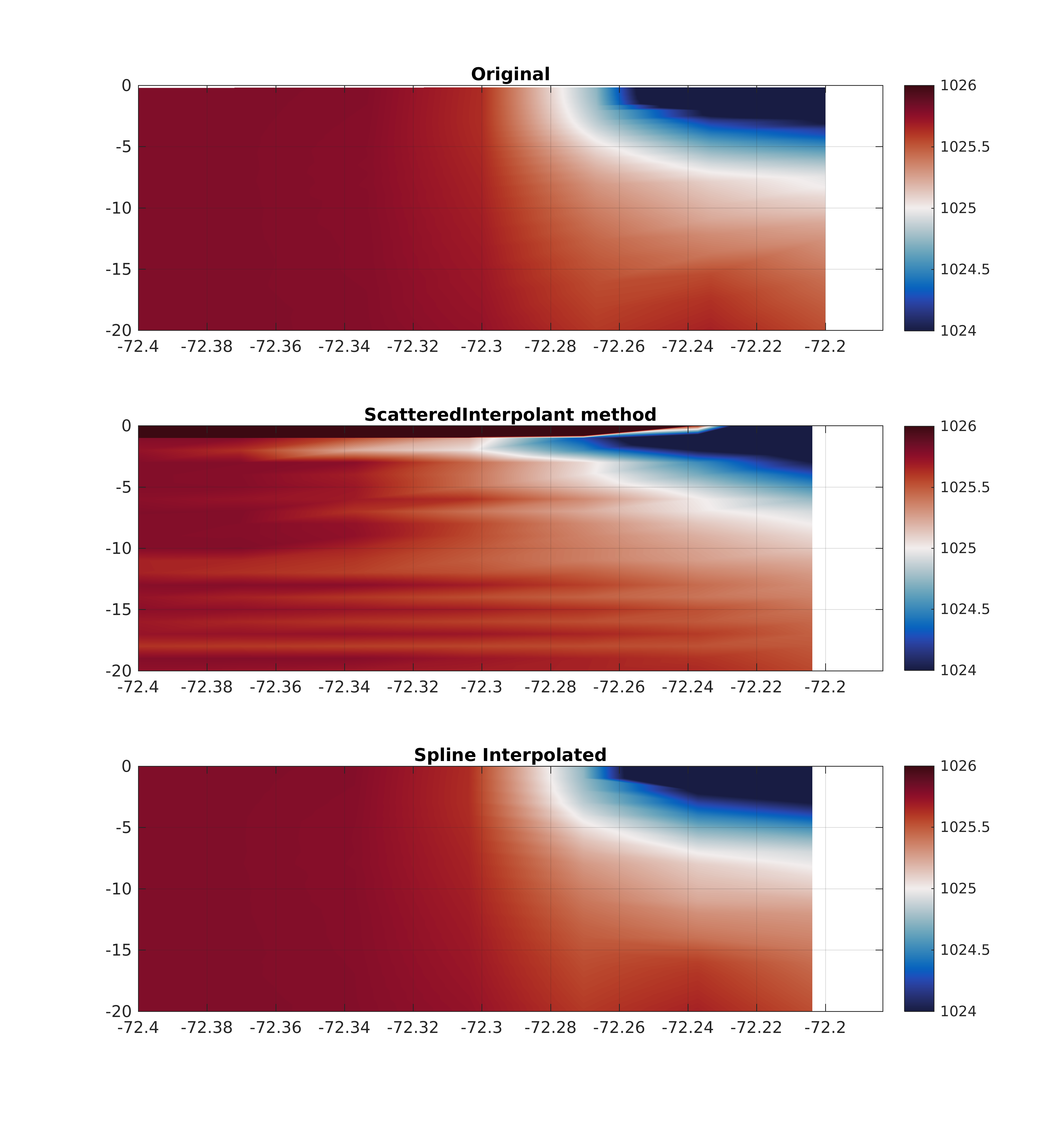

Re: ROMS output. Best technique to interpolate in the vertical
I had a hard time understanding your answer. But now I get it, thanks for your help!!!!
However, the results are not looking so good.
Looking information about scatteredinterpolant, I find the spline interpolation. And apparently, the results are better than any other methods I have tried so far. Still, I notice that both interpolation's method doesn't reach the right edge (See the longitude -72.2). Is this normal?
Thanks in advance.
Thanks in advance.
looking better.
there are 'extrapolation' options, which need to be used with caution.
but give that a try.
I'll keep looking. But for now, I have a better interpolation than before. If I find a way to extrapolate in a nice way, I'll post it here.
So much thanks you for your help.
So the problem with the right edge was not due to interpolation problem but a wrong definition on the finer grid I make.
