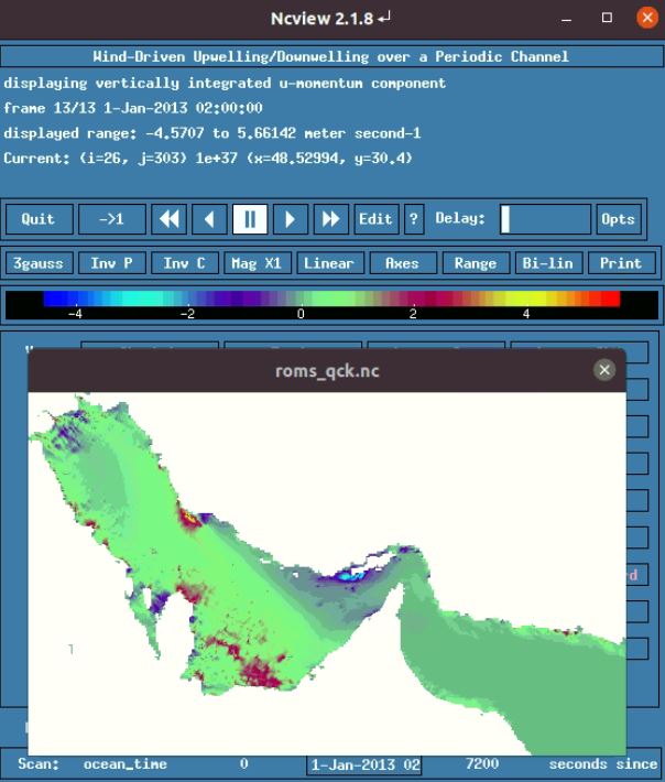

- Posts: 43
- Joined: Tue Feb 11, 2020 6:03 pm
- Location: IUST
Re: ERA5_wind_problem
Dear wilkin,
Thank you for sharing your experiences.
As you said, I changed the settings, except that I have not yet set the salinity and temperature to the boundary. When I increased the visc2, I still did not see any noticeable changes and there are still MaxDensity and MaxSpeed errors in the northwest part of the domain. By changing the header and input many times, I get an error again in the same part.
modified_grid.log
- (179.24 KiB) Downloaded 883 times
- error (2).JPG (71.57 KiB) Viewed 24358 times

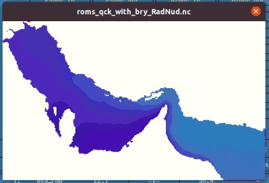

- Posts: 43
- Location: IUST
Hi Wilkin,
As you said, I use Rad for u and v, and RadNud for the free surface(but my nudging time scale is zero). Although the boundary file is read,
it does not affect anything inside the domain. It is as if the edge of the border is stuck(It is visible in 2D mode) and does not allow it to be applied properly inside the domain. In another case, I considered the Cha for free surface and Rad for u and v, in which the boundary file was not recognized in the output.
As I read in this forum, several modes may be considered for OBC and all of them are correct.
My question is how do I select OBC to read my boundary file correctly?
