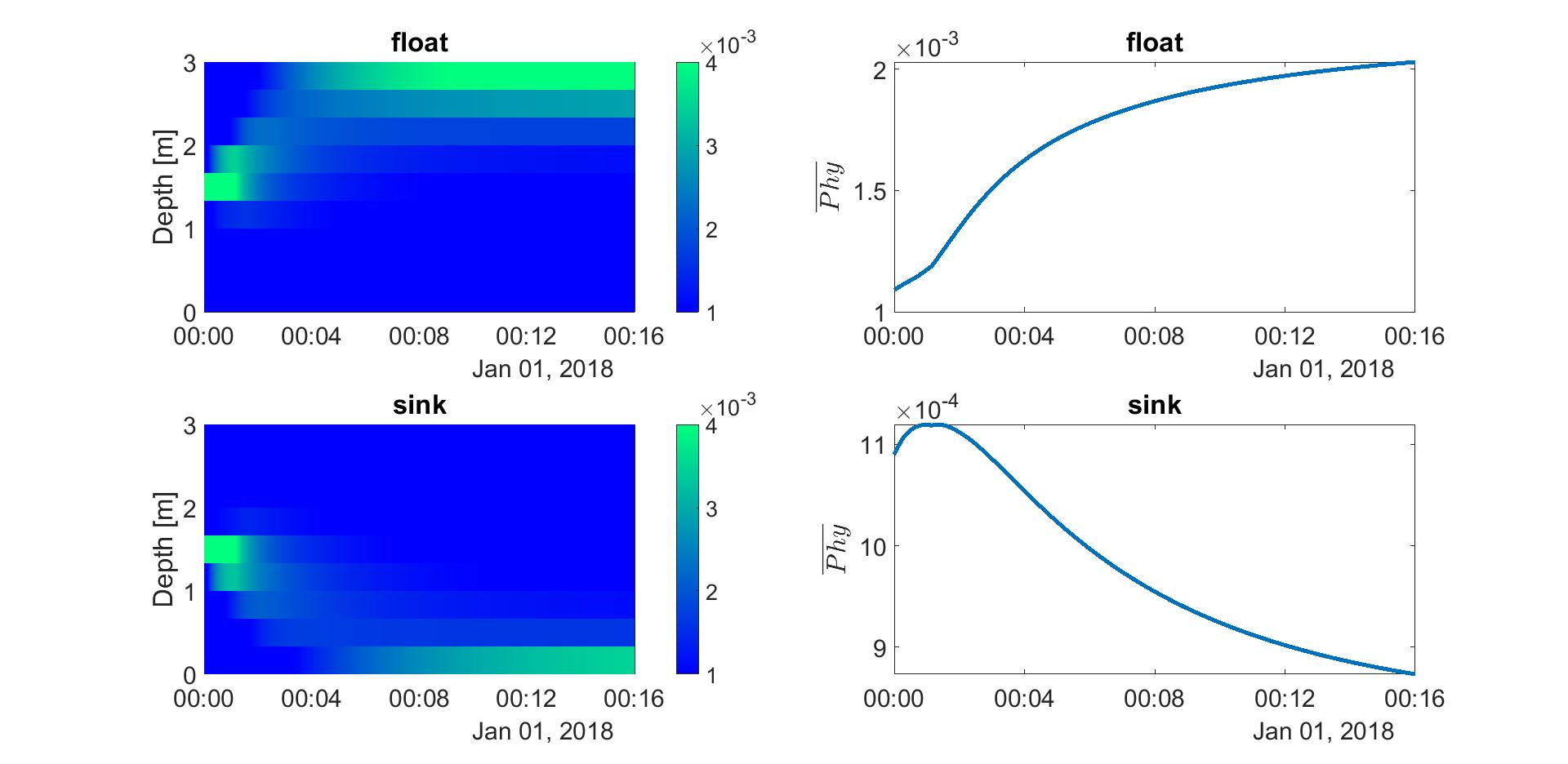

I found that I had some success with this. I attach two results, one for constant sinking and one for constant floating. For these simulations, I turn off physics and biological source/sink terms - so my plankton are passive other than vertical movement.
The problem I have now is with the boundary conditions. When they hit the bottom, the total concentration over the volume (right figure) decreases and when they hit the top, it increases. I would like my plankton to be able to sink out of the system into the sediment but not leave through the surface.
So my question is, how should I apply the no flux boundary condition at the surface?
Thanks for your help as always!
Best wishes,
Ash
