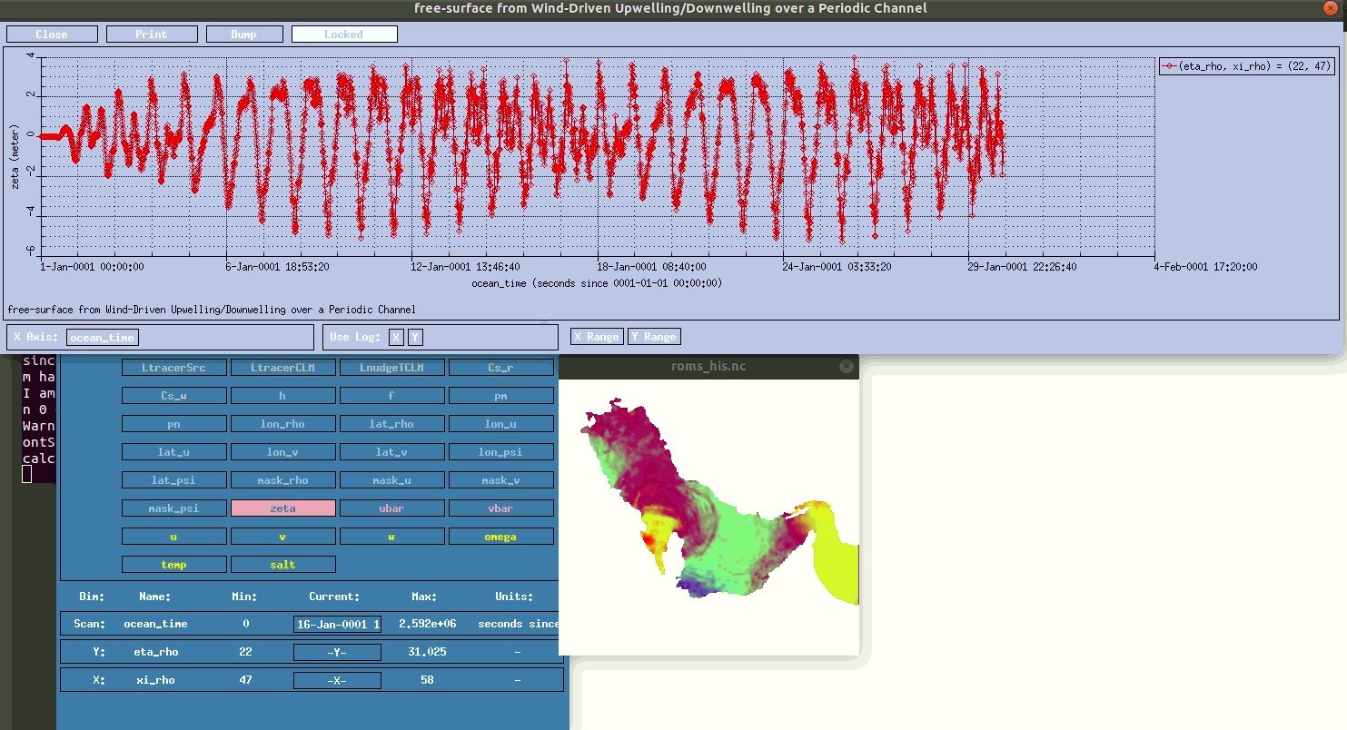

I want to calibrate the tide and the domain is in the Persian Gulf

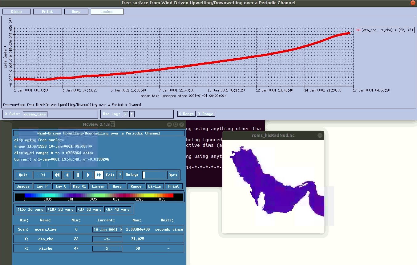

I've used many lateral condition parameters but none of them help me to calibrate the model as I want(the result of Fla is too large as you can see in the picture below and when I use NudRad, the fluctuation vary by centimeters.)

I didn't find a way to calibrate the zeta parameters and the bottom drag didn't help me too. what was your idea as you said about this problem?
