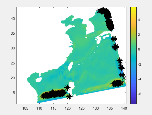

I'm modeling the ocean along the china coastline. I planned to run ROMS for 3 months, but the ROMS failed after about 15 days and I don't know how to deal with this error. Could anyone give me some ideas about it?
The lateral boundary conditions I used:
LBC(isFsur) == Clo Cha Cha Clo ! free-surface
LBC(isUbar) == Clo Fla Fla Clo ! 2D U-momentum
LBC(isVbar) == Clo Fla Fla Clo ! 2D V-momentum
LBC(isUvel) == Clo Cla Cla Clo ! 3D U-momentum
LBC(isVvel) == Clo Cla Cla Clo ! 3D V-momentum
LBC(isMtke) == Clo Gra Gra Clo ! mixing TKE
LBC(isTvar) == Clo Cla Cla Clo \
Clo Cla Cla Clo
The error result of ROMS 'U' is shown below.
Other details showed in tws.in and tws.h files are also attached.
Any idea/hint will be very helpful!
