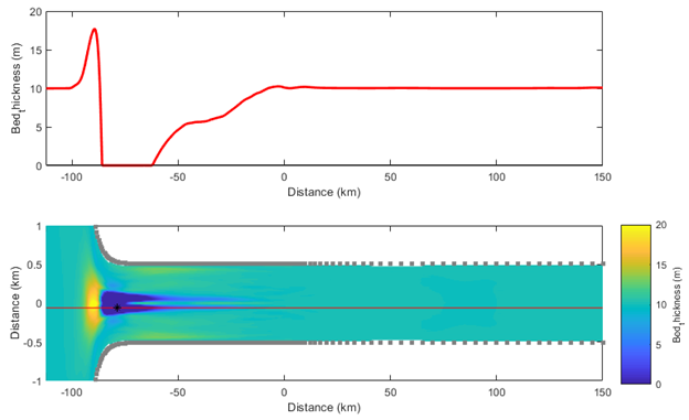

Hi, I recently ran a 2 year simulation of an idealized estuary with the sediment module activated but not SED_MORPH.
The bed was initialized as 10 m thick. It showed scour at the mouth with deposition on the flats and also a mouth bar deposit.
Looking at the data, I think the flow was not coupled to the bathymetry. Otherwise the currents would have slowed in the scour hole.
Also the mouth bar would have actually breached the surface, as the depth is nominally 10 m.
