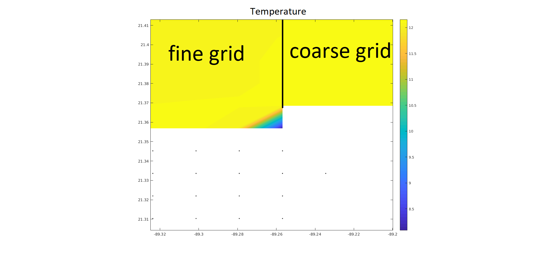

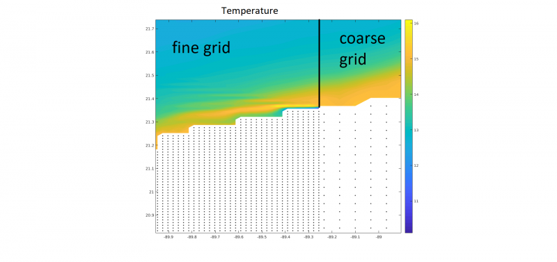

The second problem related to nesting is that I noticed that the temperature interpolation of the nested grid boundary cell in contact with the shore is not correct as can be seen in Figure 1. The bathymetry in this case is flat and the water temperature is uniform for the entire water column. The error is difficult to notice, but with a constant flow along the coast, it can produce a deceptive inflow of cold water, as can be seen in Figure 2.

I think those temperature plots (from the initial conditions?) might be an artifact of shading interp.

The temperature graphs are from the first steps of the calculation and the initial conditions are analytical, where the temperature is uniform.
