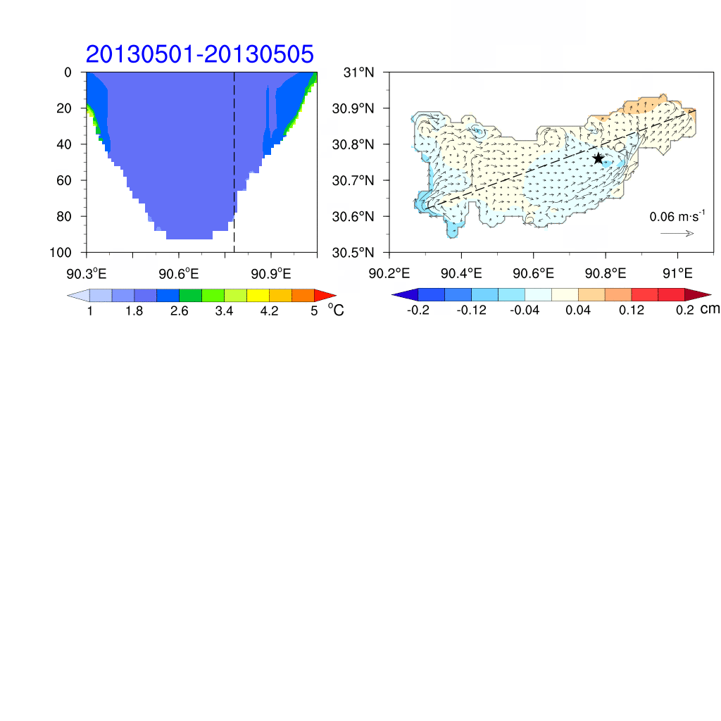

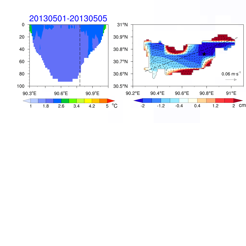

I'm recently studying the kshedstrom version <https://github.com/kshedstrom/roms/tree/master>, and trying to apply it on a freshwater lake.
I plot the evolutions of the 5-day averaged depth-averaged currents <ubar, vbar, vector>, free surface elevation <zeta, contour>, and water temperature along a southwest-northeast transection <indicated by the dashed line in the right panel>.
However, the spatiotemperal variations of the zeta seem quite weird during the whole simulation periods <20130501-20131231>, and I haven't figure it out.
Following the the animation.
Hope to get some help with this problem. Great thanks!

Are the red areas elevated land, as in for wetting and drying? I too would have expected the currents to be more closely related to the ssh contours - it looks like they align right at the end?

The red and wet contours in the right panel both denote the free-surface variations <zeta> in the whole simulation area.

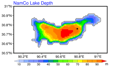

The following is my model domain and Lake Nam Co depth.
model domain and lake depth.png (36.14 KiB) Viewed 6230 times
In winter, the currents mainly flow in response to the strong surface winds, which mainly directs eastward during winter.
I also utilized POM <Princeton Ocean Model> to simulate the lake thermohydrodynamics. The depth-averaged currents seem organized and match well with the free-surface elevation gradients. For now, I can't understand why the free-surface elevation modeled by ROMS is much bigger, almost 10 times larger than that in POM, and seems weird with little variations.
The following is the POM simulated animation of the 5-day averaged depth-averaged currents <ubar, vbar, vector>, free surface elevation <zeta, contour>, and water temperature along a southwest-northeast transection <indicated by the dashed line in the right panel>.
Work_NamCo_POM_T_UV_LWL_CrossSection_Animation_5dAvg_DepthAvgCurrents_20130501-20131231.gif
