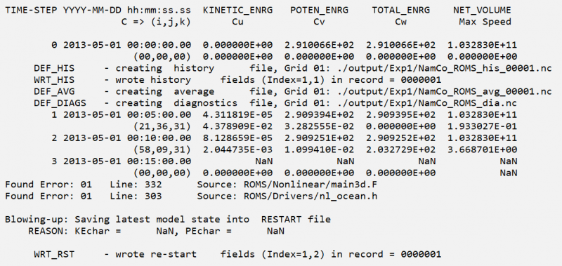

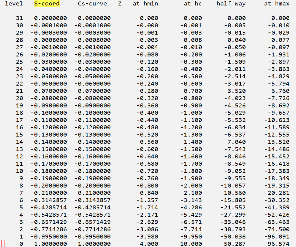

However, if I set the s-coordinate with an intersified surface layer, the model blow up with the 'REASON: KEchar = NaN, PEchar = NaN' report. The following is the s-coordinate, error report , and running log.

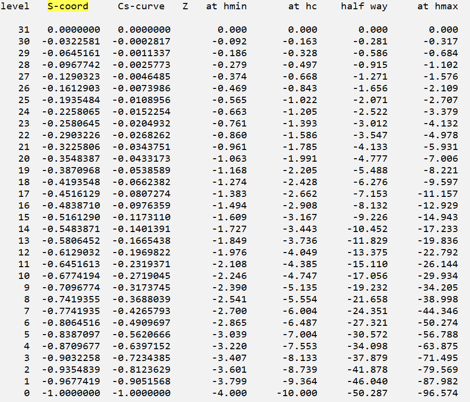

While, if I set the s-coordinate following the 'vtransform=2, vstretching=4' option, the model works successfully. The following is the s-coordinate, which has a uniform vertical spacing of 0.03.

That's a very intensified surface layer. Did you try a shorter timestep? There are numerical limitations on the vertical operations which can cause blow-ups like that.

Thank for for the suggestion. The model works if I reduce the dt from 300s to 10s.
