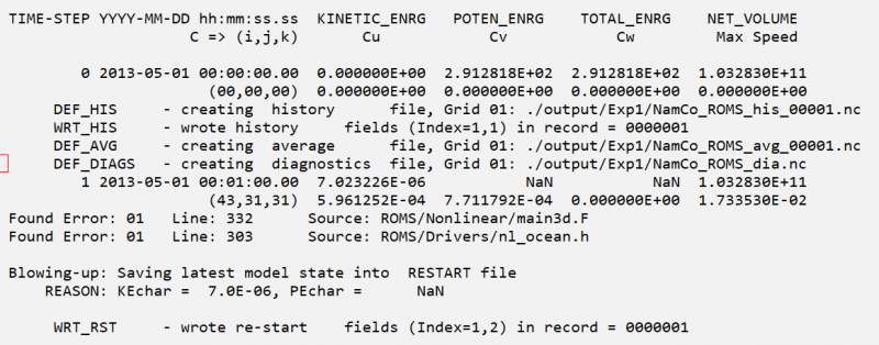

I'm recently studying the kshedstrom version <https://github.com/kshedstrom/roms/tree/master>, and the model blow up at the first timestep. However, the same input 'grid.nc, initial conditions, and atmospheric forcings' can work with the roms-3.7 version. The following is the running log <intelmpi_3181622.out>.
Hope to get some help with this problem. Great thanks!

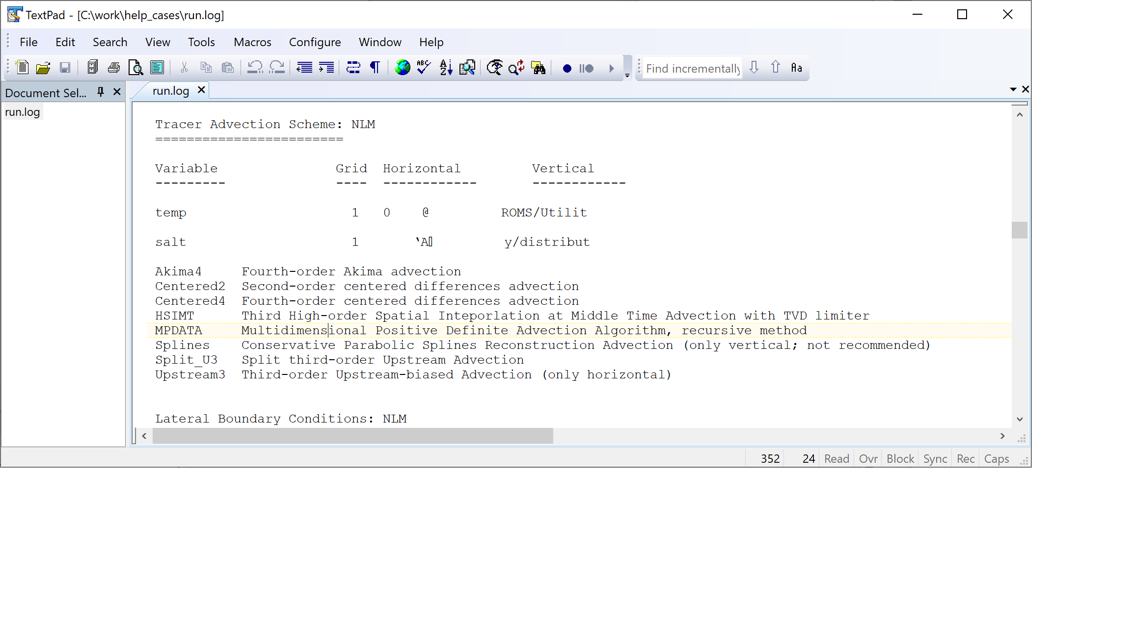

Re: ROMS<kshedstrom version> blow at the fist timestep
are you using the newest version of the input scrip?
you need to have the tracer advection schemes selected, such as
! Set horizontal and vertical advection schemes for active and inert
! tracers. A different advection scheme is allowed for each tracer.
! For example, a positive-definite (monotonic) algorithm can be activated
! for salinity and inert tracers, while a different one is set for
! temperature. [1:NAT+NPT,Ngrids] values are expected.
! Keyword Advection Algorithm
! A4 4th-order Akima (horizontal/vertical)
! C2 2nd-order centered differences (horizontal/vertical)
! C4 4th-order centered differences (horizontal/vertical)
! HSIMT 3th-order HSIMT-TVD (horizontal/vertical)
! MPDATA recursive flux corrected MPDATA (horizontal/vertical)
! SPLINES parabolic splines (only vertical)
! SU3 split third-order upstream (horizontal/vertical)
! U3 3rd-order upstream-biased (only horizontal)
! The user has the option of specifying the full Keyword or the first
! two letters, regardless if using uppercase or lowercase. If nested
! grids, specify values for each grid (see glossary below).
Hadvection == MPDATA \ ! temperature
MPDATA ! salinity
Vadvection == MPDATA \ ! temperature
MPDATA ! salinity
MPDATA ! salinity
MPDATA ! salinity
- Posts: 10
- Joined: Mon Jul 01, 2019 1:22 pm
- Location: Nanjing University
Great thank! The problem has bees solved!
