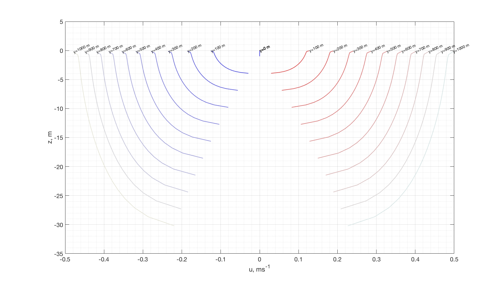

Dear all,
My grid is a wedge-shaped f-plane domain with a constant bottom slope, initialized with uniform temperature and density fields, and zero u,v,w velocities everywhere.
The only forcing is a constant alongshore surface momentum flux (via ana_smflux), using BODYFORCE to distribute it to all vertical levels (levsfrc = 1), monotonically increasing as a function of cross-shore distance.
The issue is that I am not understanding why the alongshore (u) velocities in the surface cells are so much larger than in the cells just beneath them.
As an example, I've attached a plot showing instantaneous snapshots of depth profiles of alongshore velocity at various cross-shore locations.
The red hues are for a run under downwelling-favorable circulation, and the blue hues are for a run under upwelling-favorable circulation.
Notice the kink at the surface of the velocity profiles; that's the feature that I'm trying to figure out.
I'm not sure where to even begin looking to address this, so I would appreciate any guidance or help.
Thank you very much;

wilkin
Posts: 922
Joined: Mon Apr 28, 2003 5:44 pm
Location: Rutgers University
Re: Artificially strong surface velocities (BODYFORCE?)
#2 Unread post by wilkin »
What do you have for LEVBFRC?
aryansafaie
Posts: 54
Joined: Wed Jan 07, 2015 2:48 pm
Location: University of California, Irvine
#3 Unread post by aryansafaie »
Hi John,
1 for levbfrc.
wilkin
Posts: 922
#4 Unread post by wilkin »
It's not obvious to me why you would be getting that surface shear effect, and quickly looking at the BODYFORCE code I don't see any problems with the k indexing.
Maybe try stripping out a lot of the options you have that you don't need.
In particular, MIX_GEO_UV (and MIX_GEO_TS) - you have no density gradients so no worries about diapycnal mixing.
Your grid resolution is uniform so you don't need DIFF_GRID or VISC_GRID.
PJ_GRADPQ4 is an unconventional choice of pressure gradient - is there a reason you picked this?
The term that might be monkeying with the surface is the GLS_MIXING. Perhaps try using ANA_VMIX instead of a closure scheme. With BODYFORCE you don't need the a closure scheme to mix the wind stress momentum into the water column. It's only for subsequent shear in the flow.

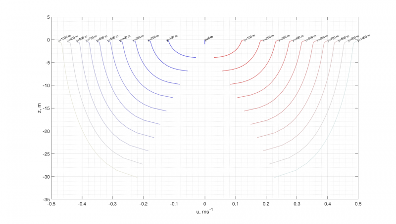

aryansafaie
Posts: 54
#5 Unread post by aryansafaie »
Hi John,
Thanks for the advice.

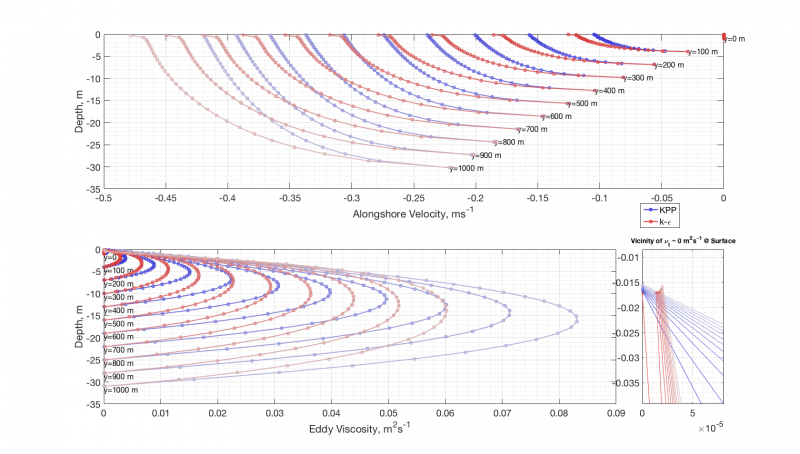

Now this is interesting: I was inspired by what you mentioned regarding my use of the k-epsilon closure; so I ran another quick simulation, this time using KPP instead.
A comparison of vertical profiles of alongshore velocities and eddy viscosity at various cross-shore locations is shown below.
Unlike the GLS run, the KPP run lacks the high surface shear, and at the surface, the eddy viscosity goes exactly to 0 (unlike k-epsilon).
Could part of the issue be that I have the Charnok CPP turned off, even though I'm prescribing a surface "wind stress" via ana_smflux?
I'm going to go down that path and I'll report back.
Thanks again!
-aryan

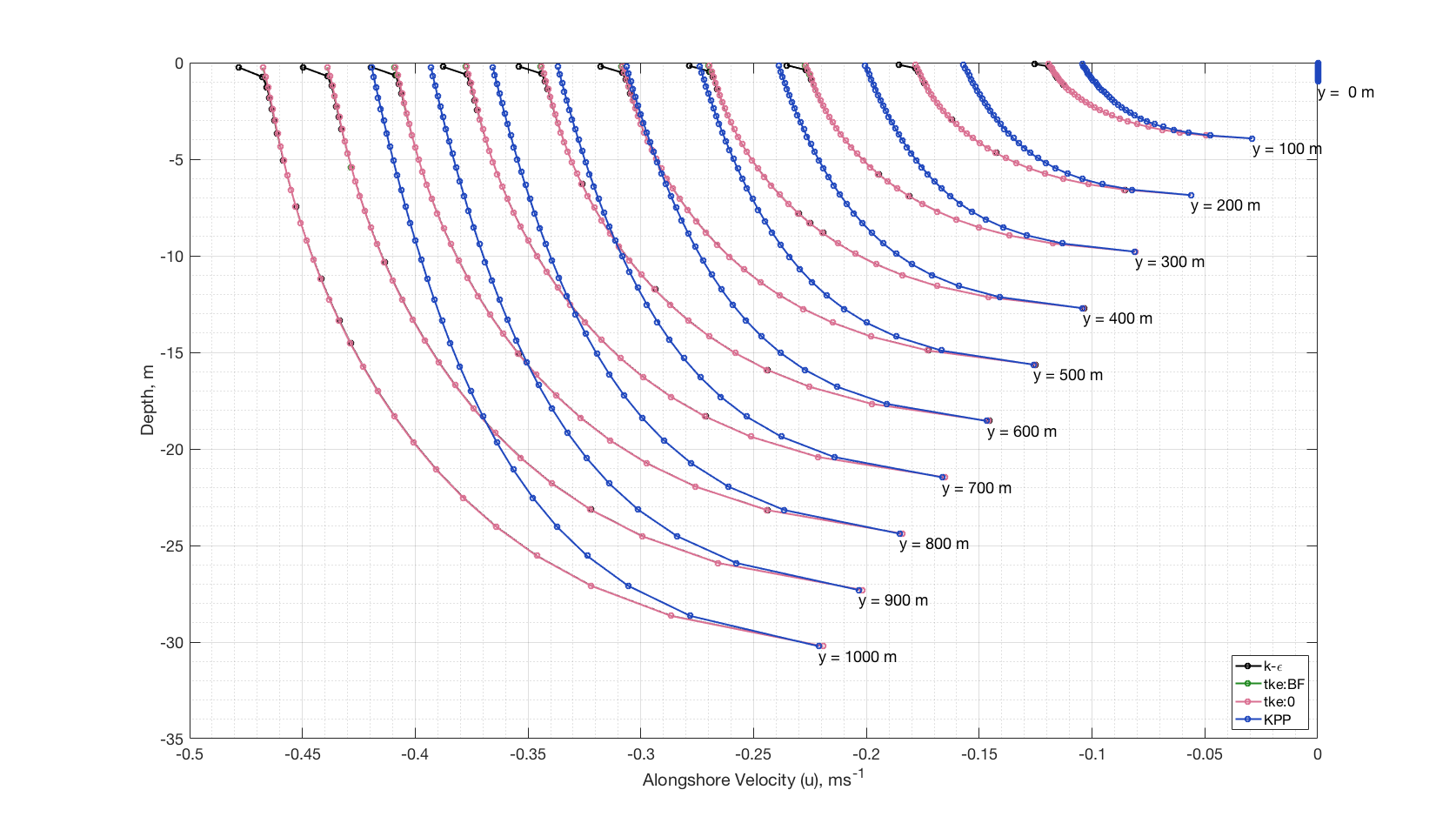

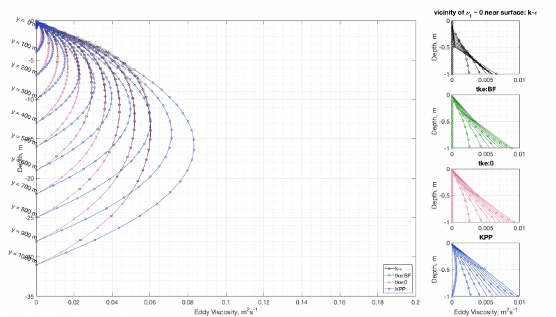

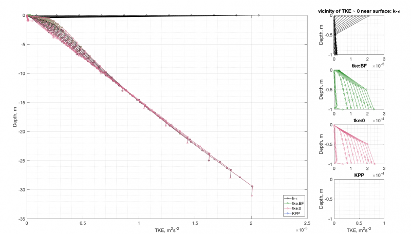

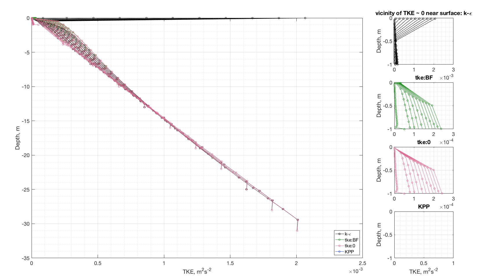

aryansafaie
Posts: 54
#6 Unread post by aryansafaie »
I believe it's about time I post an update:
After reexamining Warner et al 2005 (OM), it seemed like a good idea to reconsider the surface boundary condition for TKE (equation 51 in that paper).
The file gls_corstep.F contains code to implement the surface BC for TKE; from my prior simulations, it seems that the surface TKE boundary condition was too large: as per ks = u*2/(cmu0)2, it seems that all of the surface momentum flux I'm prescribing via ana_smflux.h is going into that surface cell, and not just the scaled u*surface2 that I would expect via the BODYFORCE CPP.
Therefore, I ran two additional simulations in which I manipulate gls_corstep:
#1: I set TKE@the surface = 0
#2: I multiply the surface TKE boundary condition by the ratio of the grid cell thickness to the water column depth:
TKEs = (∆z/Htotal)*[(u*)/(cmu0)]2
this latter idea is to ensure that the TKE surface boundary condition takes into account the BODYFORCE CPP.
I've attached plots showing vertical profiles at various cross-shore locations of eddy viscosity, alongshore velocity, and TKE; the black line is the default GLS k-epsilon scheme, the red line is just setting TKEsurface = 0, the green line is my little hack (#2 described above), and the blue line is using the KPP scheme as a sort of sanity check.
It seems that in either of my little manipulations to gls_corstep.F, more physically realistic results are obtained by (correctly?) reducing the TKE at the surface.
These results are fine and dandy for my purposes, but I just wanted to be sure I'm not overlooking anything or making a horrible mistake.
