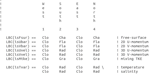

What I plan to do : I try to calculate zeta and 3duvw in a semi-closed coastal area, which north boudanry open, south/east/west boudanry closed.
Forcing
: forcing condition is large wind, may result in large zeta and uvw. So maybe Rad is suitable for me to deal with the open boudanry.
Boundary : My present boundary conditon (I wonder if it's Ok) and results of zeta near north boundary (reflection) (run time=60s)shows below (PS : I set ana_fsobc and ana_m2obc as zero):
Now the issue is reflection appeared near the north boundary.

Maybe you should change tke boundary to gra

Thank you, Hoty:
After some trials, I found I could expand the area to decrease the influence of boundary reflection.
And I use:
