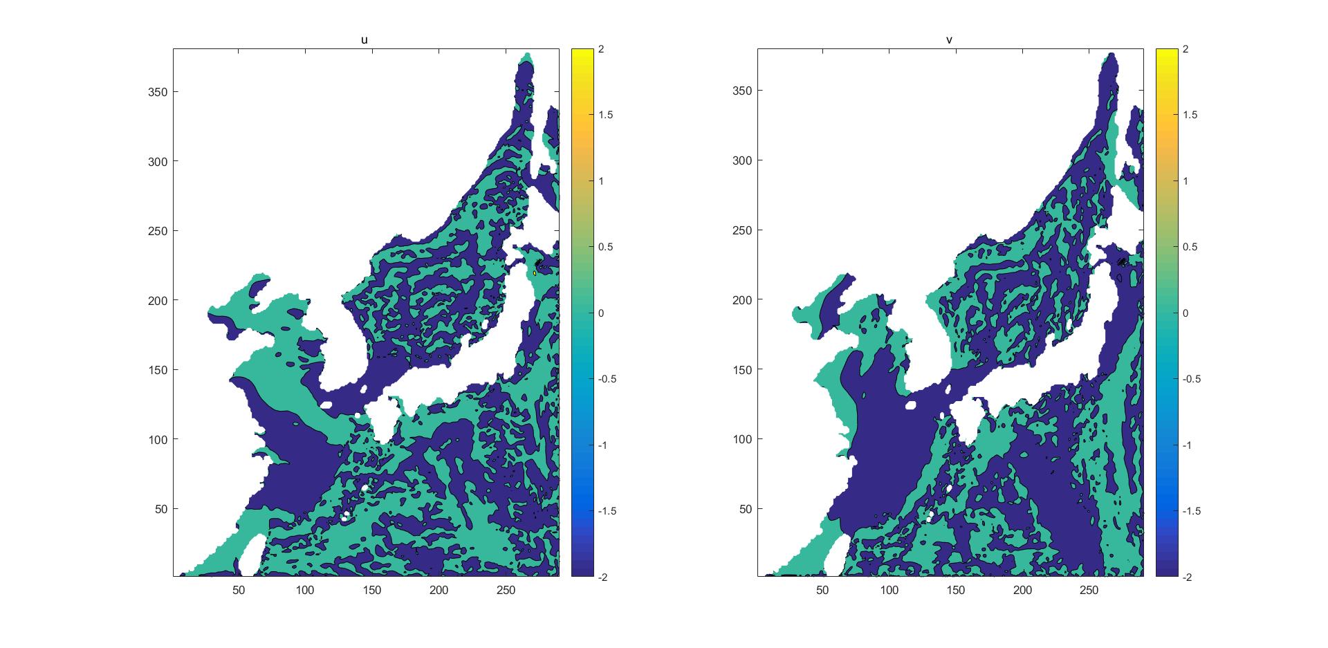

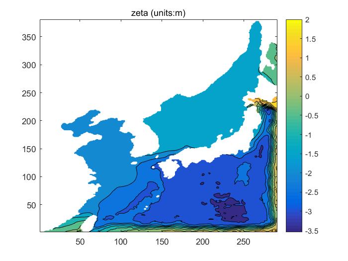

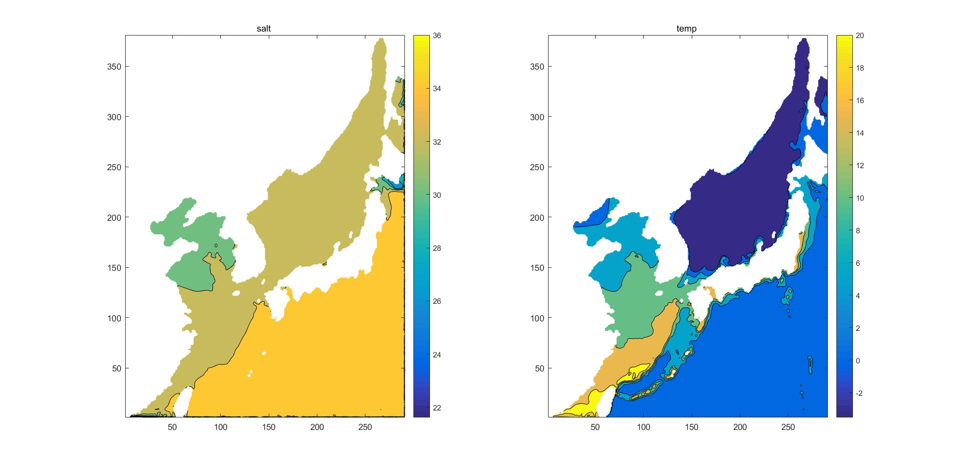

#5 Unread post by fLy0516 »
zeta from restart file is extremely abnormal at open boundary ,
u/v are unreasonable throughout the region.
temp/salt are plausible.
figures as shown below.

Salt looks like you have boundary weirdness, low values right at the edge. Zeta seems to be in balance with a strong boundary current which I'm not seeing in the u, v plots. Have you looked at the boundary files to see if the fields there look reasonable?
What values did you pick for LBC all around?

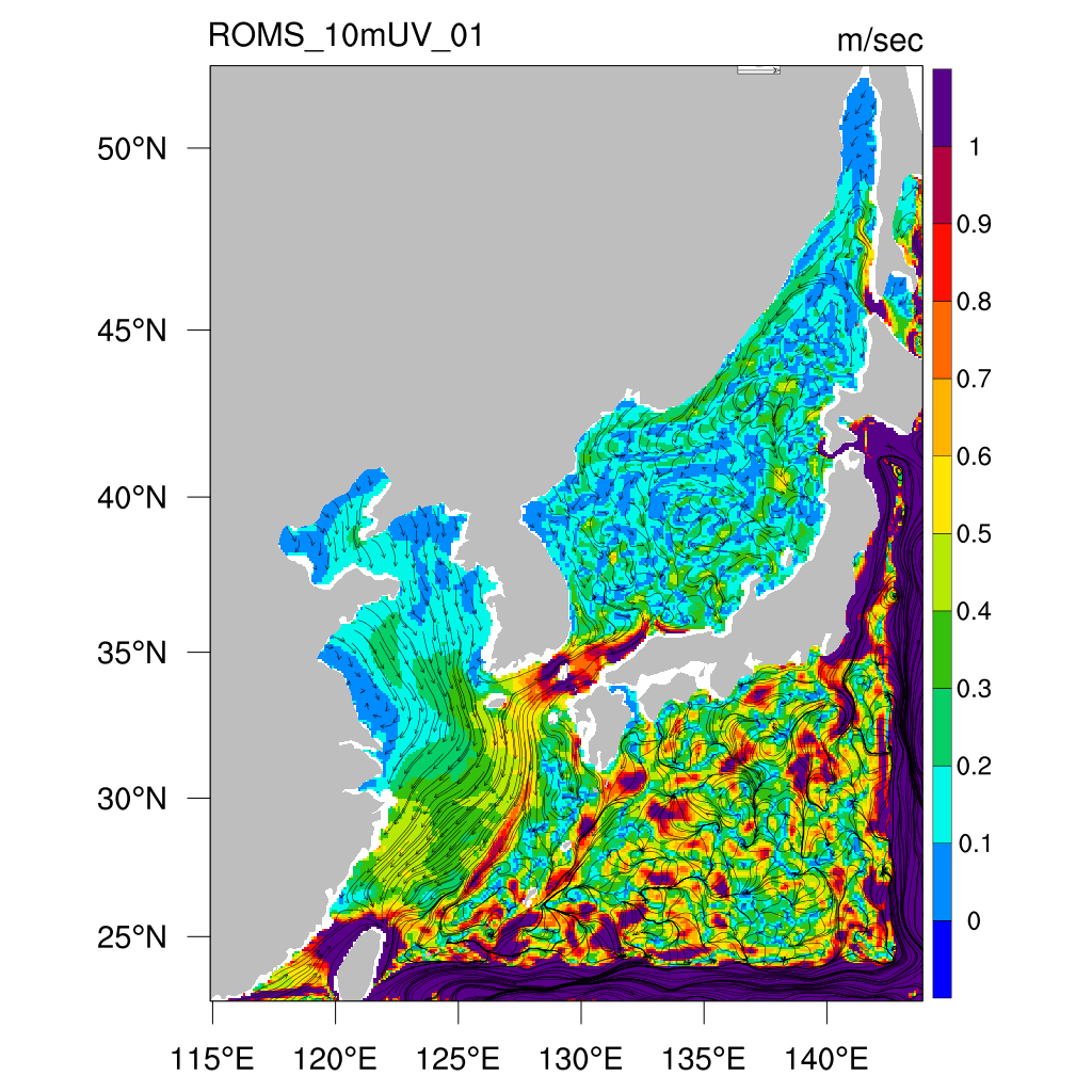

#7 Unread post by fLy0516 »
Yes, you are right. there are strong current speed at the open boundaries,and which course the zeta is large. current is shown as following.
