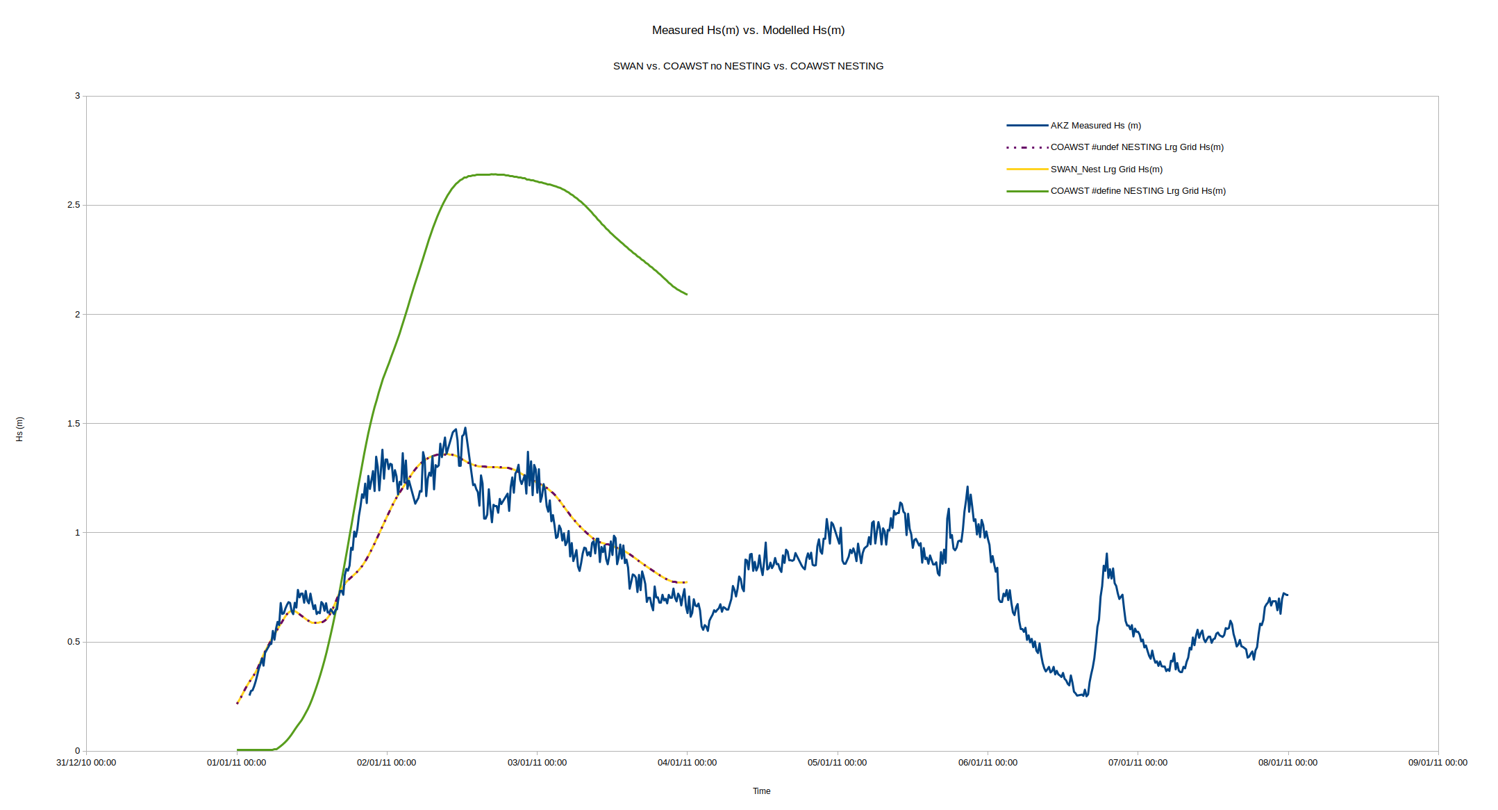

However, when the calculated HSIGN (and TP) is compared to the measured data, an #undef NESTING (large grid) run and a native SWAN run the results shows an extreme over estimation of the HSIGN. The attached plot shows the measurements, SWAN only, ROMS SWAN_MODEL unrefined (no nesting) and ROMS SWAN NESTING. This problem is also present when coupling SWAN to ROMS with refinement.

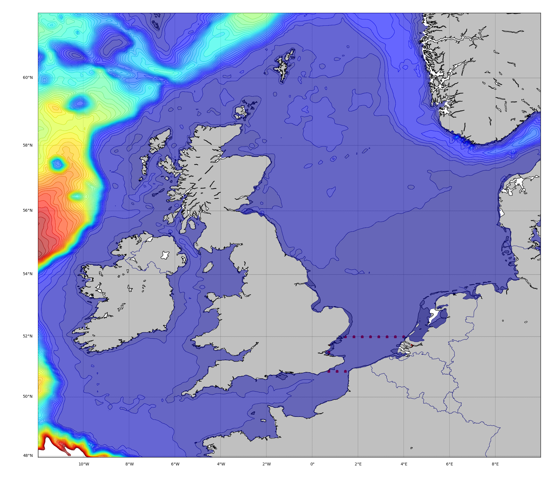

Model domain (refinement indicated with red dots)
Plot of Results (Blue = measurements; red dash/ yellow - SWAN no refinement; green = ROMS SWAN NESTING)

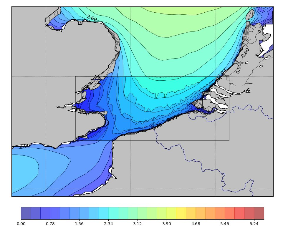

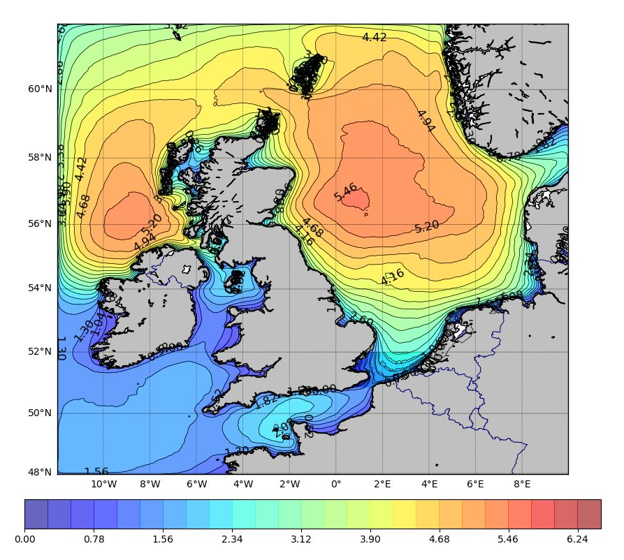

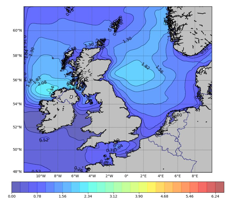

1. See attached results. The Nested large and smaller grid Hsig calculations are consistent with each other (no clear offset or weird spatial issues). I have included, for reference, Hsig plot of a non-nested run, which agrees with the measurements. AS can be seen from comparing the Nested results with the NON-nested HSIGN results, the wave heights differ significantly but the overall wave patterns are consistent with each other. It is as if the effect of the wind forcing on the energy transfer is amplified in some way. I have not checked if there is some kind of correlation between the HSIGN of the NEsted and the NON-Nested (I will do that tomorrow)

SWAN NON_Nested HSIGN
SWAN Nested Hsig (zoomed in) with the nested grid framed -> nested grid results are not far removed from the large grid
SWAN Nested HSIGN
SWAN Nested HSIGN
