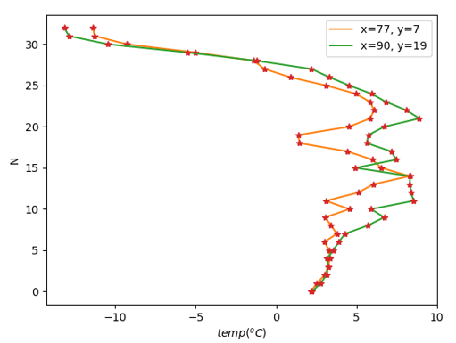

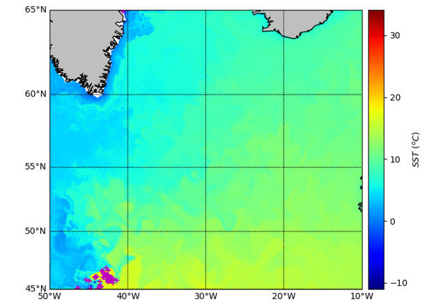

In my roms-only simulations, I meet a big problem that is the SST appears outlier values(less than 10 ℃), as shown in below figure.
Forther more, the SST distribution is not smooth.

the vertical profiles of the outlier temp values
the SST less than 10 ℃ in 200502

Have you looked at the boundary file? Is that where you have inflow going on? It does look like a boundary problem to me.
