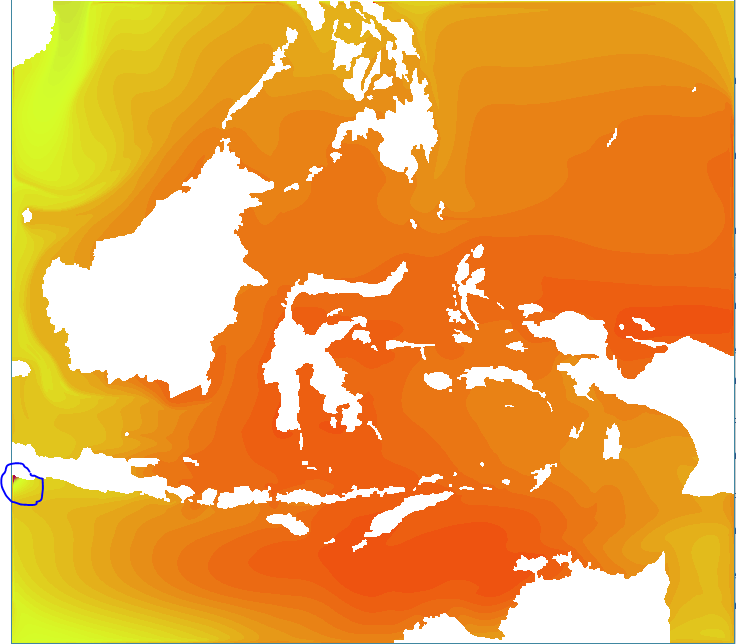

Hi Kate, I want to ask about the nudging coefficient. I use these parameters to calculate the nudging coefficient (in d_nudgcoef.m). But the results, there is abnormal decrease/increase in temperature at the edge (please see the figure).
inner = 1/60; % 60 days at interior limit
outer = 1/5; % 5 days at boundary
width = 8; % 8 points
work = zeros(Lr,Mr);
work(:,:)= 1/10;
And this is the setting of my boundary condition
   LBC(isFsur) ==   Cha     Cha     Cha     Cha         ! free-surface
   LBC(isUbar) ==   Fla     Fla     Fla     Fla         ! 2D U-momentum
   LBC(isVbar) ==   Fla     Fla     Fla     Fla         ! 2D V-momentum
   LBC(isUvel) ==   Rad     Rad     Rad     Rad         ! 3D U-momentum
   LBC(isVvel) ==   Rad     Rad     Rad     Rad         ! 3D V-momentum
   LBC(isMtke) ==   Gra     Gra     Gra     Gra         ! mixing TKE
   LBC(isTvar) ==   RadNud  RadNud  RadNud  RadNud \    ! temperature
                    RadNud  RadNud  RadNud  RadNud      ! salinity
      OBCFAC == 1.0d0                      ! nondimensional
Could you give me any suggestion about my nudging coefficient or my model configuration?
Thank you
please see the blue circle, there is abnormal high SST at the edge.

#8 Unread post by kate »
First, what is the land mask doing right there? You might want to change:
______
.........|_____
to
________________
filling in the leftmost water points with dirt. That's what I would try first. Next, look to see what the velocities are doing in that corner.
