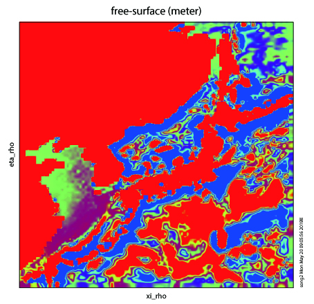

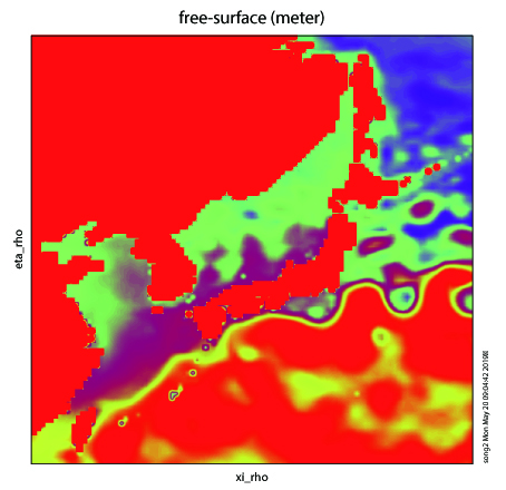

As shown in the attached figure, the initial free surface value is calibrated with HYCOM data. However, as you can see in the results 10 minutes later, the free surface changes strangely. Immediately thereafter, the model will display an error message in the blowing-up state. In this case, I was just wondering if there were other input data issues or a more reliable header setting depending on the experience of others.

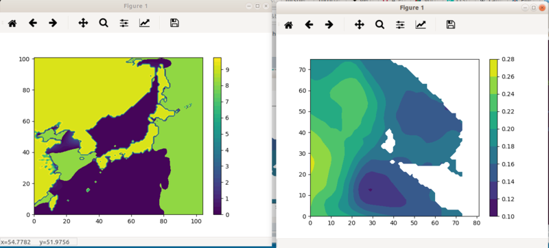

I was checking your zeta for initial condition and I saw values of -1444 m and max value of 10 m. In my humble opinion as ROMS user, I think you might have not masked properly your land and you should check the region where zeta is 10 m, maybe? I am using HYCOM as well and my model is running smooth so far. I attached your figure (left panel) and my domain (right panel). I know we are in two different regions but take a look at how my land is masked and in yours the land doesn't show at all. I would check the other variables as well.

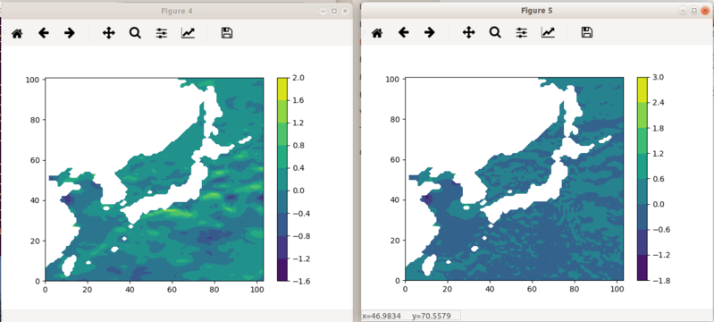

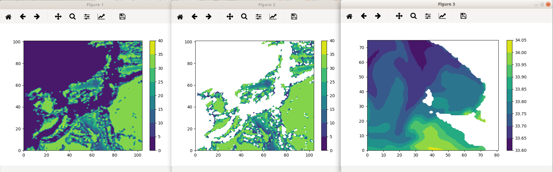

Again this is all based on trial and error (Kate said that to me once ahah). I looked at your IC file and salinity and temperature are also kinda messed up. For example, figures 1 and 2 are from your IC file and 3 from my file (I'm kinda person that needs to visualize my data that's why I am plotting it to explain to you), Figure 1 is SSS plotted straight from your nc file. Figure 2, I masked it based on your mask_rho in your grid file. As you can see, when I masked it there's some places where it was supposed to have data but instead it was either 0 or nan values and therefore it was masked. So again based on my previous experience there's something funky with your interpolation.
Now, the funny part is that your u and v velocities are masked and interpolated just fine (take a look at Figs 4 and 5 for u component for surface and bottom, respectively).
Are you using the matlab codes that they provide to interpolate your fields? Or pyroms? If not, I would check them out. If so, maybe downloading the codes again just to make sure you didn't modify anything crucial for the interpolation of salinity and temperature fields.
Give it a try and let us know,
Mat

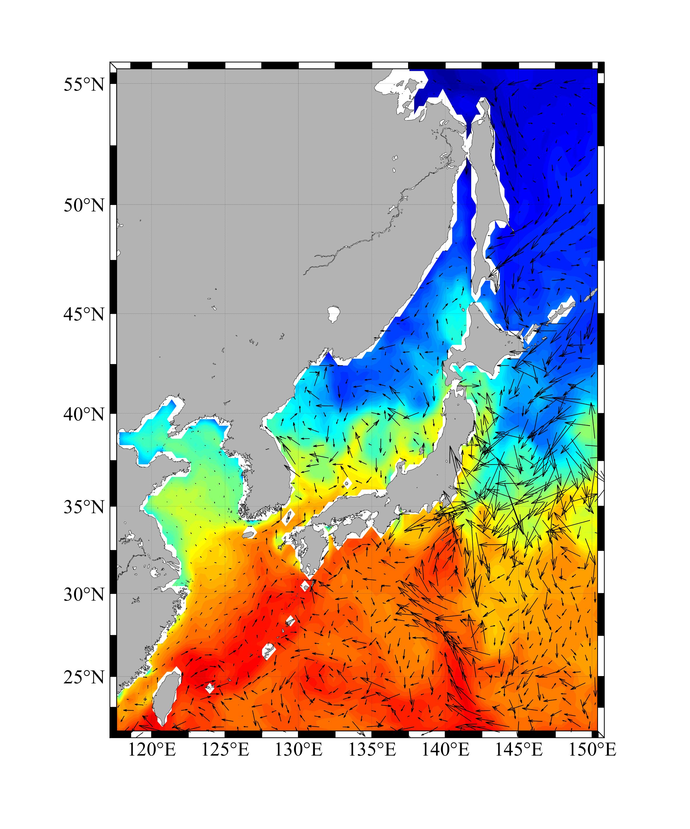

I gave up trying to reproduce the tide currents and ocean currents at the same time, began to examine whether it could reproduce the ocean currents. At this way, It did not occur initial problem that was seen at the beginning, but this was because the vertical distribution(temp, salt) was moderately modified. However, it still appears to be much larger u,v vector than the real ocean current. The deeper the depth, the greater the impact.
Mean, 1 day(ocean_avg_0001.nc)
Mean, 2 day(ocean_avg_0002.nc)
(background color : SST)
Is this because my depth interpolation is too rough? Depth interpolation was done through the grid_builder, and interpolation in some areas proceeded directly. If this problem continues to occur, I would be thinking try to increase the number of grids to reproduce in more detail.
It is confusing whether this judgment is correct. If you have any advice on this, I will accept it humbly. Please let me know if there is anything you would like to tell me about this.

For larger u,v currents, that's a little bit tricky just based on two plots and your description. If you could attach for us the log file of your run we would be able to check its Maximum grid stiffness ratios which is rx0 and rx1, for example (if you think your bathymetry is too rough). Also, the length of the run is also important since if you're showing us the first time steps I would say the model is still getting stable. Give the model a little bit of time. Now, if the model is blowing up that could be your time step. Or even, choosing adequately your turbulence closures, advection flags in your .h file, or your Lateral Boundary Condition Type. As you can see, there are many things that could be happening but without at least the log run of your model is kinda hard to figure it out. Again, as you and me other people have had the same or similar problems. At least every time I face a problem in ROMS I am able to find a similar solution just by googling it. I also learn a lot just by checking the log run it's really good at pointing out where the problem is and I normally copy the problem and try to google it.
Anyways, if you can send us the log run that would be useful to try to find some answers together.
