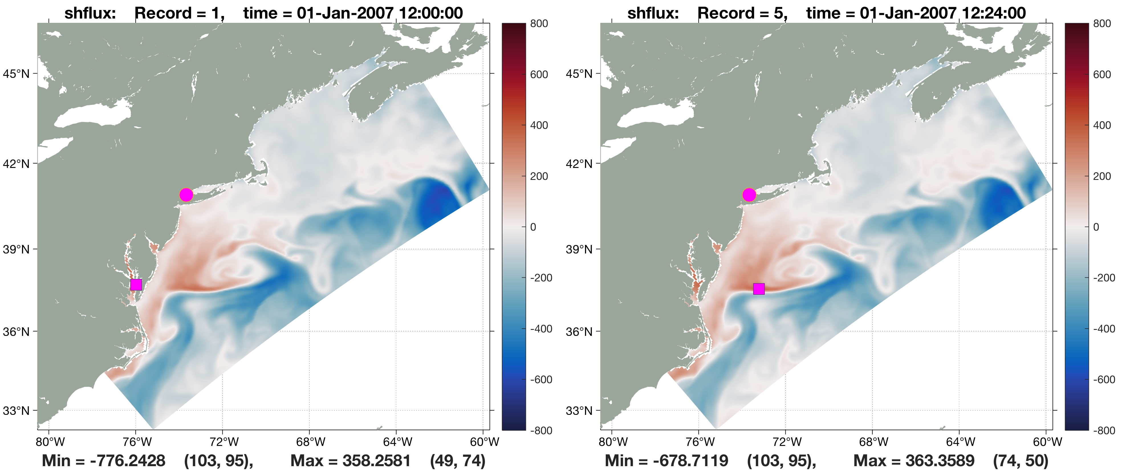

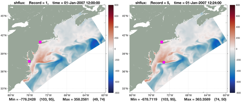

For example, serial ROMS Pair field at first time step:
MPI version of ROMS and the same Pair at first time step:
MPI version of ROMS and sustr which is OK:
