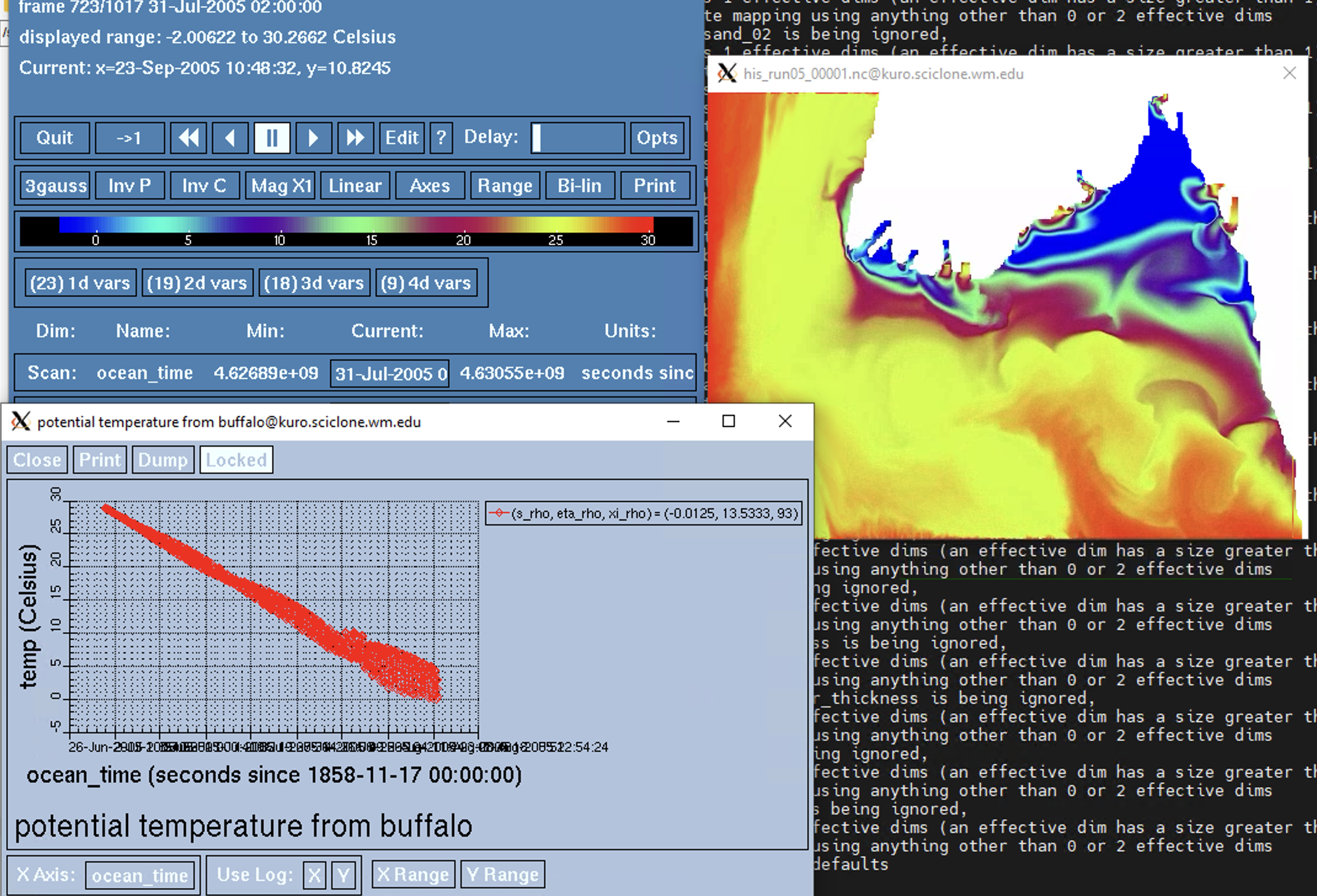

I ran into same issue with low temperature when I define LwSrc, and the model crashed. The temperature field is wrong because I run this model for summer in the tropical area. I have checked my boundary/climatology/atmospheric inputs, and they are fine. I set my river_temp = 28, but the model seems not read it.

Thank you very much for your reply! I just tested using two different river temp values. Yes, the code will read the temp.
I think my issue may be due to the mixing. I change TNU2 from 10 to zero, now it’s looks better, while the temperature still has a decreasing trend.
Another issue may be due to the point source location? I did not put them at the very landward part of the river channel. Instead, i put them near the ocean so I can make sure the sediment load all enter the ocean. Otherwise some sediment will be trapped in the channel. It could be the gradient of temperature between the landward part, the source point, and the seaward part that cause the problem?
I will try to turn off tracer’s temp to see what will happen. I didn’t do that because the roms.in suggested turn on temp and salt for rivers.
