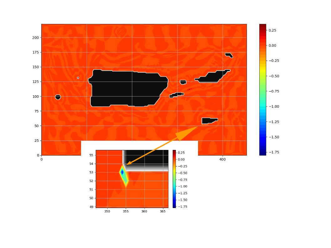

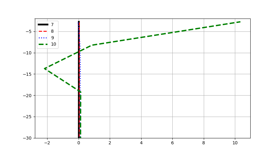

My ROMS setup is showing unrealistic velocities near the surface at the locations right next to the masked areas. The diagnostic output shows that the viscous fluxes (u_hvisc, v_hvisc) are shooting up to very high levels, messing up the velocity profiles only at the sigma points near the surface. Below, is a plot showing the profile of u_hvisc at time steps 7,8,9,10 at a point right beside the masked region.

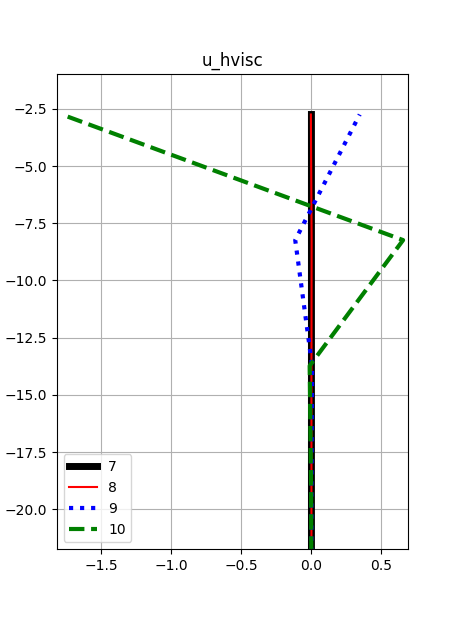

As you can see, the u_hvisc deviates from timestep 8 to 9, and keeps deviating then onwards. As a result, the velocity changes drastically. This is happening only near the surface. Below, is a plot of the velocity profile at the same time steps:

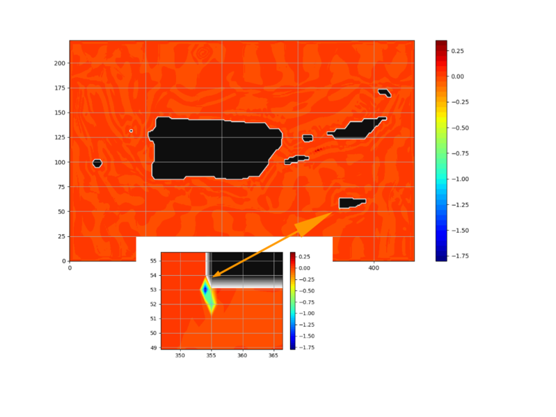

The location of this point is right beside a masked out region, shown in the contour of u_hvisc below:
As shown, this anomaly is occurring at the corner of the masked region. Everywhere else, the value of u_hvisc is almost negligible (order of 10^-06). Can anyone shed some light on this? I am not sure what parameters should be modified to prevent this anomaly near the surface points.

It looks like you're using the CariCOOS model configuration but with several modifications to the set-up (like MIX_GEO_UV that Kate noted, and I see biharmonic friction also). The CariCOOS model was running quite reliably in its configuration as of a few months ago, so any changes should be made methodically one at a time to monitor how they affect stability.
Note that just because the horizontal mixing terms are large does not mean they are the culprit driving instability. They may be a symptom only, because the divergence of the velocity gradient has already grown due to some other cause, and hence del^2(u) is large.
Something that might affect these terms specifically adjacent to the land when biharmonic friction is active is the gamma slipperiness factor. There were posts about this on the forum a long long time ago. Just be aware this could be an issue. My recollection is that no-slip is advised for biharmonic friction.
