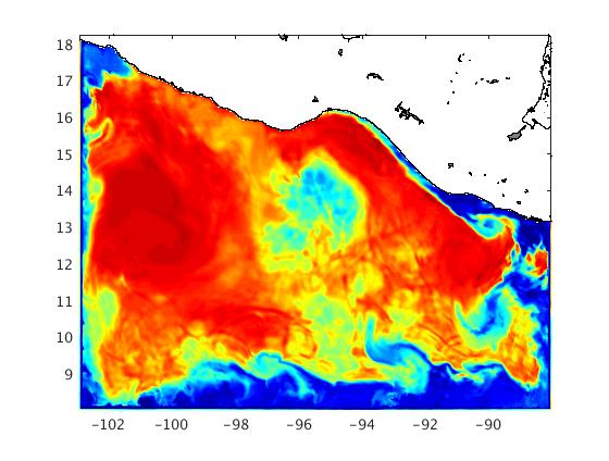

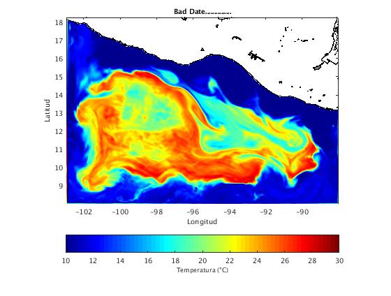

Kate, so many thanks for your time and for your help. It works but I have a problem, in my history file, the salinity downs and temperature cools down as time passes (beginning by the borders), the superficial layers begin to cool and little by little the deepest ones.

I added the lateral boundary conditions and the climatology files of the Hycom data, I have already verified this data and they are fine. The values of temperature and salinity are correct, but after the simulation I get something similar than I showed before.
I think I need to specify more for heat flux.

So many thanks for your help, I had Flather (2D momentum) for all state variables, I changed Flather for Radiation in temperature and salinity, and I increased the horizontal viscosity coefficient to 50 m2/s, and it works.

Flather is only an option for 2d momentum. You need to pick Chapman for free surface and something like RadNud for the 3d variables. Flather and RadNud both require external values to work, which helps them behave better than something like pure Rad.
