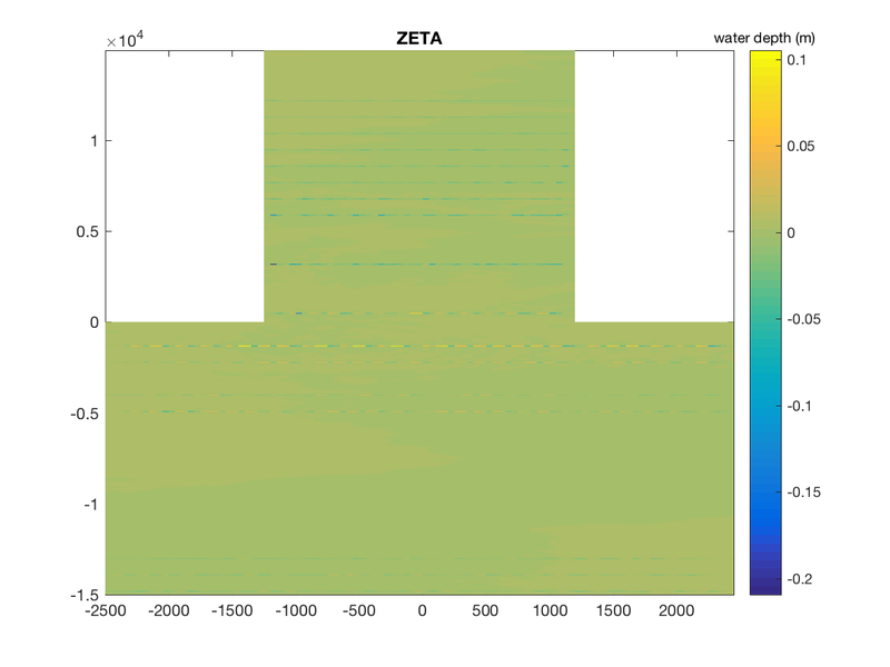

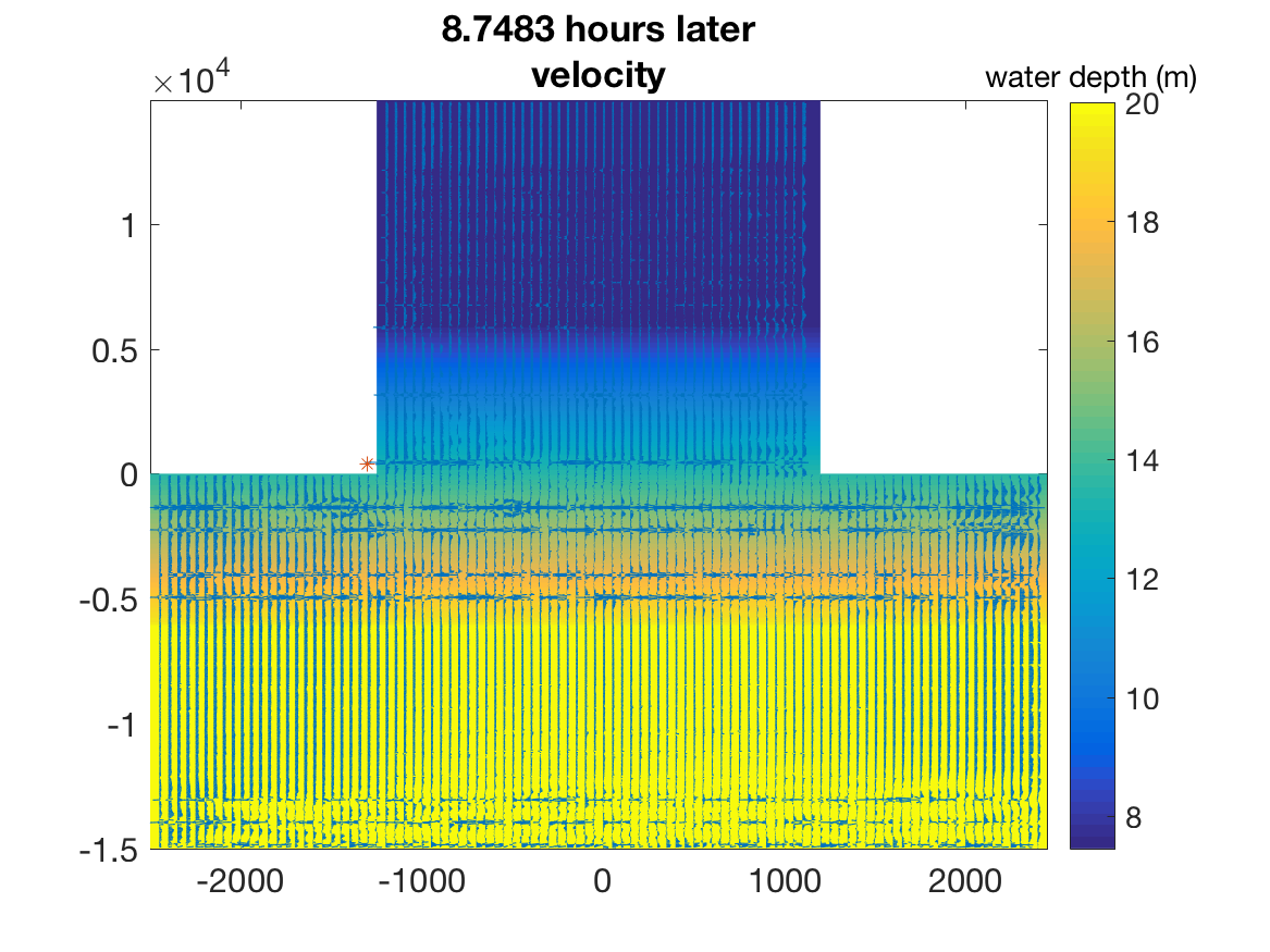

I also attached the figure of velocity at the eighth layer with red start where the last location (25, 309),the Figure of zeta and the whole out file.
