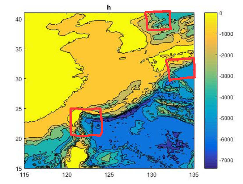

My model is blowing and I don't know why. This problem seems to have been discussed many times.
Reference before discussion,I changed my time step, cheaked the grid file, DxMIN,DYmin,DZmin,and boundary conditions.
However, the model is still blowing, I don't know how to solve this problem,
could you give me some useful advice.

Re: Blowing-up: Saving latest model state into RESTART file
This is the next step. Learn to view the ROMS output.
shiyf
Posts: 53
Joined: Mon Sep 09, 2013 11:09 pm
Location: OUC
#3 Unread post by shiyf »
kate wrote:This is the next step. Learn to view the ROMS output.
Thank you very much kate!
The problem has been solved which is caused by steep depth in some special regions(see figure below),
I was even more smooth the deep, and the model runs smoothly!
