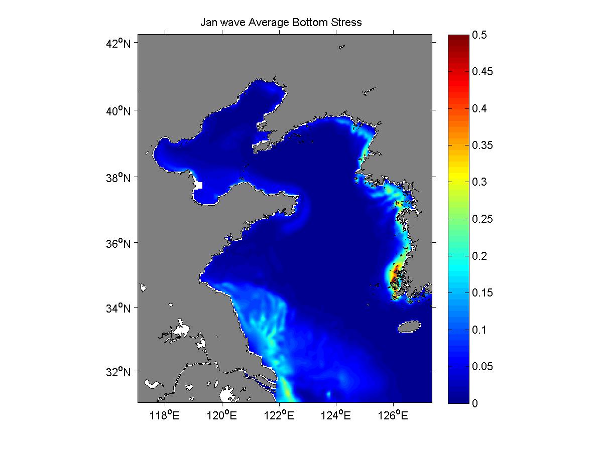

But when I check the wave induced shear stress(bustrw,bvstrw), values are really small, So I made a test that turn on the CPP options
SSW_CALC_UB, as following , and I changed nothing about others. And the result is more reasonable.
#define SSW_BBL /* Sherwood et al. BBL closure */
#ifdef SSW_BBL
# define SSW_CALC_ZNOT /* Computing bottom roughness internally */
# undef SSW_LOGINT /* Logarithmic interpolation of (Ur,Vr) */
# define SSW_CALC_UB /* Computing bottom orbital velocity internally */
# undef SSW_FORM_DRAG_COR /* Activate form drag coefficient */
# undef SSW_ZOBIO /* Biogenic bedform roughness from ripples */
# undef SSW_ZOBL /* Bedload roughness for ripples */
# undef SSW_ZORIP /* Bedform roughness from ripples */#endif
So I want to know if should I turn on the SSW_CALC_UB option when I couple SWAN and ROMS.
