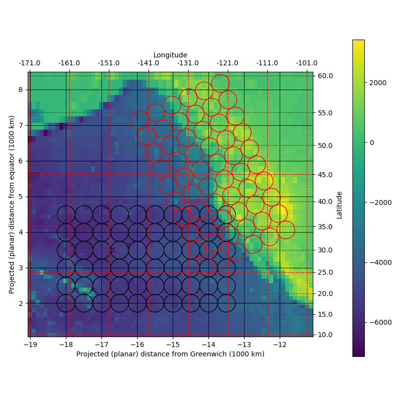

I'd like to show off a figure about one way to correctly (?) rotate the grid, where I'm trying to follow the steps from above post:
For pm, pn, I have an initial value based on the flat projection space. Then I later remap to the sphere so that I can assign lat,lon values to each point. At that time I recompute pm, pn based on the lat, lon values and distances on a sphere - with or without an ellipsoidal correction. As long as I use a conformal (angle-preserving) projection, it should still be orthogonal back on the sphere.
The objective is to obtain a ROMS grid aligned to the US west coast. The colours in the figure show depth (m) of a subsample of ETOPO2 in the North-East pacific. The bottom (left) axis shows the x (y) axis of the flat projection space (Mercator). The right (top) axis show latitude (longitude). Note the spacing between 5-degree increments of latitude increases polewards. This is characteristic of the Mercator projection.
The black grid is an equidistantly-spaced grid in the Mercator-plane. The red grid is a rotation thereof, again in Mercator-coordinates. Rotations preserve angles, so I guess they are trivial conformal maps (?). However, the rotation is an operation in the *plane*. Clearly, the circles that get rotated to the north encompass a smaller area on the sphere (i.e. after the inverse projection), but that doesn't matter; The only thing one cares about is that the red grid is still rectangular on the sphere. This way, ROMS' curvilinear coordinates xi and eta can be interpreted as *spherical* coorinates (in the non-rotated case that would be achieved by setting pm=1/(dlon*R*cos(lat)) and pn=1/(dlat*R)). That the grid is orthogonal on the sphere is guaranteed by the fact that one used
1) a conformal map to project into the plane
2) a rotation in the plane (which trivially preserves angles)
2) a conformal map to project back onto the sphere.
After the rotation, one has to interpolate the lat/lon data onto the red Mercator-plane grid. Then we get the great-circle distances for pm, pn for the rotated grid (e.g. from the Haversine formula).
Let me know in case it's still not right.
Re: Roms grid rotation and interpolation
#14 Unread post by kate »
Yes, that's all correct. Mercator is fine until you get to high latitudes. For mid-latitudes, a better projection is the Lambert conformal conic projection. We have a Northeast Pacific grid using the latter. Plus I'm sure you've heard of polar stereographic.
