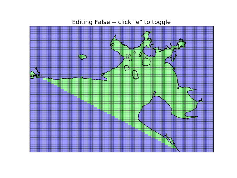

I am trying to generate a grid using pyroms but I keep getting the mask inverted
I've been using pyroms to generate grids North Caribean region without any problem,
any ideas of what could be wrong?
thanks in advance

Yeah, I had that happen once too. Another way to set the land mask is with this package. He only sets the mask_rho variable so you need to set the u/v masks to be consistent with them - one way to do that is to fire up one of the editmask tools and let it do that.

About the inverted mask, i think i have a solution or at least it work for me.
Instead of using map.coastsegs for the polygons i use map.coastpolygons, something like this:
for xx,yy in map.coastpolygons:
xa = np.array(xx, np.float32)
ya = np.array(yy,np.float32)
vv = np.zeros((xa.shape[0],2))
vv[:, 0] = xa
vv[:, 1] = ya
hgrd.mask_polygon(vv,mask_value=0)

I am guessing that the source of this, is in the way the code 'jumps' from an open coast segment to the next.
When a shoreline is interrupted by the Basemap function, the topology changes and so does the distinction between land and water.
When I ran into a similar situation, I solved it by declaring the initial Basemap function without borders (i.e. the whole world - no lonmax, latmax etc.):
In this way pygridgen gets all the topological information of where land stops.
Stamatis
map = Basemap(projection='merc',resolution='i')
