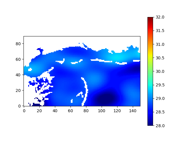

So something is wrong with my tidal forcing. I am getting an extremely tidally dominated system, when in reality, my system is mixed between wind and tide. Do I need to adjust viscosity if I add tides? I think it is a units problem. Something is way off. My tidal forcing netcdf file has amplitudes in meters and currents in m/s. The ADCIRC documentation says amplitudes are in units of distance consistent with gravity. I do not know what this means. I am doing O1, K1, N2, M2, S2, M4, and M6 and I have the tide periods as 25.82, 23.93, 12.66, 12.42, 12.00, 6.21, and 4.14 hours, respectively. Does this sound like a units problem, or could something else be causing these outrageous tides?

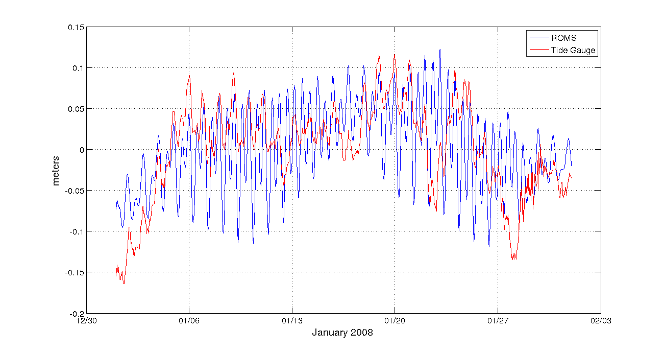

When I am applying tides on my model I get almost
2 times higher amplitude than the actual (I am
comparing with a tide gauge data, see attached figure).

johnluick
Re: Tidal Forcing File
#10 Unread post by johnluick »
Giannis,
It might be timely to mention that I have not updated TPXO2ROMS.m since before 19 April 2017, when Hernan updated the way ROMS keeps time (I haven't updated my ROMS yet either). It isn't obvious to me, from ticket 724, whether TPXO2ROMS.m actually requires updating. First, the ticket says that for time_ref = -2 (which TPXO2ROMS.m assumes is being used), ROMS uses a new and different calendar (one that runs from Jan 1, 4713 BC); then right below that it implies that it still uses the original (NASA) calendar (one that runs from May 23, 1968). If the latter is the case, then TPXO2ROMS.m should still be fine. Perhaps Hernan can clarify.
Of course, if you are using the earlier ROMS, the above is irrelevant.
Looking at your graph, my first suspicion would be that the global TPXO8 solution is too large in the Mediterranean (I assume that the domain is in the Med.). There may be a local high resolution solution on the OSU website for the Mediterranean that would be more accurate.
John
#12 Unread post by johnluick »
My second suspicion would be that there is something wrong with the tide gauge. Do you have a reliable set of harmonics? If the amplitudes of the two major harmonics (probably M2 and S2) sum to about .15 m, then the data is in error.

johnluick
#14 Unread post by johnluick »
My suggestion would be to assume your tides are ok, and move on to whatever process you are really interested in. At some point, use t_tide or something to analyse the ROMS hourly data for a point near where your harmonics are from, but don't get too hung up on an exact match to amplitude or phase. By the way most published phases (e.g. Admiralty) are in the local time zone, whereas you are probably running ROMS in UT. For S2 (for example) if the published phases are in a time zone 3 hours ahead of UT, then you have to subtract 90 degrees to match the ROMS/t_tide phase. (Since 3 hours x 30 degrees/hour = 90 degrees.)
Good luck!

So looking at my zeta vs tide gauge data, it seems that the amplitudes of my tides are reasonable, although I must have miscalculated my TIDE_START. Let me show you an example of what I have, and maybe someone can tell me if it looks ridiculous to them. Tides certainly have a big effect on our system. Although the tides are small (1–2 ft usually), the MS Sound is shallow. Still, a little wind can have tremendous affects on currents, so this is just not believable to me. Each frame of this animation represents 3 hours over a 12-day period. The horizontal extent is somewhere on the order of 60–80 miles. Does the model just need more time before wind-driven circulation starts to dampen the tide-driven circulation? I was hoping to test without doing a full model run.
Without tides, the model shows what appears to be reasonable geostrophic current patterns, but I haven't gotten my model to the point where I'm ready to start validating.
