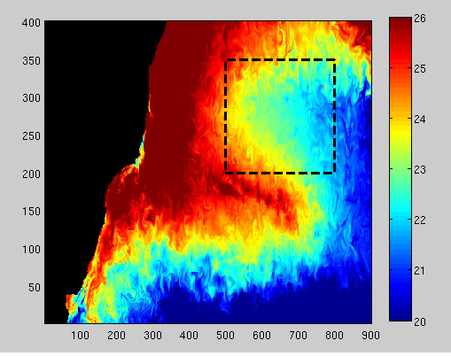

I'm using pyroms/Palau_hycom to generate .bry .ini files to my grid (Hycom data were downloaded through get_hycom_GLBa0.08..py ). The problem is, during remap (dst_varz = pyroms.remapping.remap(src_varz, wts_file, spval=spval) line in remap_bry.py), in which hycom data is horizontally interpolated to my Roms grid (a smaller region centered around i =200 and j=275 in figure_hycom), interpolation went wrong. Attached is the hycom data at the surface(figure_hycom), and the data interpolated to my grid (roms_after_remap). For some reason remap used the data in the area delimited by the rectangle (figure_hycom) to interpolate to my roms grid. Since my roms grid coordinates are correct (I've checked it), I dont know why remap is using the data from this offshore region (centered around i=650, j=275). Has someone faced a simular problem? Any tip would be highly appreciated.
PS: I've tested different grids generated from different softwares (pyroms, seagrid, delft2roms, rooms_tools), and remap continue to interpolate from the wrong region
Thanks a lot in advanced

If it's not the ROMS grid, that leaves the HYCOM grid and the interpolation software...
