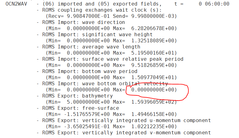

Hi everyone:
When I couple ROMS with SWAN ,they exchange data every six hours, but I found my wave bottom orbital velocity that ROMS imported are always zero, Is there something wrong with my swan.in? The attachment is my .h file,ocean.in file and my swan.in file?
Thanks very much!!!
