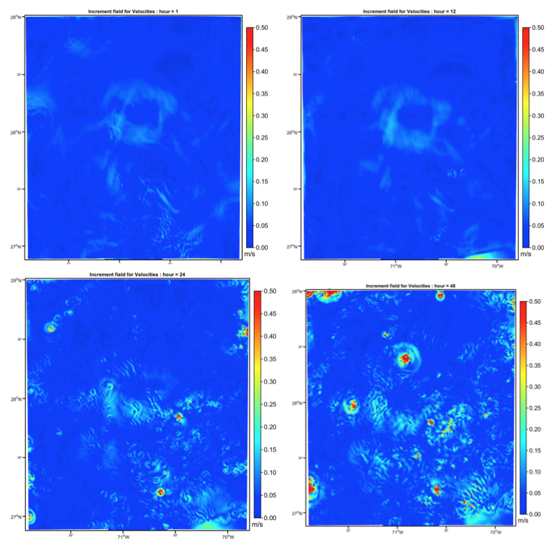

I am running the W4DVAR with strong constraint (NADJ=NTIMES) on an 800m resolution grid (40 vertical levels) with initial and boundary conditions taken from 3.7km regional NCOM (USEAST). The surface forcings are taken from a WRF model that is NOT coupled to the ROMS model. I am assimilating ship board ADCP profiles and CTD casts from a research vessel. My header, ocean.in and s4dvar.in files are in the attached zip file. I am getting these “rock in the pond” (Cauchy-Poisson problem) patterns in my velocity increment fields. They seem to be generated at the bottom model level and then propagate all the way to the surface. What I have discovered so far is that this issue does not show up if I use the incremental strong constraint (IS4DVAR). I have also tried smoothing the hell out of my bathymetry and changing my drag law specifications : no improvement. Has anyone else seen this problem before with the W4DVAR? Am I missing something obvious or is there something inherent to the dual form indirect representer based method that could cause this issue. Also I am running the 4DVAR with 1 outer loop and 40 inner loops and the cost function plot shows that it seems to have converged. Lastly, I am including a plot of the background/prior fields to show that these features are only present in the analysis.

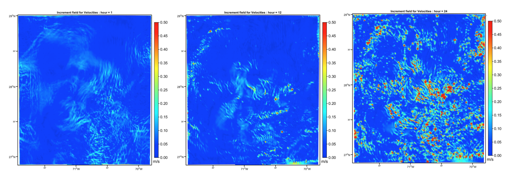

Increment velocities at model level 40 (bottom) for time 1 hr, 12 hr, and 24 hr.
Increment velocities at model level 35 for time 1 hr, 12 hr, 24 hr, and 48 hr.

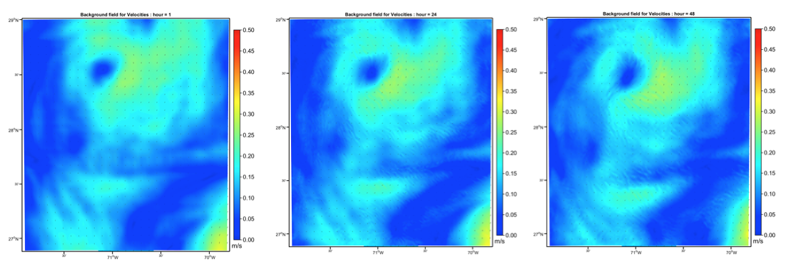

Background velocities at model level 40 for time 1 hr, 24 hr and 48 hr.

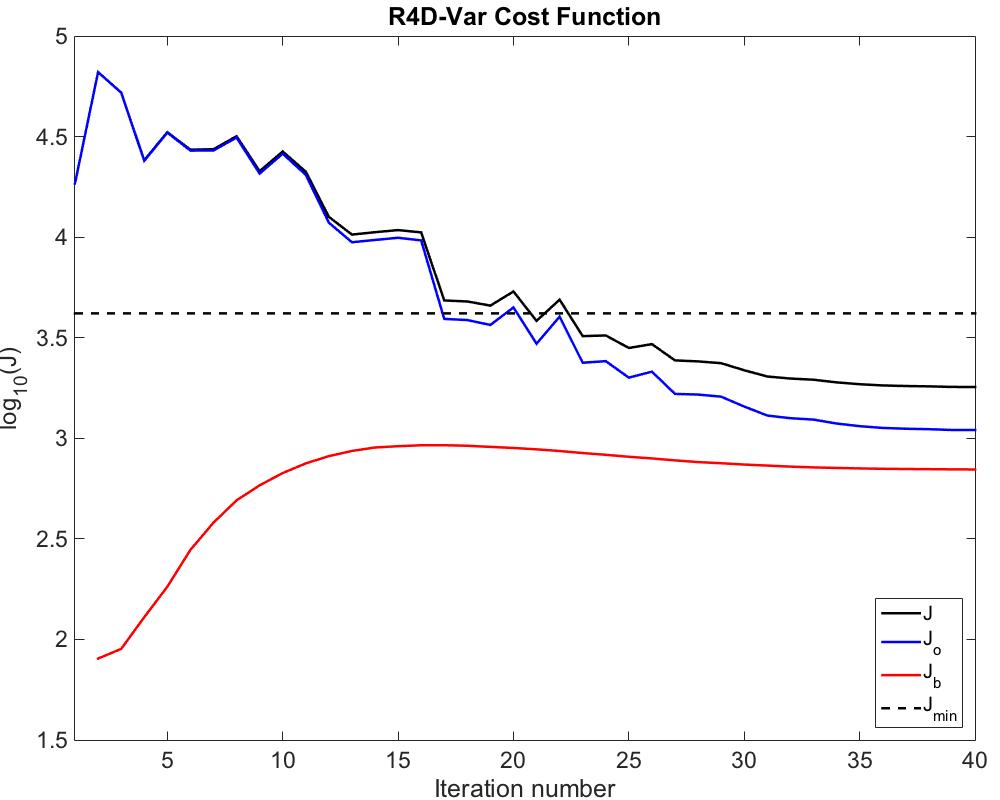

R4DVAR cost-function for one outer loop and 40 inner loops.

#2 Unread post by pmuskee »
So I think my problem was that I had the number of iterations in the biconjugate gradient algorithm used to solve the elliptic equation for the balance operator set too low for my domain. Initially I was using Nico = 200 but now I have it set as Nico = 3000. This causes my problem to disappear. I have a sense that the model grid resolution is the major reason that I need more iterations.
