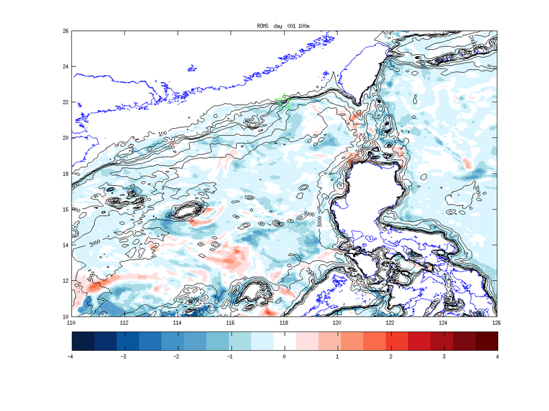

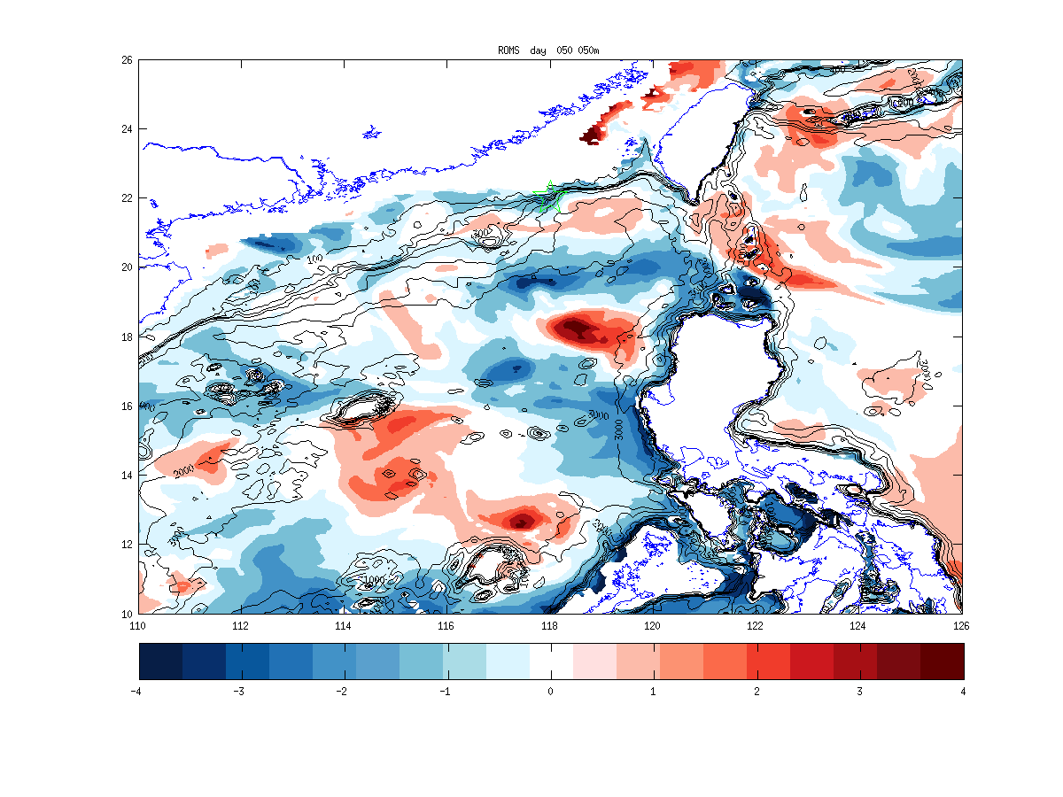

I have a south china sea(SCS) modelling case using HYCOM data for ROMS initial field and boundary field.My temp field has a difference from HYCOM.
Configurations
The domain is 95~134E and 1~35N and we have spatial varying horizontal resolution from 10km to 5km.For vertical parameterization we take Vtrans=2,Vstr=4,theta_s=10,theta_b=2,hc=400,N=30;We also apply MY2.5 vertical turbulence scheme. NCEP reanalysis is provided for atmospheric forcing with BULK_FLUX defined.Please take a look at cpp file and input file attached for more details.
Results

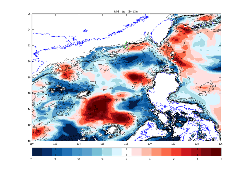

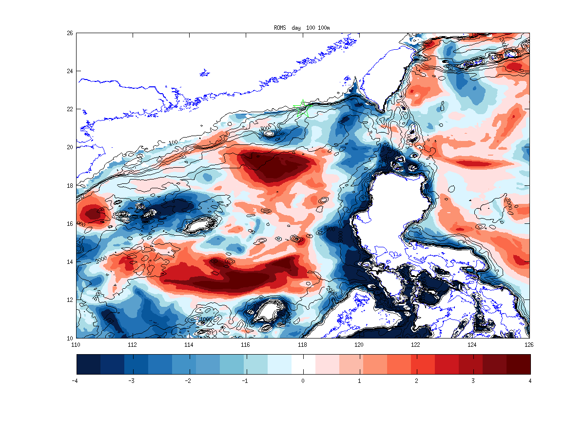

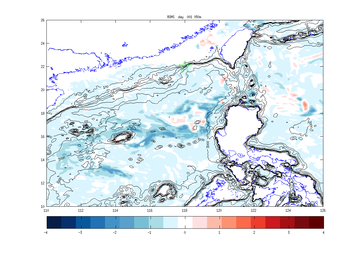

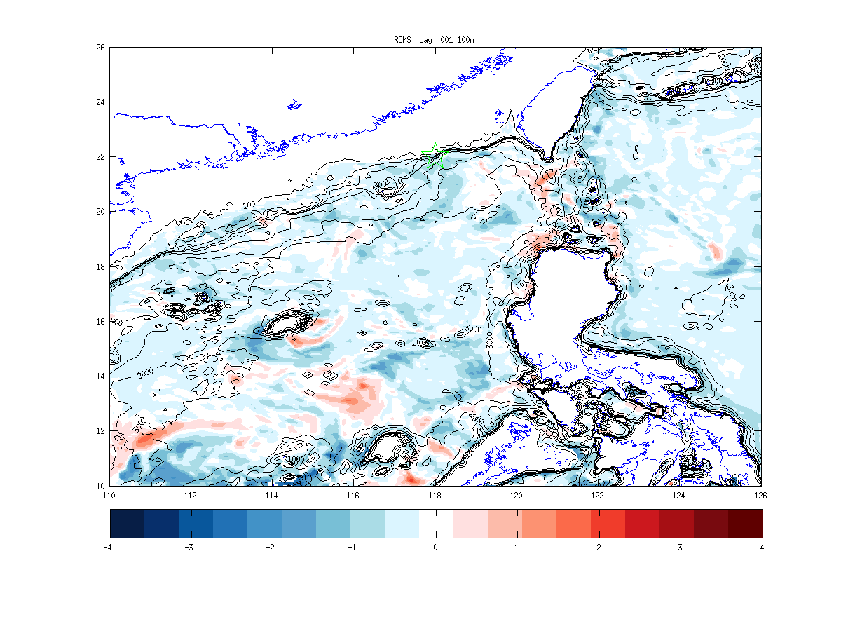

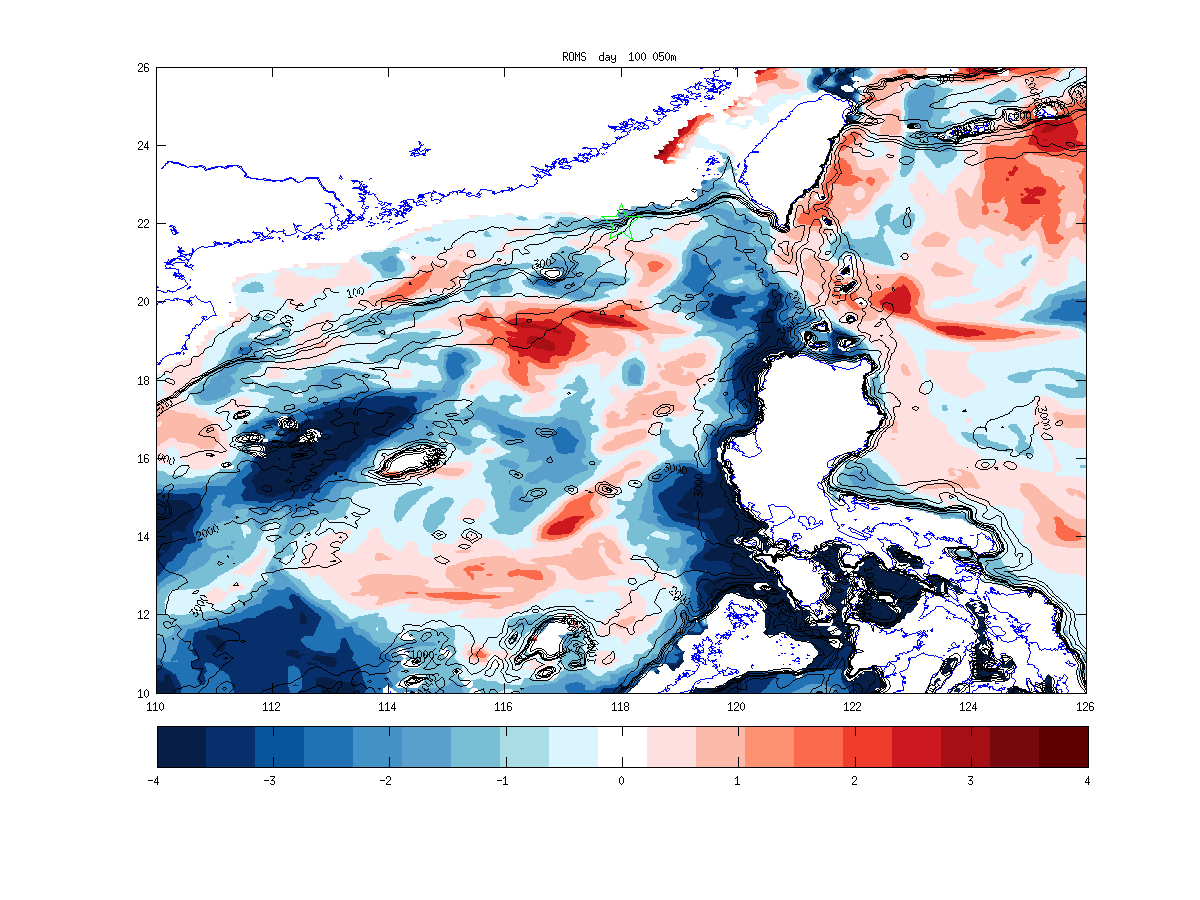

We make some plots about temp difference from ROMS to HYCOM (say Troms-Thycom) at 50m and 100m to see what our vertical mixing is going on. Seeing in attachments,ROMS initial temp field at 50m is with no doubt similar to HYCOM.Then after 50 days ROMS temp field is cooler at some coastal slopes while at some basins it is warmer. The situation is developed 100 days after. Moreover,100m temp field indicates something like "upwelling" at slopes and "downwelling" at basins :roll: .But our SST is fine.
Has anyone got an idea about this situation?Or I just messed up some aspects of ROMS configurations? :?:
Any comments is appreciated!

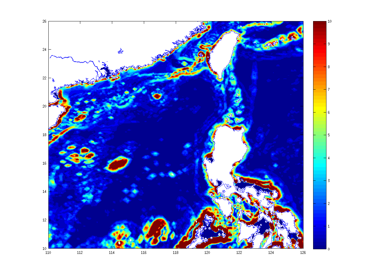

I checked Haney number (rx1) field and found it coincide with slopes where upwelling current appeared.I think my rx1 field has a close relationship to the fake upwelling current,but neither clear how HPGE leads to upwelling nor know how to decrease rx1 factor directly.
Has anyone experienced this before? Look forward to your comments!

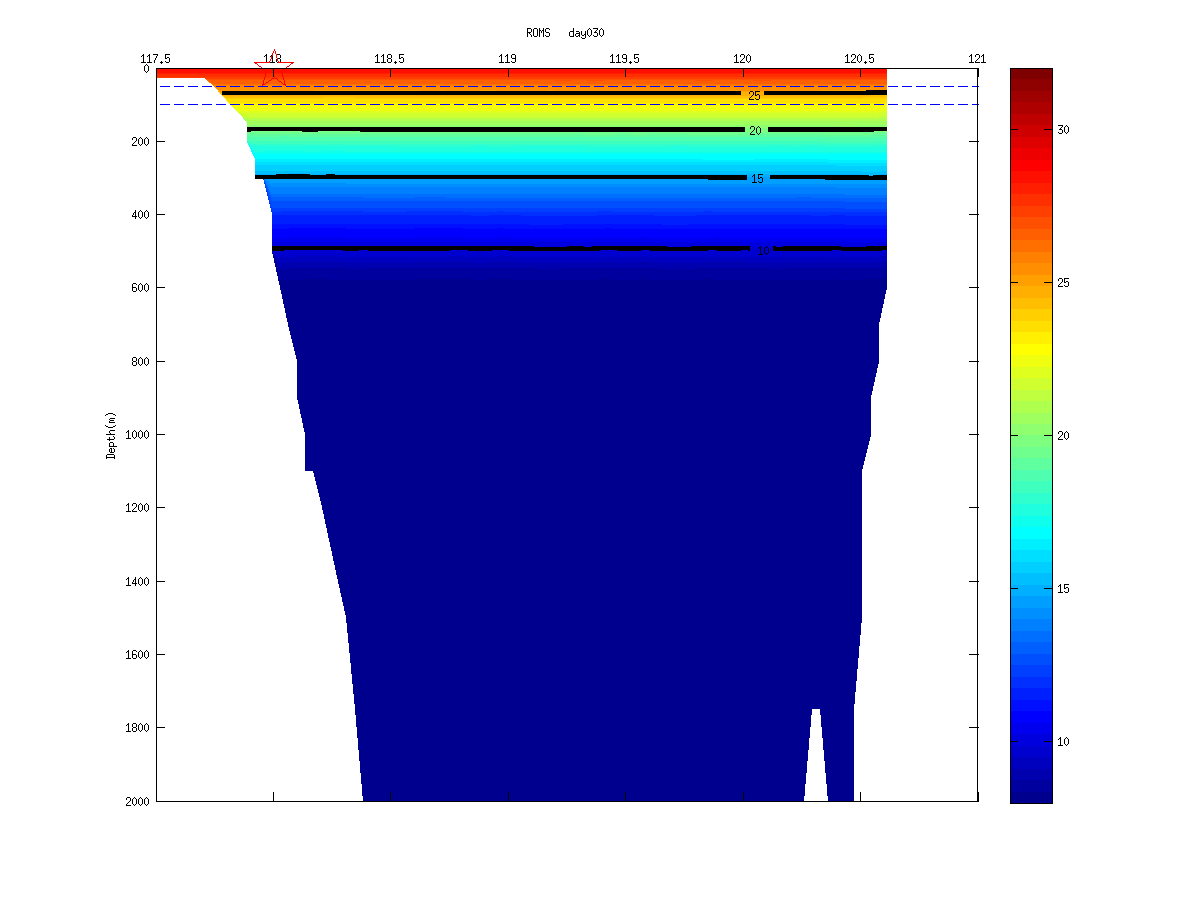

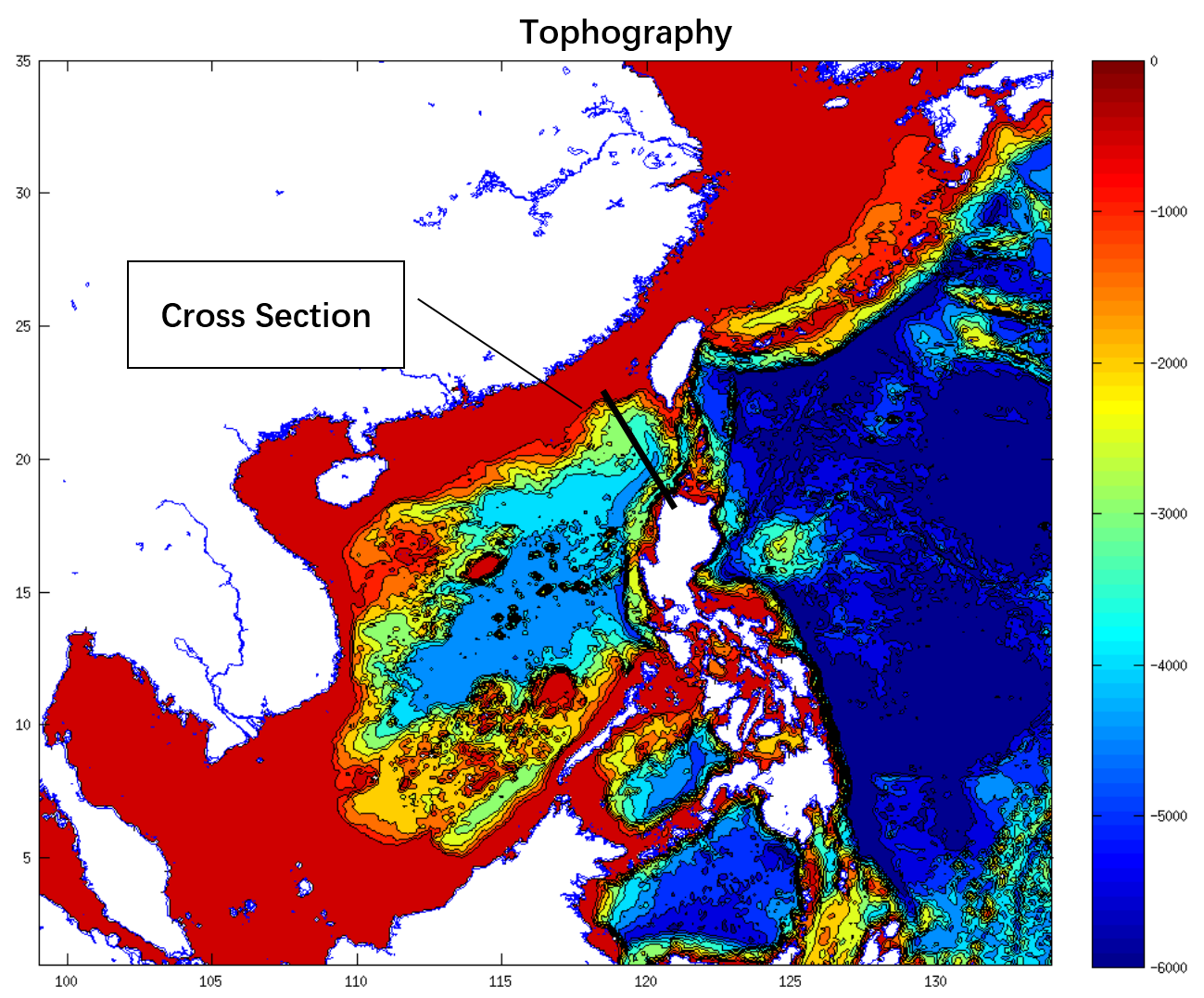

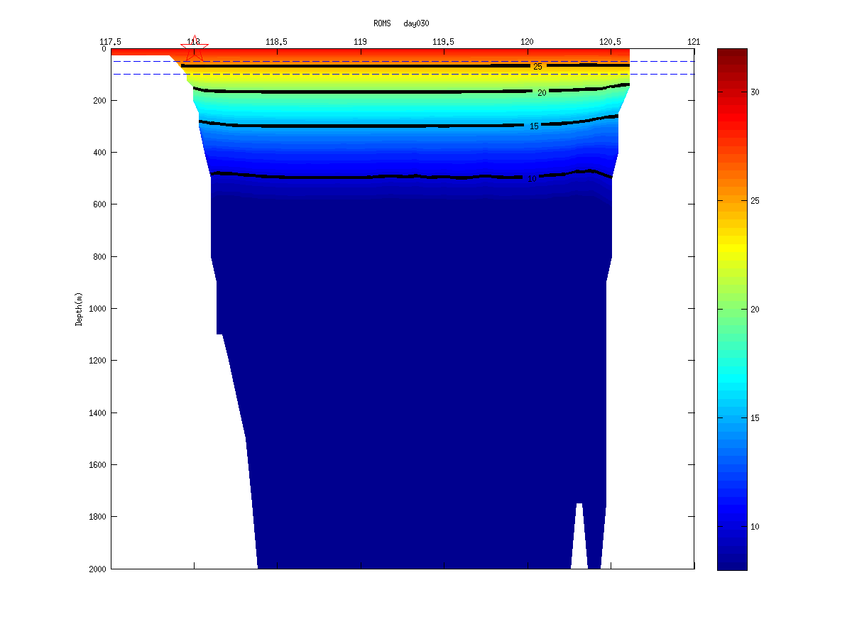

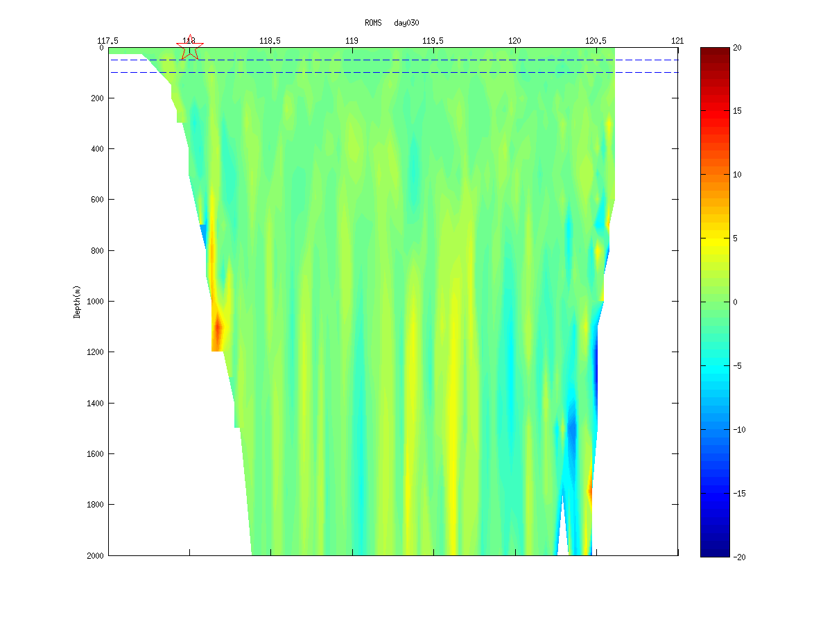

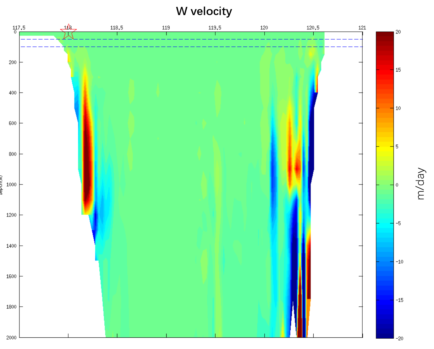

Two days ago I smoothed the topography then I did a PGE test with no forcing
and made some simple cross-section figure to check if there is any false upwelling along the slope.
See attachments:
There is w velocity cross-section figure with its unit m/day at day30.The figure shows a strong upwelling at the deep slope and it apparently destroys
water stability.At this case my maximum rx0 factor is 0.3 and maximum rx1 factor is 7.7 which I think is reasonable ,
neither can I find much discussion about upwelling due to PGE from ROMS forum.Hence I'm not sure whether I should smooth more.
Has anyone encountered this situation before?
Hope for your participation!

What do the horizontal currents from the pge with no forcing look like? ROMS vertical velocity is related to the horizontal velocity, it is computed diagnostically by integrating the continuity equation. It seems that somehow near the slope you are getting divergence/convergence of horizontal currents produced by the pge (which will probably be strongest near the slope as well) which in turns results in vertical velocity. That looks like complicated terrain, is it causing horizontal divergence?
The only real way to know if rx0 and rx1 are reasonable is to test your application i.e. case by case basis.

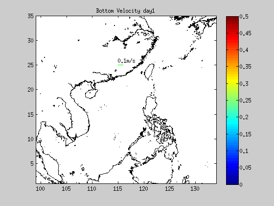

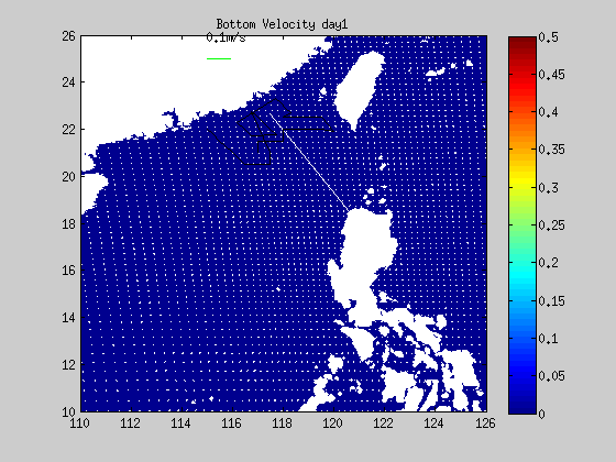

Thank you for your reply.I make a gif of daily averaged velocity at bottom. The currents are developing all the time and they are obviously too strong.Yes I can see negative vorticity regions along the section line which cause upwelling,your notice is helpful!
I think the bottom velocity due to PGE is still too big (say >0.2m/s) and I have to decrease it more.BTW one thing I haven't made it clear yet is the "stuff" that goes with PGE as you mentioned at viewtopic.php?f=14&t=2841&p=10698&hilit ... rx1#p10698.
1.Is it means wave reflection,or momentum diffusion term? :?:
2.Can I set TNU2 == 0 and VISC2 ==0 to minimize momentum diffusion term if it is the "stuff"?
