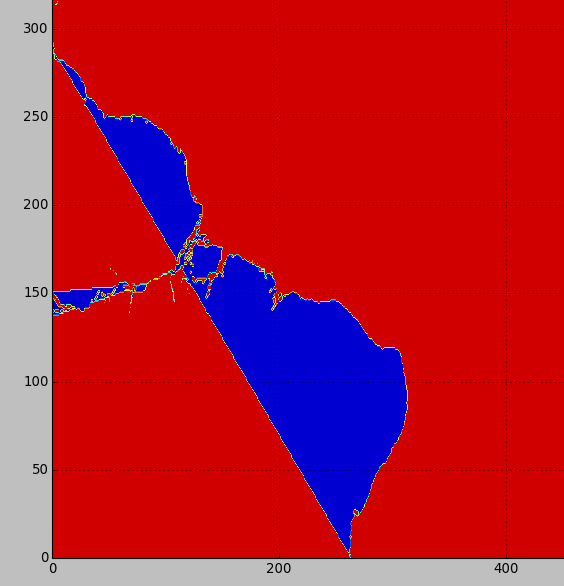

After, I set the resolution of my ocean_grd I used to use the following code:
# Grid dimension
Mm=len(lats1) #latitude
Lm=len(lons1) #Longitude
lon0=lons1.min() ; lat0 =lats1.max()
lon1=lons1.min() ; lat1 =lats1.min()
lon2 =lons1.max() ; lat2 =lats1.min()
lon3 =lons1.max() ; lat3 =lats1.max()
map = Basemap(projection='merc', llcrnrlon=lons1.min(), llcrnrlat=lats1.min(),urcrnrlon=lons1.max(), urcrnrlat=lats1.max(), resolution='f')
lonp = np.array([lon0, lon1, lon2, lon3])
latp = np.array([lat0, lat1, lat2, lat3])
beta = np.array([1., 1., 1., 1.])
hgrd = pyroms.grid.Gridgen(lonp, latp, beta, (Mm,Lm),proj=map)
lonv, latv = map(hgrd.x_vert, hgrd.y_vert, inverse=True)
hgrd = pyroms.grid.CGrid_geo(lonv, latv, map)
for verts in map.coastsegs:
hgrd.mask_polygon(verts)
coast = pyroms.utility.get_coast_from_map(map)
pyroms.grid.edit_mask_mesh_ij(hgrd, coast=coast)

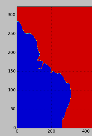

# Grid dimension
mask_rho=np.where(bath1[:-1,:-1]>-0.1,0.,hgrd.mask_rho)
mask_rho=np.where(bath1[:-1,:-1]<-0.1,1.,mask_rho)
hgrd.mask_rho=mask_rho
bath1 is the bathymetry already interpolated using the resolution of my domain, bath1 is bigger than the mask_rho so I adjusted that.
It saved me some time otherwise I'd have either make some loops to mask the land or click with the pyroms.grid.edit_mask_mesh_ij command.

- This is the result using the command that we added
- b.png (9.8 KiB) Viewed 7674 times
- This is for the first code
- a.png (19.14 KiB) Viewed 7674 times
