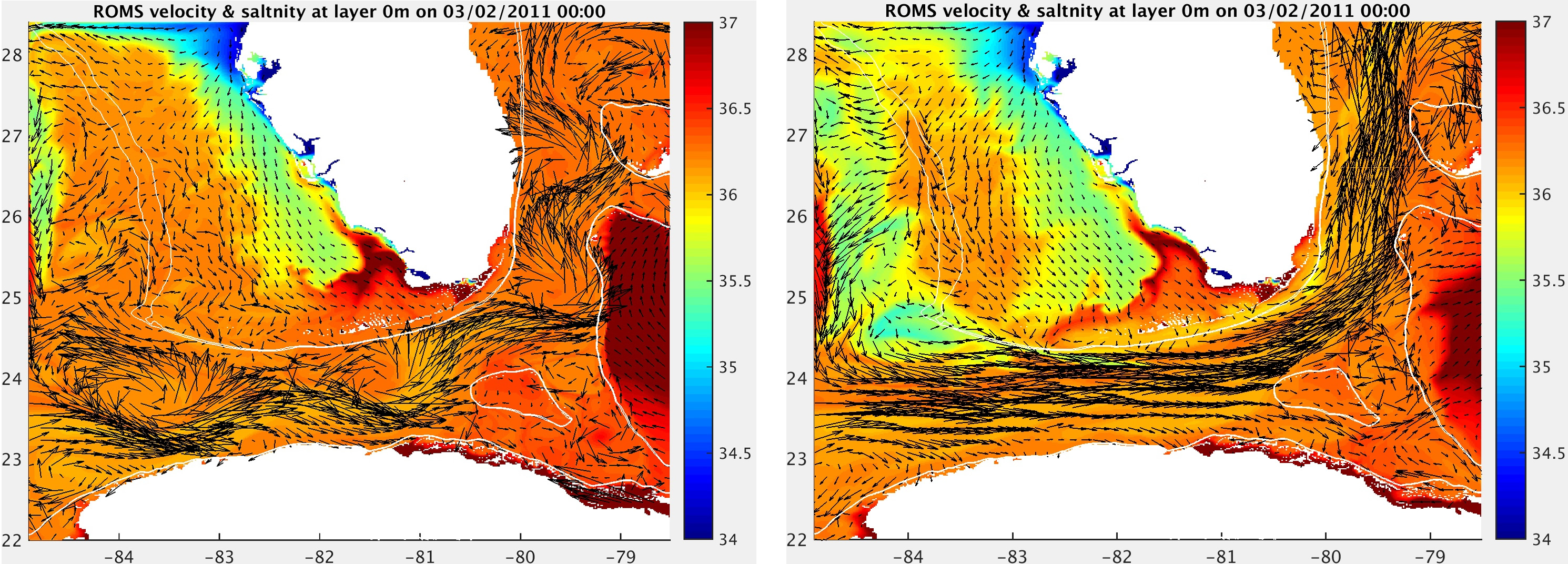

I am trying to add tide into my model, but I just cannot get it to work reasonably. Maybe I didn’t do it right. Hopefully I can get some tips here.
The model domain covers the southern West Florida Shelf and the Florida Straits. The model runs from 2011-2012. The open boundary values are provided by Gulf of Mexico HYCOM. Surface forcing are from NARR. The open boundary conditions are as figure 1. tide start date are as figure 2. And the CPP keys are as following:

Without tide, the model runs fine (figure 3 right panel). Then I used the TPXO2ROMS_v4pt0 package (developed by johnluick in this thread: viewtopic.php?f=23&t=2482) to generate tidal forcing file from TPXO8 for my model domain. The tide reference time is 01/01/2011. I have compared several tidal constituents’ Eamp, Ephase, tidal eclipses and tidal currents (generated from this package) with literatures, all seem ok. However, when I applied the tidal file to the model domain, the model runs but the Florida Current quickly (in about 3 weeks) broke into several big eddies in the Florida Straits, which is quite problematic (see the following figure left panel).
I have tried two other tidal packages (Rutgers otps2frc_v4 package with TPXO7.2 and ROMS Agrif package with TPXO7.0). The results are similar to those using TPXO2ROMS_v4pt0 package. I am not sure where have I done wrong. Can anybody help me out, please?

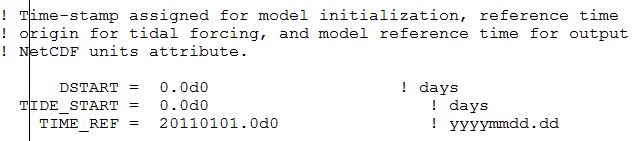

Hope that helps. By the way, in that TPXO2ROMS matlab script, I suggest a certain choice of TIME_REF, DSTART, and TIDE_START. What you are doing with them may be fine, but if you still have problems, you might follow those suggestions.

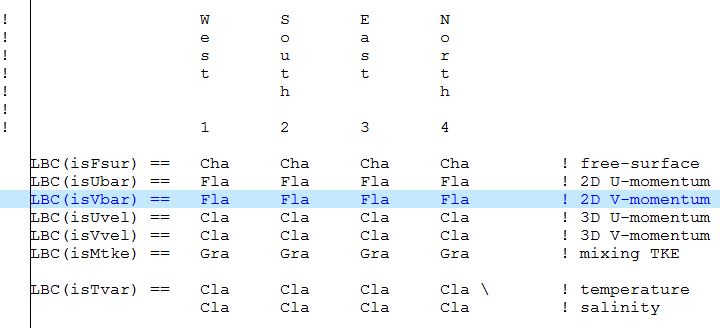

In the FAQ https://www.myroms.org/wiki/Frequently_ ... ndaries.3F note point (3):
I notice you have clamped 3D velocity, which is somewhat contradictory with adding harmonic barotropic tidal velocity - because you are not also adding the 3-D harmonic tidal velocity.
You will probably find that a simple radiation (or even gradient) condition on 3-D velocity works better.
... if you #define ADD_FSOBC and #define ADD_M2OBC.You can specify other 2-d currents and surface elevation signals as coming in, plus have tides
