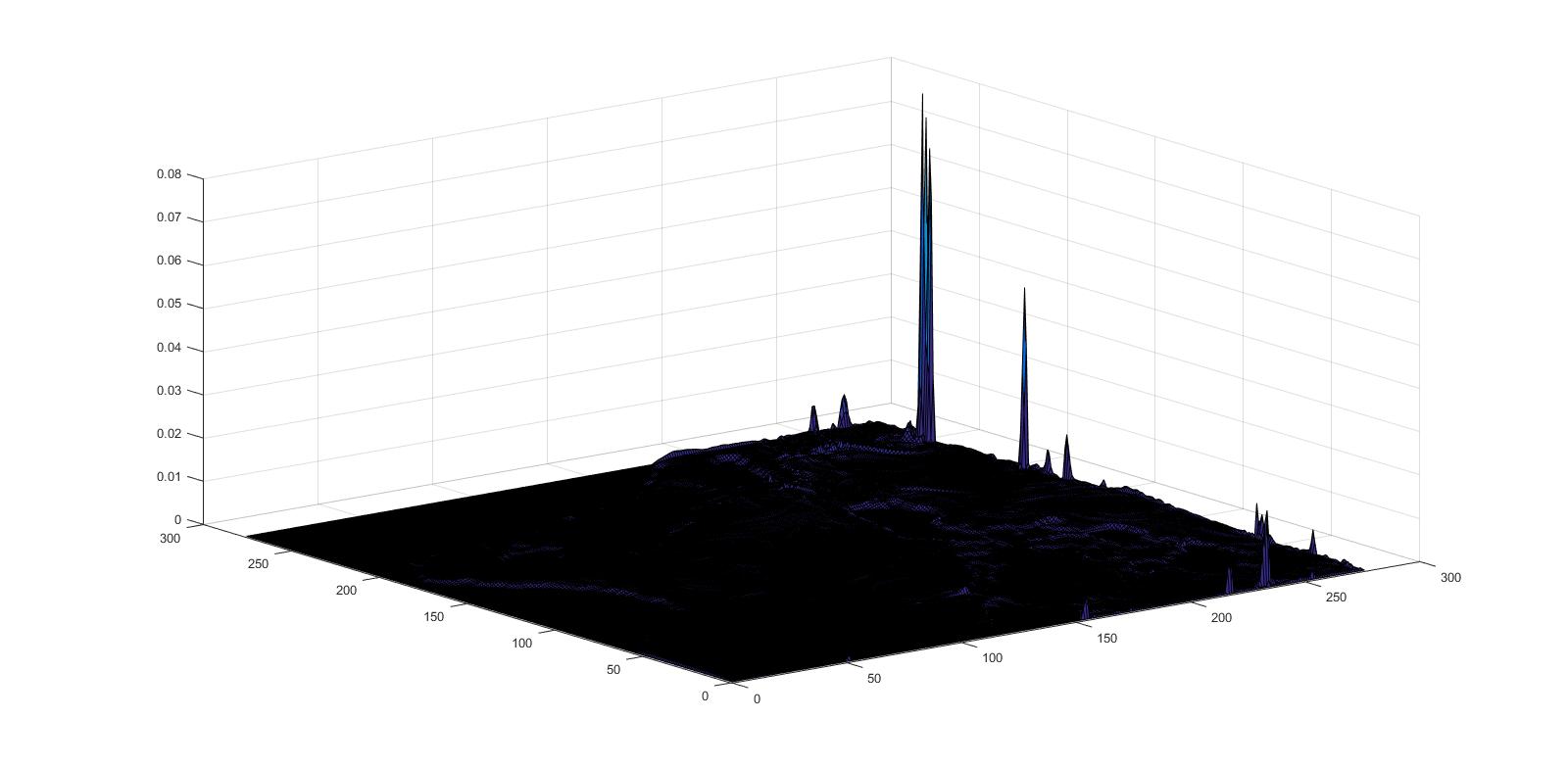

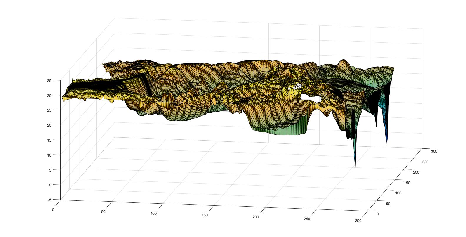

kate wrote:Visualize your restart file. In this business, you need to build some debugging skills of your own.
Hello! I have a problem when run a spinup with climatology data.
I have run 855 days without error but blowup suddenly. I see the restart file,it has 11 variables 'zeta' 'u' 'v' 'ubar' 'vbar' 'temp' 'salt' 'rho' 'akv' 'akt' 'aks',and I found that there is a abnormal value at right boundary with coordinate(245,276). so I correct the value with its near value. But I just have corrected 9 variables without 'Akt''Akv''Aks',because I don't know how to correct them. And after I correct 9 variable of the restart file. I try to run with restart mode, but failed. What should I do ?
Next is the output

figure 2 is the leve 30 of 'Akv',its abnormal value don't at (245,276)
figure 1 is the level 30 of temp ,I can find that there is a low temperature domain at right boundary.
That's not quite how it works. If the temperature is going bad at the edge, you need to think about what is happening in the model at the edge. You can't just correct it in the restart file because if the model wants to go to zero T, it will still do that when you start timestepping again.
As for Akt and friends, they are generated from the other model fields internally. They are allowed to be spiky like that, with large values where things should mix vertically.
zeta 1 Chapman Imp Chapman Imp Chapman Imp Chapman Imp
ubar 1 Flather Flather Flather Flather
vbar 1 Flather Flather Flather Flather
u 1 Radiation Radiation Radiation Radiation
v 1 Radiation Radiation Radiation Radiation
temp 1 Clamped Clamped Clamped Clamped
salt 1 Clamped Clamped Clamped Clamped
You are clamping to monthly climatology for T and S? I prefer RadNud from something like daily HYCOM fields. Same for u,v.
sorry applying so late.I run successful with your suggestion.Thank you very much.
