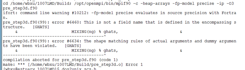

After I using the LMD_MIXING instead of GLS_MIXING in the .h file and inputting "./build.sh" ,here comes the problem which terminate the building order.I upload the error in the attachment.
Any suggestions are welcome!
Thanks!
Re: about build.sh

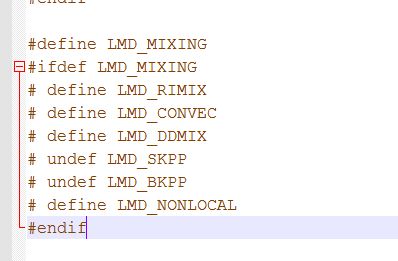

If you look at mod_mixing.F, ghats is defined if either LMD_SKPP or LMD_BKPP are defined. It is also inside #ifdef LMD_NONLOCAL. I expect the latter doesn't make sense without the former. So, try #define LMD_SKPP.

kate wrote:If you look at mod_mixing.F, ghats is defined if either LMD_SKPP or LMD_BKPP are defined. It is also inside #ifdef LMD_NONLOCAL. I expect the latter doesn't make sense without the former. So, try #define LMD_SKPP.
If I define LMD_SKPP,the output.dat will remind me that there is no swrad in my forcing.nc file.And I don't want to add the short wave radiation.Can I define another Cpp to replace LMD_SKPP?
