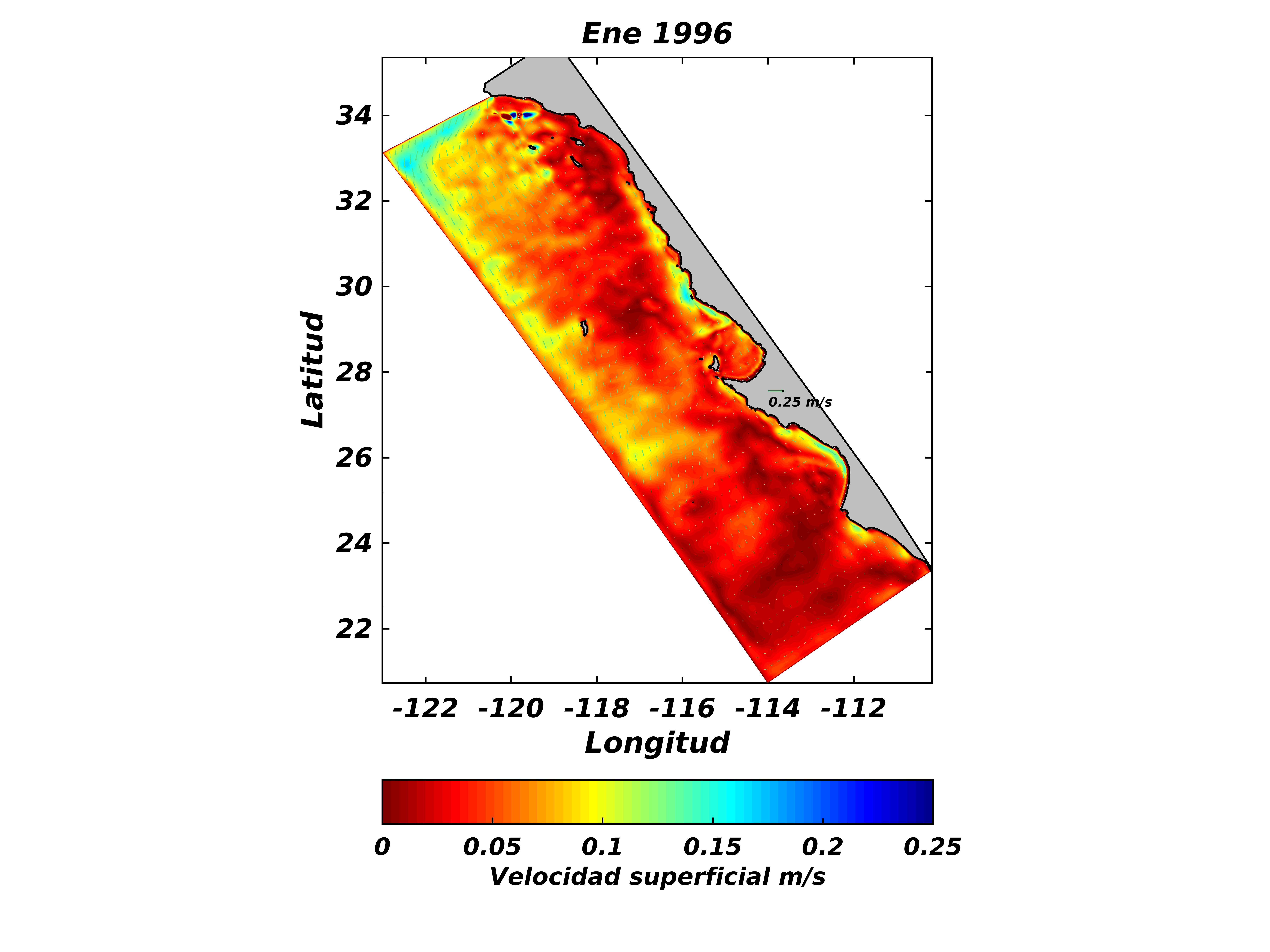

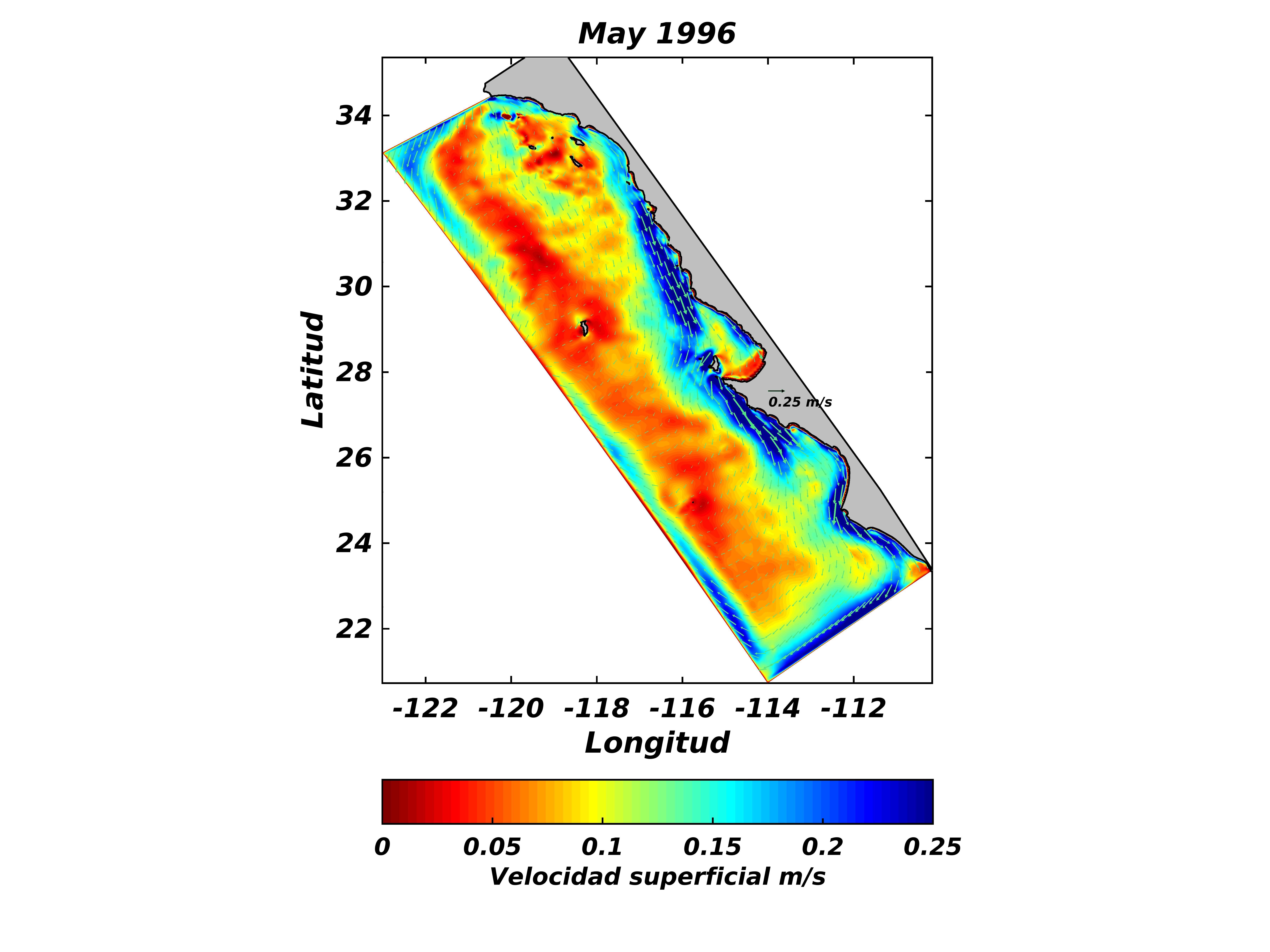

I have got some results from my modeling in the California Current, but as you may see (attached figures are monthly mean surface velocities for january and may 1996), I still have some problems with my north, south & west boundaries, so i'm looking for help in order to reduce this problems and get more involved about how to set an sponge layer or boundary.
I attach also my *.in & *.h files
Thanks in advance & have a nice day

I see that you are using clamped boundaries. What is it that you are clamping to? Is it such a good match that you don't want your model to have wiggle room? I have been using the RadNud boundary condition since it came out with timescales somewhat similar to your TNUDG and OBCFAC values. You would have to change M3NUDG and so forth from zero if you switch to RadNud.
A sponge layer is a band of increased horizontal friction and diffusivity. It's not obvious that it would improve your solution.
