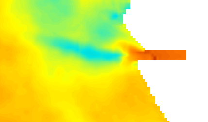

I am running a high resolution application over the Congo/Angola region (3 km resolution) and upon running for a year I have noticed some cool SST's over a certain region in my domain.
Specifically this region seems to be linked to the submarine canyon off the Congo river mouth. I have done a little reading and I now understand that it is possible that these canyon regions (when located off the continental shelf) are prone to enhanced up-welling and thus cooler SSTs temperatures however I am not sure the effect should be so noticeable (cooling of around 1K).
In my 5 km resolution model this effect is not present, leaving me to believe that the increased resolution is resolving the flow around the canyon more.
That is the SST cooling effect,
2014-11-27 13_57_46-regular include inferior.png (35.21 KiB) Viewed 14223 times
and there's the bathymirty.
Currently I have only been looking at 25km resolution observations but even when switching to 6km observations of SSTs this effect is still not present for the 20km wide canyon.
Anyone have any thoughts what could be going wrong? or is this actually realistic?

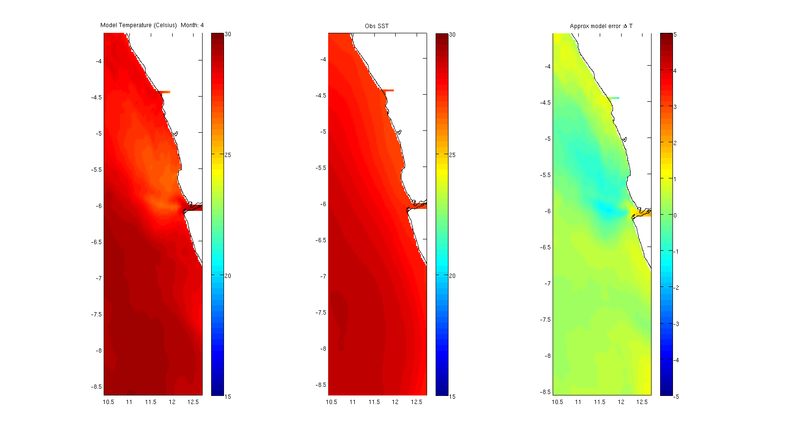

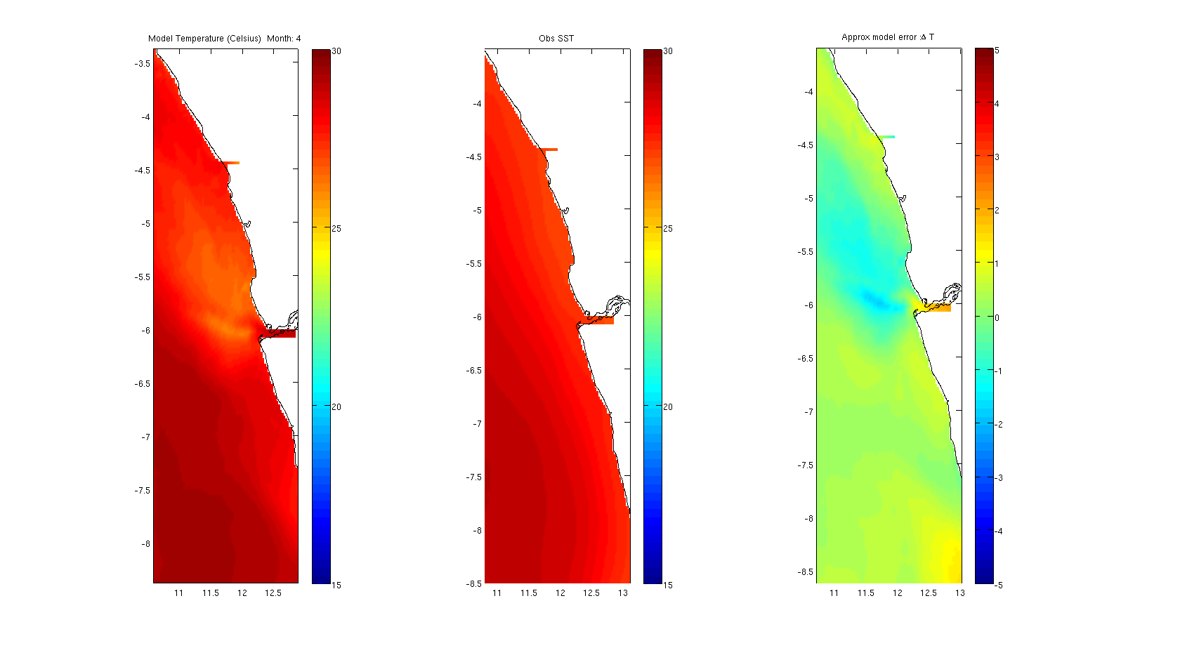

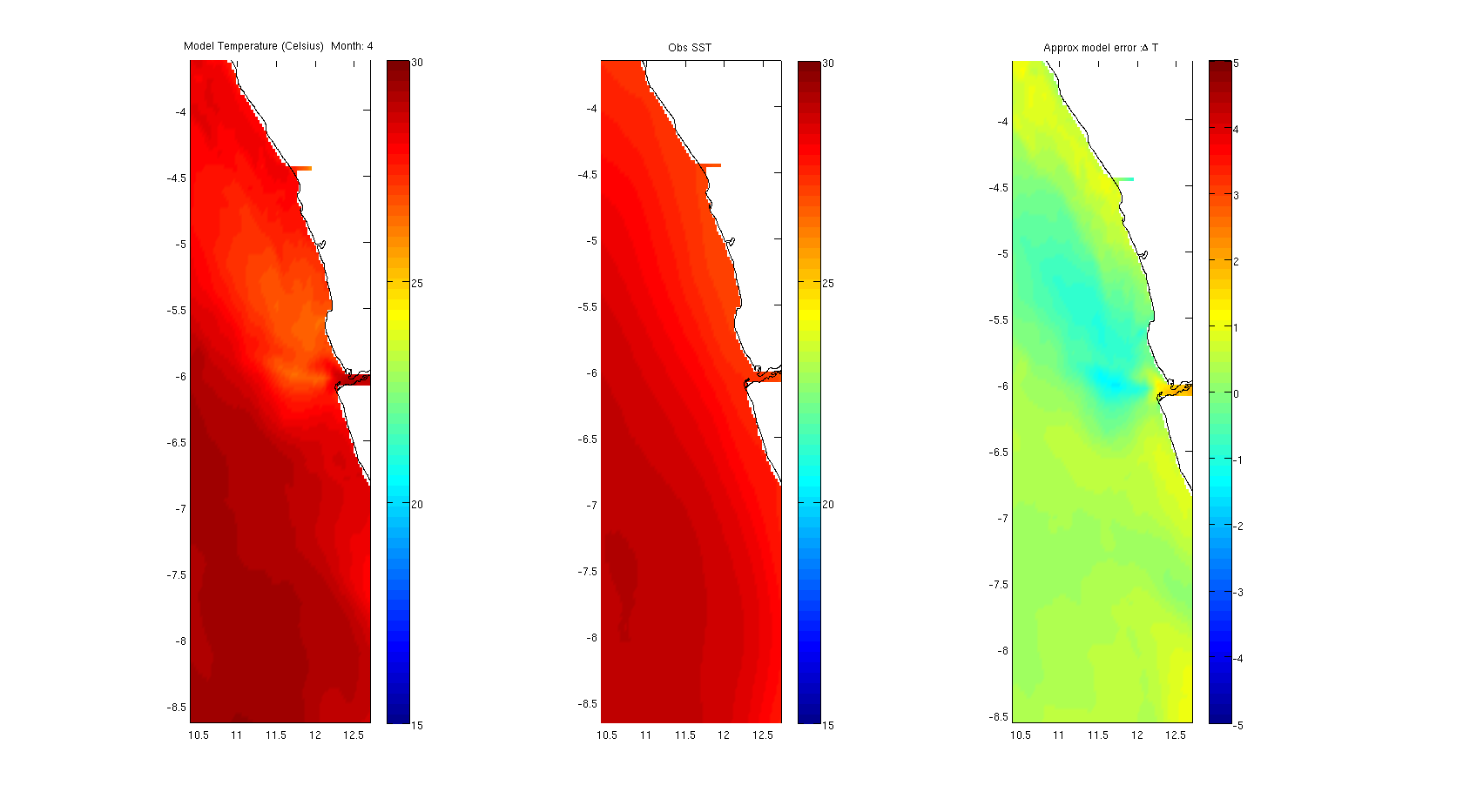

Quick update on my last post, so changing to TS_MPDATA and TS_U3ADV_SPLIT made the model blowup, TS_A4VADVECTION however seemed to perform much better than TS_C4VADVECTION (my original setting).
Here you can see the improvement where there is less cooling over the canyon as compared to using C4VADECTION in Figure 2.
FIGURE 1
FIGURE 2
I wonder how I can improve this further or do you think I have reached my model's limit with this bathymetry? Would changing the stretching help?
