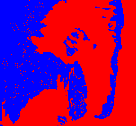

I have a grid where most of the land is unmasked. After switching to COAWST version 3.1 I started getting spurious wet cells right after a few steps in to the simulation. They are spurious because the cells that get wet have elevations much higher than the tidal amplitude (e.g. -3 m of elevation getting wet with 0.5 m water surface level). Digging into the code I found that a piece of code that applied wet-dry mask to the right hand side momentum equations was missing in the newer version. After I changed it things looked much better. I had this issue with COAWST, however, it looks like Rutgers trunk is missing the same block of code in rev741, too. I have just looked at the cod on Trac, I did not test it. I wonder if anybody else has had a similar issue (either with ROMS or COAWST). I'd happy to listen and learn from their experiences...
