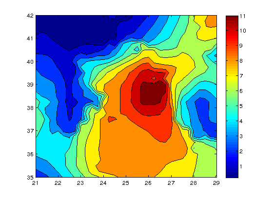

Greetings,
Lanerolle thanks for your advise, I'll check H+zeta and I'll make a new grid
with different hmin. Kate i don't have any problem viewing my wind file with
ncview (i'll attach a figure). The minimum value for all records is -20.12764 m/s
the maximum 18.314148 m/s and for the last record min is 0.22686242 m/s and max
11.466743 m/s. Thanks both of you again.
Giannis
