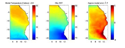

I am seeking to eventually apply weak constraint R4D-Var or 4D-PSAS to my model and am wondering about the type of model error that can be incorporated.
Currently my model has a significant systematic error in temperature at a specific location in the domain (around +5K) for most months throughout the year.
Jan/Aug/Sept Average Temp: Model, Obs, Difference

To my understanding from the ROMS 4DVAR tutorials, the ROMS weak constraint formulation has model-error forcing η as the control variable (thus random error)?
So is this formulation 'implicitly attributing the model error entirely to a stochastic (Gaussian) noise' (Ning, et al 2014)? And if so will my inclusion of model basis performed in a similar way to the tutorials i.e 'as a first attempt, a prior model error covariance
Q = Kb W Σ C W(T) Σ (T) Kb(T) is assumed' be acceptable practice?
Does the weak constraint R4D-Var or 4D-PSAS have a way of accounting for both random model error and model bias?
