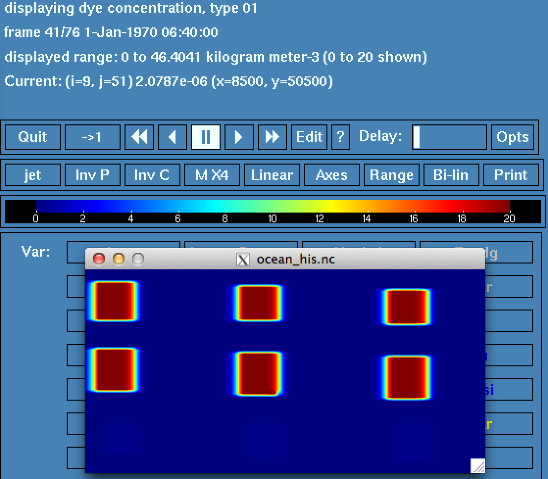

Then when I checked the model output, I saw 6 tracer areas (and 3 more near the southern boundary) not 1 (see attached figure). I wonder what I did wrong.

did you tile it 3x2?
try tile it 1x1 and use 1 processor. the way you specified the point sources are not correct for a tiled application.

Indeed, you need something more like this:
          DO j=MAX(JstrT,20),MIN(JendT,30)
            DO i=MAX(IstrT,40),MIN(IendT,50)

tile!? :shock: my bad. Why didn't I think of that...
Yes. the single core run worked and so did the modification that Kate mentioned for multiple core run. Thanks a lot.

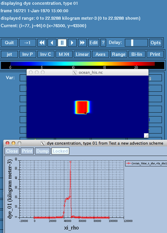

When I re-ran my analytical model, I saw abnormally high concentration at the bottom right corner of the tracer area as shown in the attached figure (for both horizontal snapshot and cross-section for xi direction). The initial dye concentration is 20 kg/m3 and the concentration of the area is around 60 kg/m3, which does not make sense to me. I used TS_MPDATA for this run, but the 3rd order upstream scheme (TS_U3HADVECTION) gave a similar result. I am puzzled by this. I wonder why. :?
Any comments would be appreciated.
Thanks in advance.
DJ

It may be significant that you commented out the initialization of the second time level.
!              t(i,j,k,2,itrc)=t(i,j,k,1,itrc)
Try restoring that step.
