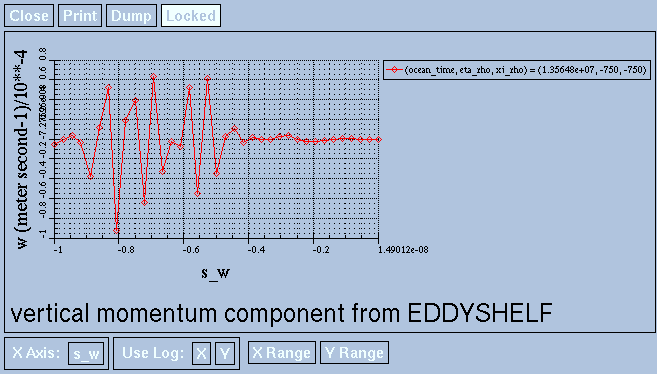

Vertical profile of vertical velocity at a point where the trouble is very apparent.
vertical profile of w.png (11.97 KiB) Viewed 4919 times

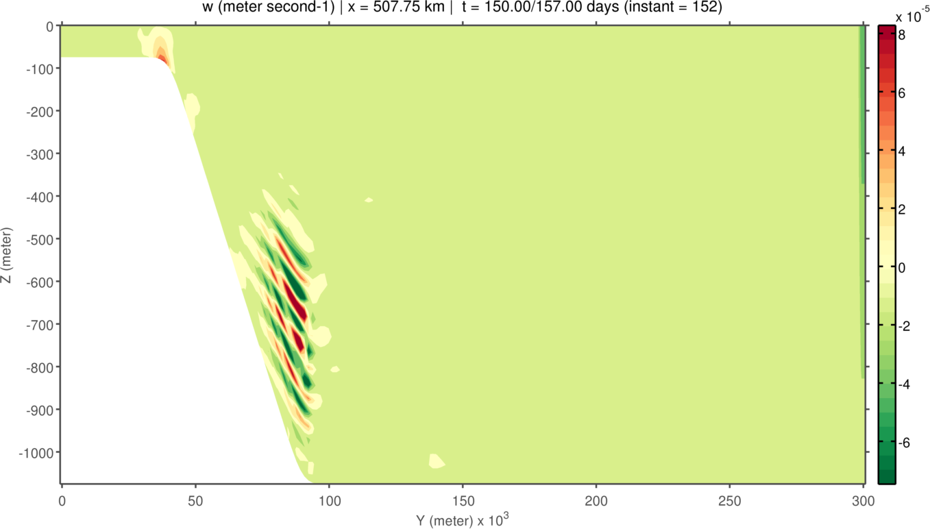

Cross-isobath section of vertical velocity
