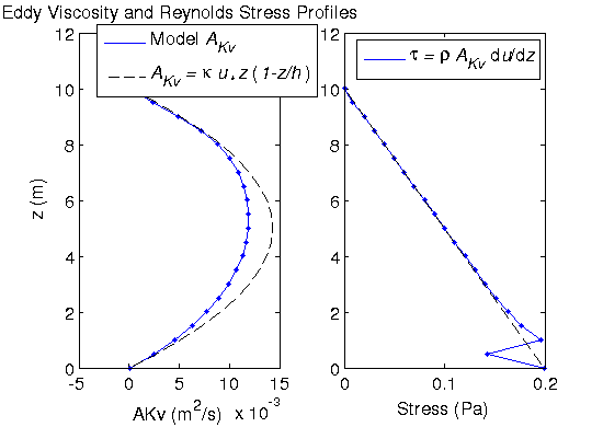

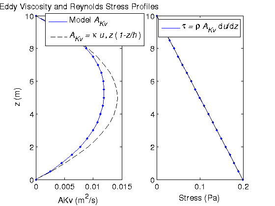

Here is a plot of the eddy viscosity profile (modeled with GLS) and the stress profile, looking as they should.
Here is what they look like with splines on:
