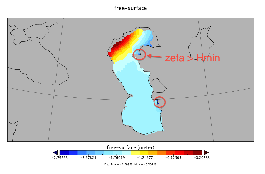

No, i did not activated WET_DRY is this case but i'll plan to activate it in the production run. This could be also effect of the storm surge but i am not sure. i could change the code to write the zeta value in this cell. it might be a negative value greater than the cell depth. According to my previous runs, the zeta oscillates too much in a small time scale over the northern Caspian Sea but i have no idea about that. it might not be realistic.
Update 1:
i modified that part of the code to write the zeta values (OCEAN(ng)%zeta(i,j,:), all three of them),
trouble in ice_frazil 56 34 -2.303653101454643E-003
3.451582526012355E-004 -1.719989149099419E-009 2.670898819416213E-005
-1.643950240595160E-004 -3.01092344094394 -3.01088860733177
-3.01092344092898
the zeta values goes more than -3 meter and this triggers the ice_frazil check.

if i enable WET_DRY then model works without any problem and it passes that point but it gave " DIAG speed trouble 38.7647803685003" error in 173th day of simulation.
Re: tuning ice model ...
#9 Unread post by kate »
I'm glad the WET_DRY worked for you. Moving on, we have insufficient information to help with the extreme velocities.
