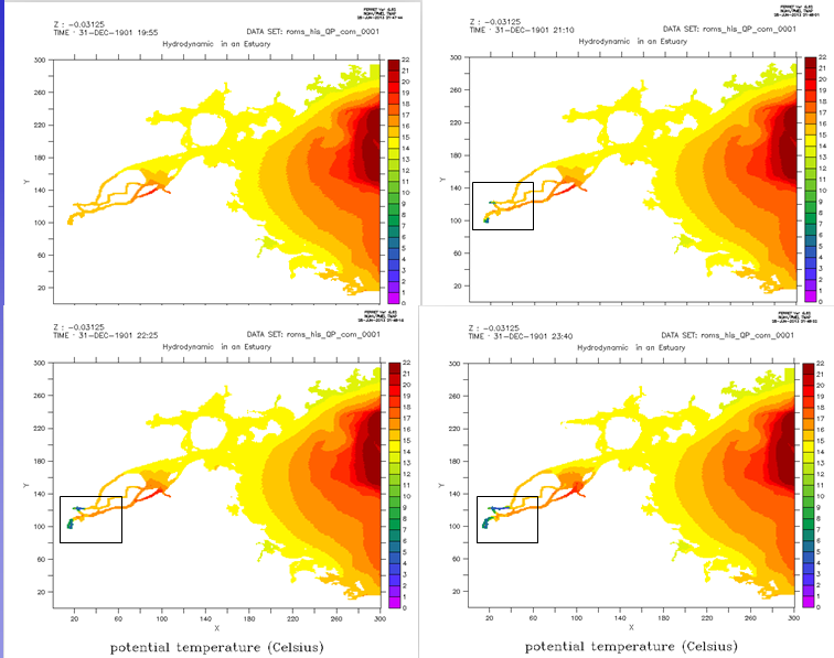

Below is my CPP options when i used roms570 ,only eastern boundary is opened,min depth is 0.3 m,DT=25,NDTFAST=10,16 levels,rx0 =2.329628E-01,rx1 =5.861046E+00,added 2 rivers in my case,choose TS_PSOURCE & Q_PSOURCE for Point sources,as i used WET_DRY,and the low tide in the region is about -3.5m,so i set the min depth of the river channel to 5,the river_temp in the river file is 18℃.
But when i checked the output file, low temp water keeps flowing out from the point where i put the river point sources.
Like the figure shows.

- final.png (150.73 KiB) Viewed 4189 times

Have you tried UV_PSOURCE instead of the Q_PSOURCE? That's what I would do. I know that way you are fluxing water of a given temperature/salinity into the cell from a lateral boundary.

The temp goes well when i used UV_PSOURCE.
i am wondering if there is something wrong with the Q_PSOURCE option,when i output the temp step by step, the temp of the point where i put the river point sources goes down from the initial temp slowly.
