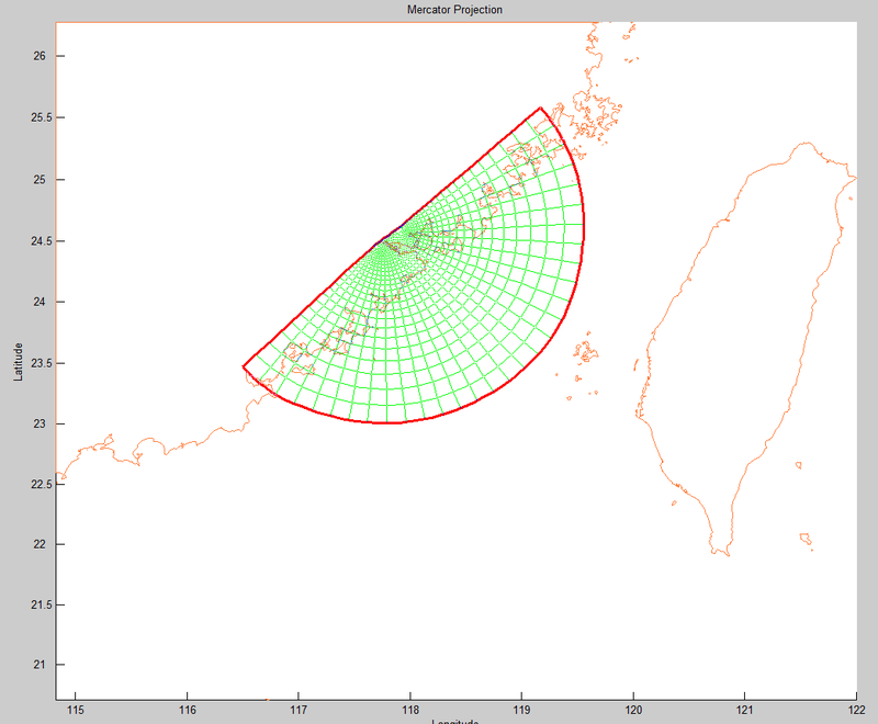

Attachment is the grid.

Well, your choice for a grid is horrible
I would never set-up and run a grid like that. What you were thinking?

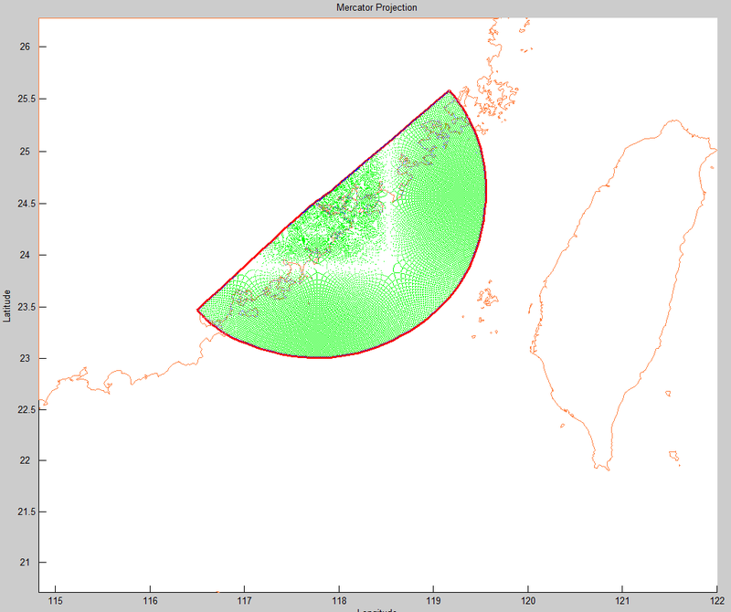

Re: What to do to keep my ROMS case from blowing up??
thank you arango.
I'm sorry.
the grid resolution of the figure i show before is 30*30.
Actually when i run the case the grid resolution is 300*300.
when i run the model as min depth is 5 m ,it won't blowing up.
I'm sorry.
It is not related to the grid resolution. To be frank, this grid againsted the basic law of ROMS, and it was wrong!
Before you run the model, I suggest you find a book (e.g. Dale's book) or read the user manual provided by the wikiROMS, instead of taking the model as a black box and throw all those strange things in.
There are huge amount of papers which adapted ROMS to study the coastal and estuarine areas for your reference.

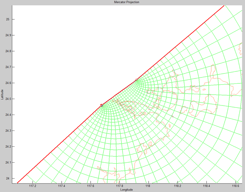

There aren't really any laws against it, but you will need to satisfy the CFL constraints on the very smallest grid cells. Waves running from the small grid outward could go from being well-resolved to poorly-resolved to unresolved. What happens to them? Possibilities include reflection, damping, aliasing.
Hi there,
Yes, everyone gets the liberty to organize their own study, and I'm not trying to offense you personally. In fact, although it may take a lot of effort to generate this grid, I'm not quite sure about the orthogonality, which is critically essential as one of the basic law of ROMS.
You squeezed the grids along one (maybe western) boundary into, almost, one point at head of the river. You may want to extensively increase the horizontal resolution there, but, could you please demonstrate the orthogonality of this grid?
Happy modelling,
ZQ
Happy modelling,
ZQ

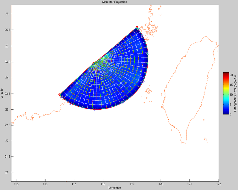

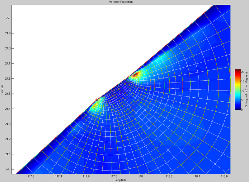

Attachments is the orthogonality of this grid.
Hi liuy,
Looks like you want to hide those corners with extremely large orthogonality error in the land points, but even though, the orthogonality error in the areas you interested in is still too large (~5 degree) to be acceptable.
I suggest you start from a linear grid with gradually relaxiation of the grid resolution from the inshore areas to the open ocean, or if you insist, you can adapt a grid with the western boundary varies a little bit along the Fujian coast and keep the northern, southern and eastern boundaries connecting to the open ocean.
Reduce the orthogonality error into at least 1 degree and the smaller the better.
For the orthogonality, you could help it out by moving your shortest side inland and curving it, so that your whole domain is like a sector of a donut.

thanks orango, the open boundary, grid topology are what we shall consider at the grid generation, maybe we care too much about the solution at the western inner bay, which we are focusing.
we can try a nested version in next step after solving the overflow problem caused by the dry and wet processes. Thanks again.
look forward the couple-nested version of ROMS, i know you are working hard on it, thanks very much.
